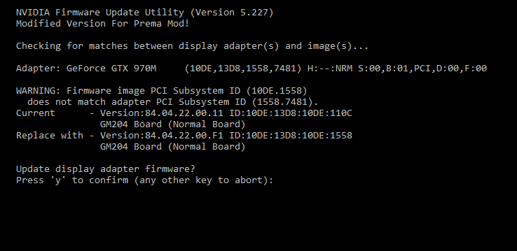

  7. Hi, I am just about to flash my GTX 970M with premas vbios mod, when i run modme.bat i get the the message displayed in attached image: Firmware image PCI Subsytem ID (10DE.1558) does not match adapter PCI Subsytem ID (1558.7481). Should i go ahead or is this going the brick the card?
