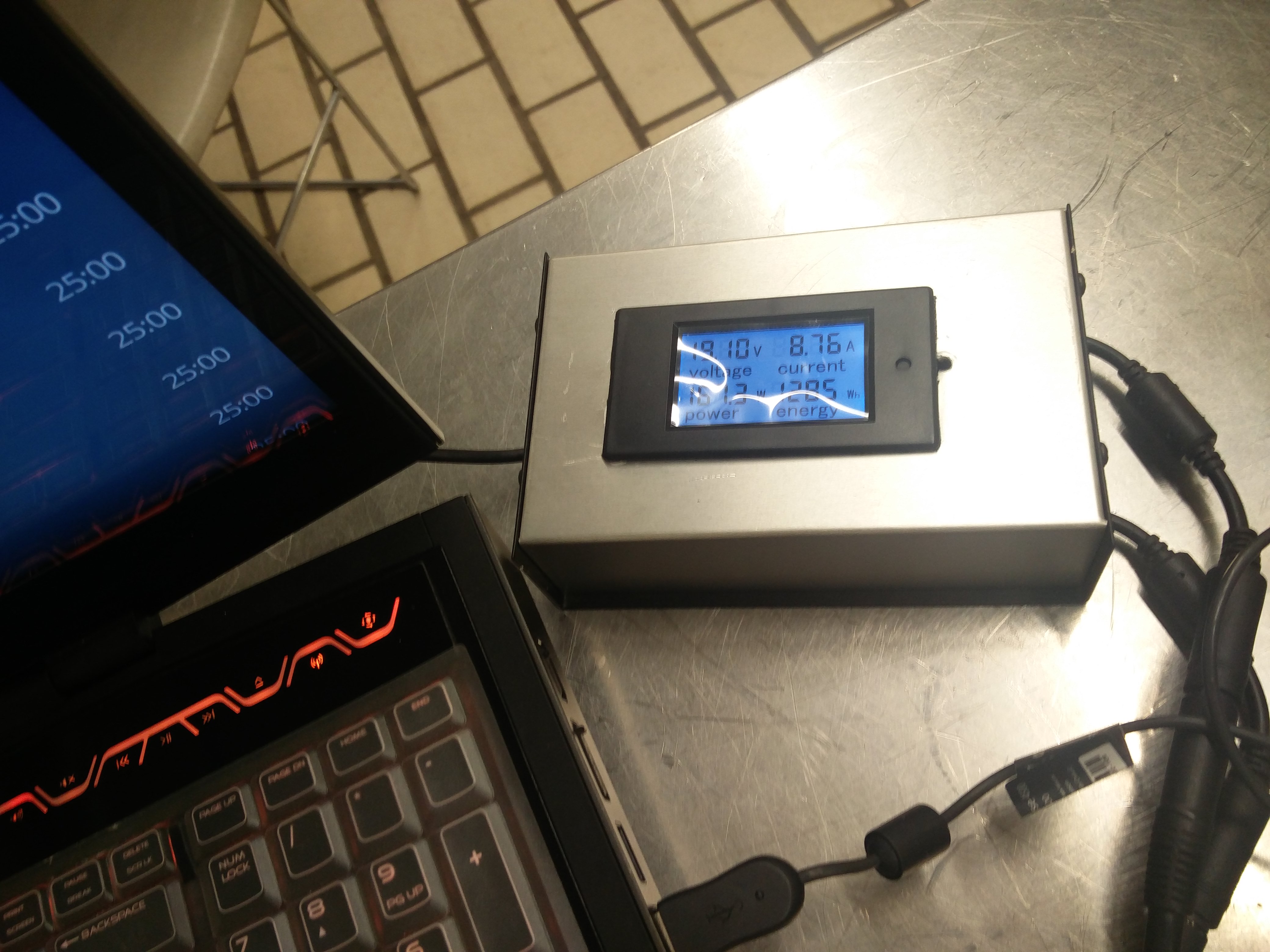

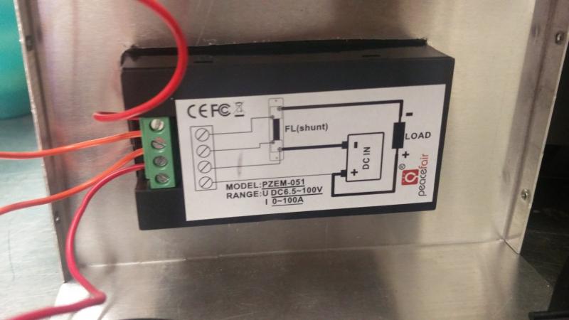

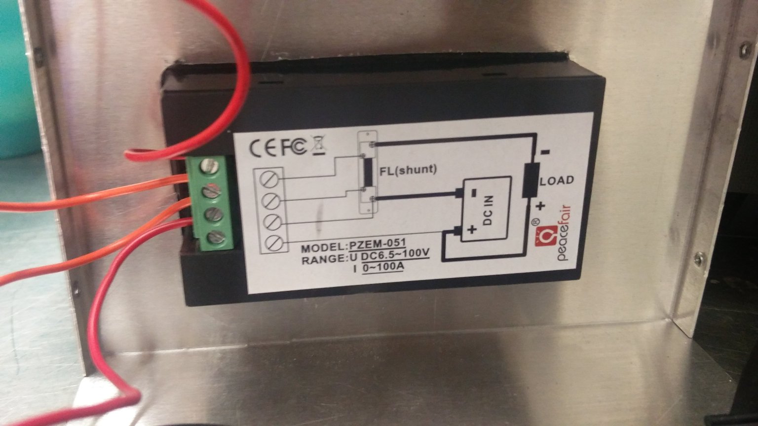

I installed this display to see what exactly is going on. It is wired after the diodes so it measures voltage, Amperage and wattage that the laptop receives, regardless the efficiency.

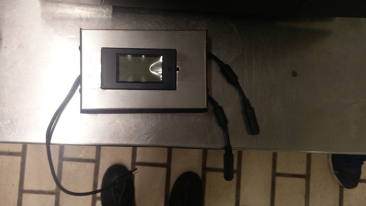

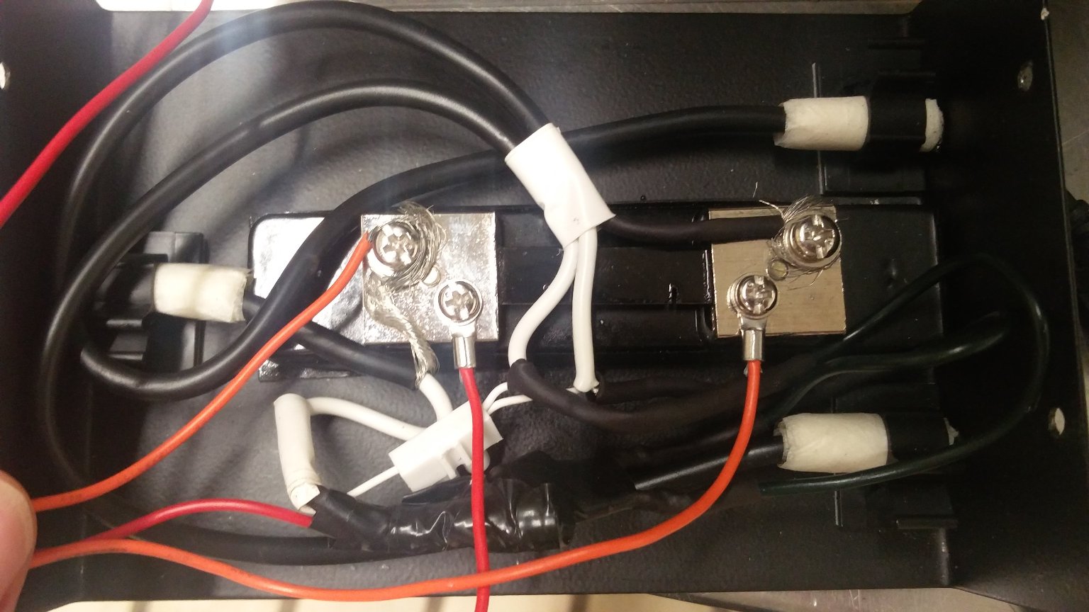

Here are some photos of my setup. I also have two psus. One is the official Dell with the other is a chineese clone. I also have the above part numbers and I am using only two.

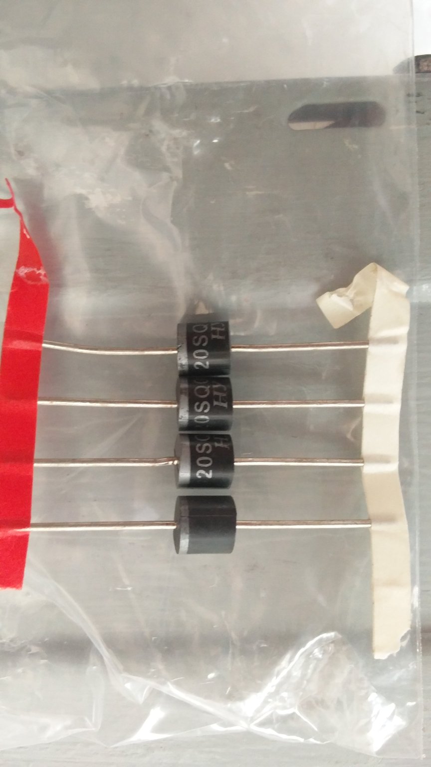

Take a look at the diodes I have used. I also never cut the original wires. I sourced some PSU extension cords and slice them for my needs. I am afraid to cut down PSU cables, because the amperage is too high. My diodes have a 20 amp tolerance and no forward voltage drop, so without powering up the laptop, I have a 19,44V and on extreme load (ex. benchmarking) I may drop to 18,64V. As you can see, the power delivered to the laptop is 544watss!
My display is connected to the output area, so the numbers I am getting, are those reaching the laptop.

I suppose this one might do. I haven't taken any photos of mine. I can find my own diodes and sent a picture to you. I might have some to spare.

Nice setup there! My only concern is that blue and white are your positive current and brown is your negative current? I would suggest adding one more cable to each connector to your negative side, just in case.
Two wires for positive current, two wires for negative current. After all, 20amps are quite a lot.

My thoughts for not working properly, are directed to your bridge. Perhaps a higher voltage/Amperage might help. I told you I used simple 20amp diodes used in photovoltaic systems. Positive cables have the diodes and then they are connected.

I used two high amp diodes (20A) for the positive voltage cables (white in my occasion). Negative cables were soldered together (black ones). Also the psu signal ones (blue ones).
Don't use anything else than solder. High amps don't like twisting or any other loose connection.

I placed my display AFTER the connections, so I have readings for the voltage getting to the laptop, Amperage and wattage.
With the diodes, voltage drops to 19volts under heavy load, Amperage is around 34amps and wattage never exceeds 600watts.

I finalize my dual psu. My design has only two 30amp diodes and modular design to connect one or two PSUs. I can add simply a third PSU anytime! I did use initialy a rectifier bridge, but the forward voltage was high, so the output voltage was too low (18,2 volts) so the laptop under full load, it tripped.
My design also has a display and a shunt. It shows me output voltage, output amperage, total wattage and watts per hour.

Everything is soldered inside and insulated. No heat is produced, but I put it in an alouminum box anyway.
