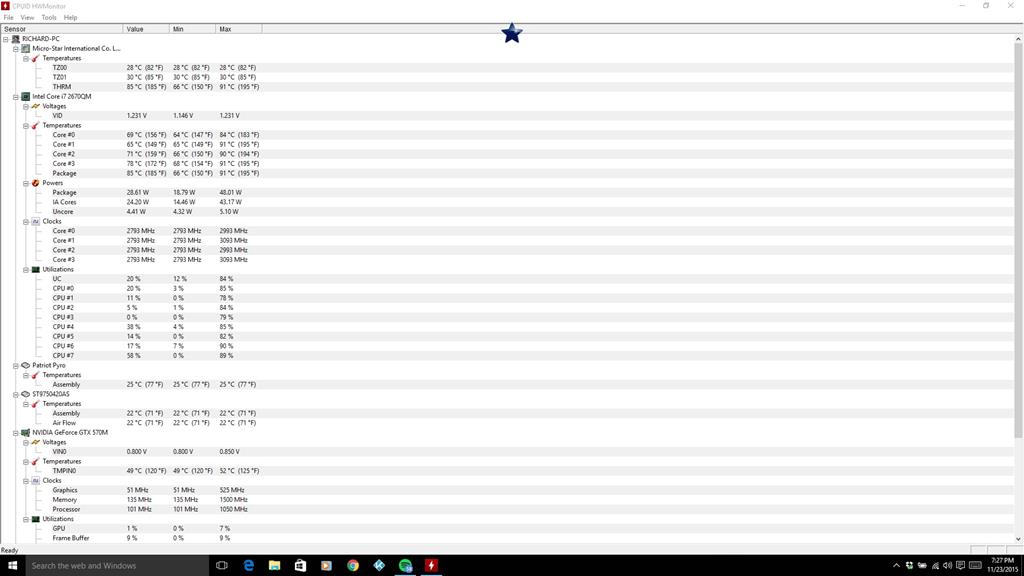

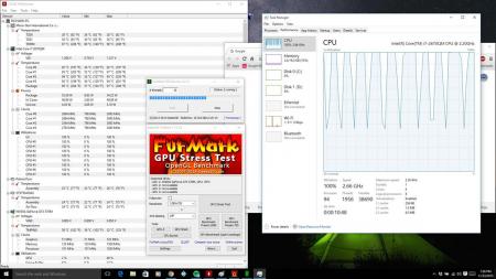

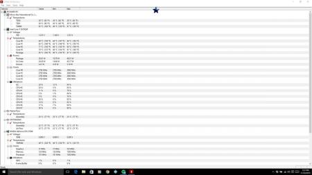

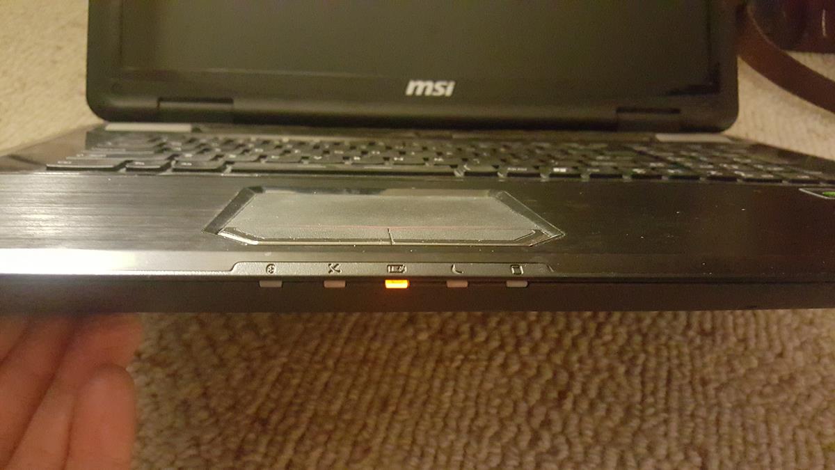

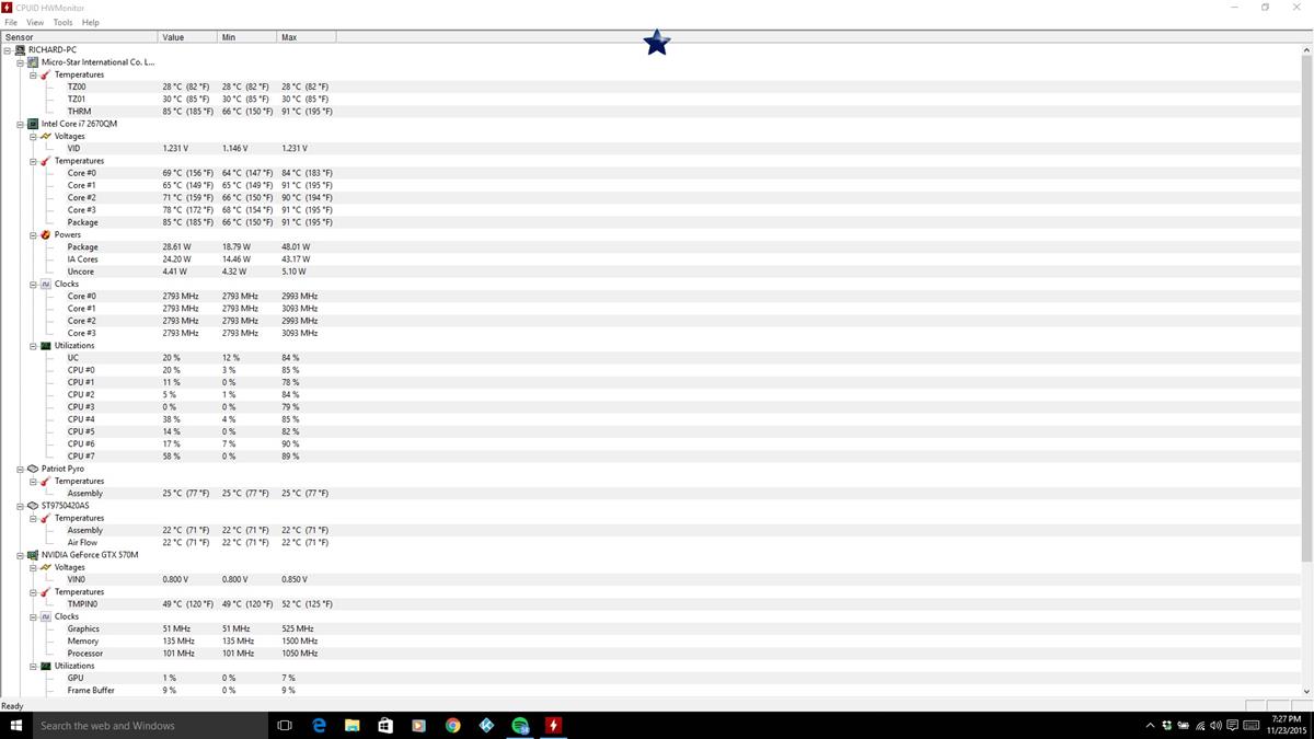

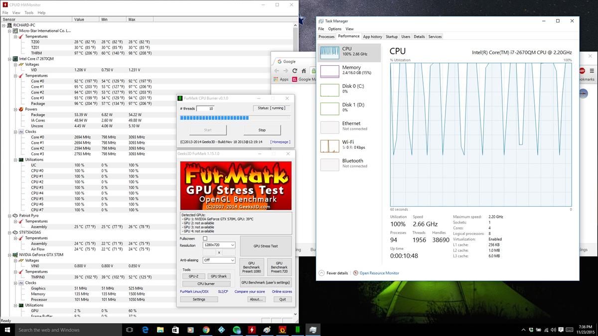

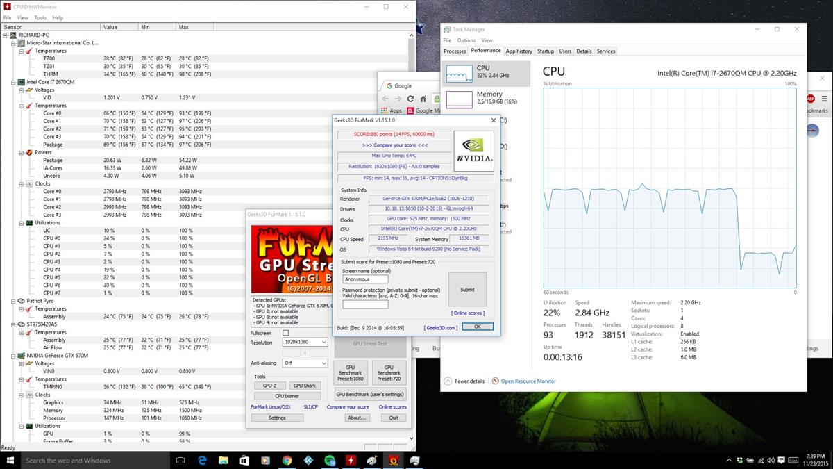

  9. Ok I tried a few things and managed to take some pics. I went back and used Furmark gpu/cpu tester for some more accurate results. What happens generally is pushing the cpu seems to run ok, and pushing the GPU works at first then eventually the system shuts off. After the first shutdown subsequent restarts happen very easily sometimes even before the login screen. After letting it sit for a while I can get things working normally under light loads. 1 screenshot shows all the temps as soon as I restarted and the other 2 show cpu/gpu testing. I tried the tests with just the battery and it seemed to be ok but I wonder if it is a thermal shutdown it may not be able to push as hard on just the battery. The lights I have on the front are a bit different I have BT,Wifi, battery charging, sleep, and HDD status lights. Battery light is on when plugged in with bat in and off when bat is out. Everything just goes black when it shuts down like a complete power loss and fans don't seem to spool up on restart. All the temps except the THRM seem to be ok but THRM looks like it is always very high. Physically touching all parts of the casing nothing seems abnormally hot. And thats about as much as I can seem to figure out. Im pretty stumped
  10. Ok it's interesting that you mentioned a possible power problem. I had initially thought that could be the problem and went to a computer shop and used there power supply and is did the same thing. Thst being said yesterday I tried running some games and i played all day before it shut off. Then once it shuts off it continues to do it for a while. When it first started i stressed the cou and gpu independently and the gpu test would shut the system off. Now some times the gpu test will run no problem and it seems fine then after a while the shutdowns start again. Should I just order a new power brick to rule that out? Could the problem lie in the internal power supply somehow? Thanks again
