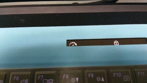

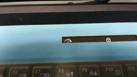

  9. Hello Prema! Are you currently intending on releasing a more updated mod for P157SMA? I have a P157SMA with i7 4700MQ and Quadro K2100M, and had flashed your BIOS. 2 Problems. The first one is that I cannot set the CPU turbo time window(in CPU overclocking, in your modded BIOS) to a value greater than 8! This value is 28 by default! The second one is that my machine has the dGPU indicater(beside the HDD/numlock/capslock indicators) always on. I monitored my machine with GPUZ and it said that my quadro K2100M is running at 135 Mhz (idle), instead of being switched off completely! Why is that? Will you update this BIOS and solve these problems?
