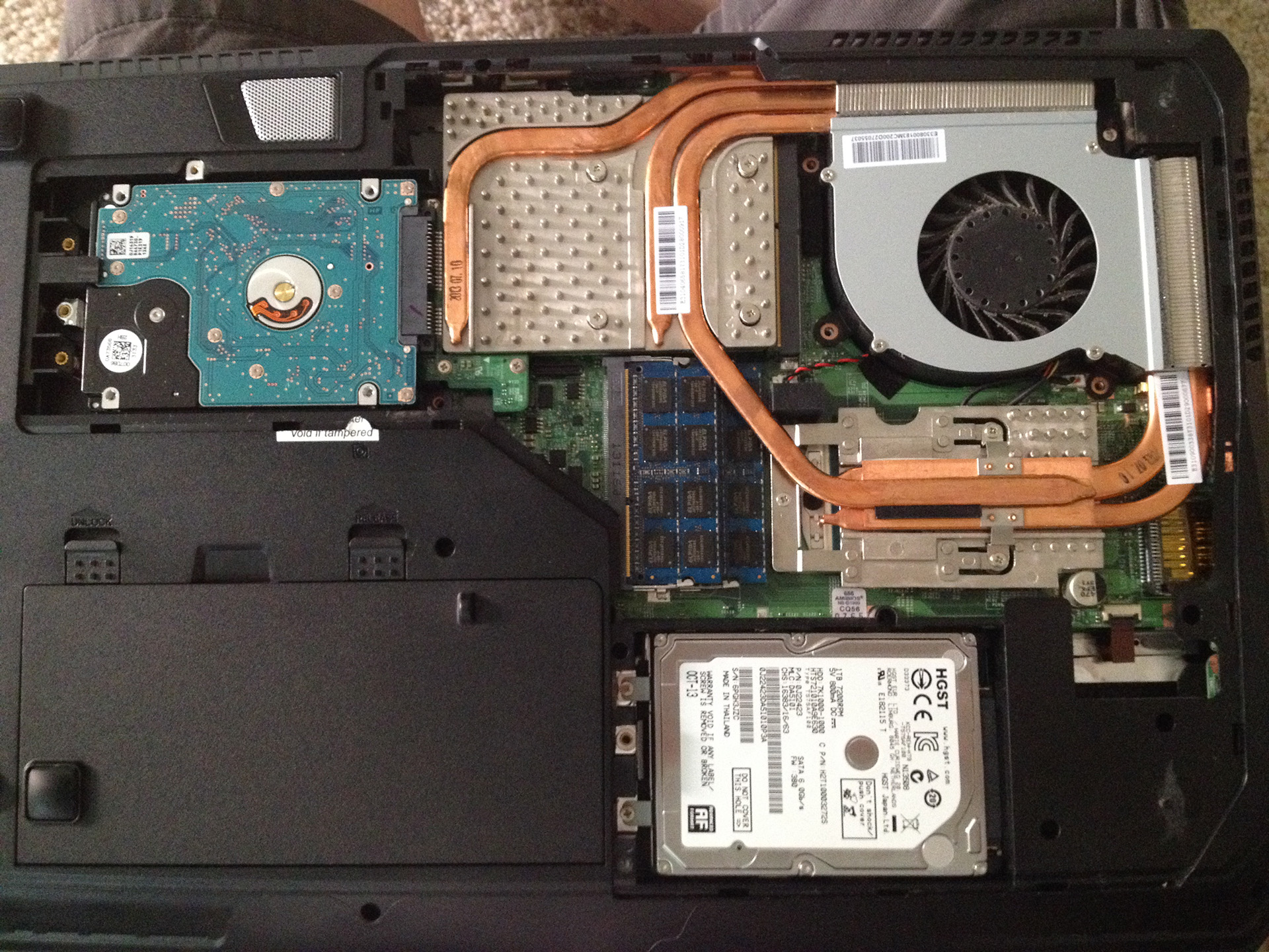

So I'm doing my first repasting job in my MSI GT70 20C (CPU and GPU), it has a connected heat pipe from the CPU to the GPU.
All of the guides that I have watched of a GT70 didn't have the connected heat pipes. So my questions is:
After I remove the cooling fan, should I disassemble everything together (the CPU and the GPU heat pipes/sinks) as one giant piece, or do I need to take apart the bridge heat pipe that connects the GPU to the CPU first since it rests on top of the CPU heat pipe?
Also, for the sticky pads (in video guides they were white but mine seem black) if they become disconnected, how do I re-attach when reassembling?
thanks!

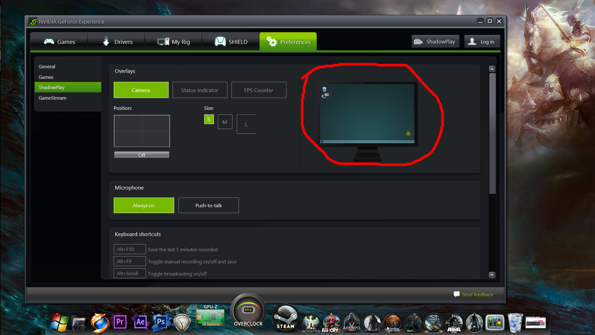

I've tried everything to get it to work but it just simply won't enable. the option is there but it just greyed out.
Hmm, after I did it the option was still greyed out like before. However, when I activate ShadowPlay via the on/off switch a small icon appears in the top right of the sample monitor in GFE.
See image below. I guess it's always on then.
