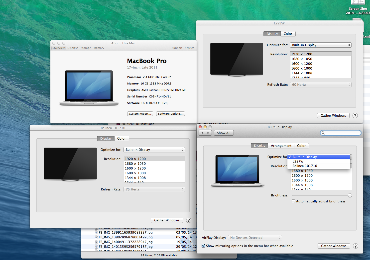

My computer crashed after I tried to open Premiere (which wanted to use GPU with CUDA which is the eGPU). After restart I switched between displays and set the resolution for one of the external displays and now the 780 TI is being used! thank’s a lot man! I was a little buzzed to have my 3 different displays all show the same. But then in the Arrangement tab I relocated the menu bar to one of the external sceens and now I don’t have to mirror displays and my GTX is till being used. Great! I will do some testing now. But it looks good so far. Thank you so much, man Cheers, Hannes -

I tried several resolutions and re-checked (closed it and opened it again) the About this mac / graphics tab... still the same -

Jep, it shows 2 monitors and the MBP monitor and there is an Arrangement tab and I checked the mirror display icon so all 3 displays show the same -

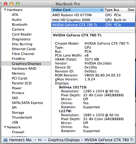

Hey there, that's what I got and yes I have plugged two monitors to the GTX and they are working. But I can't use the GTX for example with Unigine Heaven Benchmark... it says that it's using the GPU Chip. -

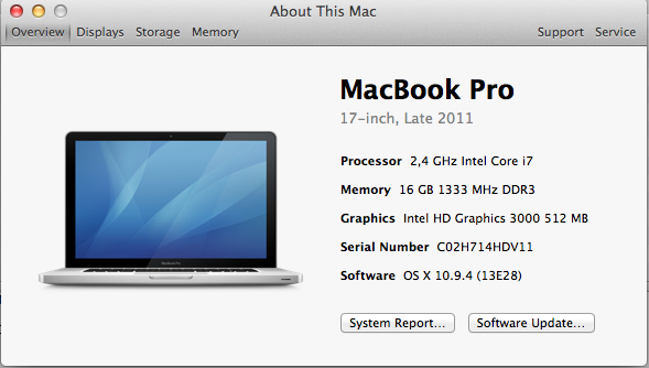

Hey entzoe, thanks for the quick reply! I just tried mirroring displays but still the GPU being used is the Intel HD 523 MB. What is going on? Do I have to take care of anything while startup? -
