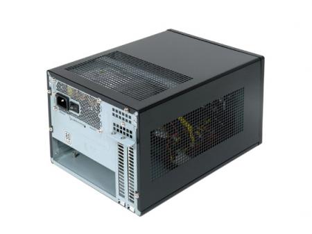

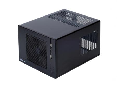

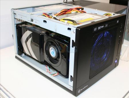

I'm using the Silverstone Sugo SG05. It looks bigger in the pictures that it actually is. The footprint is about that of a shoe box, 10.8L volume-wise, can take a 10 inch long GPU (maybe even 10.5 inch one) and is fairly inexpensive (I got mine for less than $30). Unfortunately full length 11-inch cards won't fit but the Sugo SG05 can modded to be accommodate one by cutting the inner metal panel. The new Sugo SG13 is supposed to have an extra .5 inch of clearance and may be a better option at this point. There isn't enough clearance at the bottom of the case to connect a standard powered PCIe x16 ribbon cable to the GPU so I'm also using a Supermicro RSC-R1UG-E16R-X9 right angle PCIe adapter. For PSU, I'm using the Silverstone ST45SF-G 450W SFX 80+ Gold v2.0. It's got a nice max 37A on the 12V rail (which should be enough for any GPU) and is fairly quiet - just make sure not to get the v1.0 which suffered from a noisy fan. V2.0 has a new fan and smoother speed ramping. That A4 looks gorgeous. I might get one myself to try out as an eGPU case.

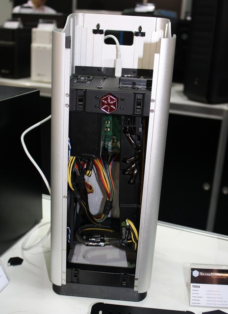

The A4 looks like an excellent option for a small yet versatile eGPU case. Having the motherboard and GPU in parallel configuration (like a blade server) and with a SFX PSU on the opposite end of the case is a great way to save space. I think the AKiTiO Thunder2 could fitted in this case very easily - one would just need a custom motherboard tray and an additional powered riser. We would end up with an eGPU case that is much smaller than the Silverstone Sugo SG-05 I'm using (6.8L vs 10.8L!), which is pretty awesome. The starting price is a bit steep ($150-250) but it seems the 3M riser adapter is a major factor driving up cost. Since we still need to use a powered riser cable, we may be able to purchase the case without the 3M PCIe riser at a significantly lower price. -
