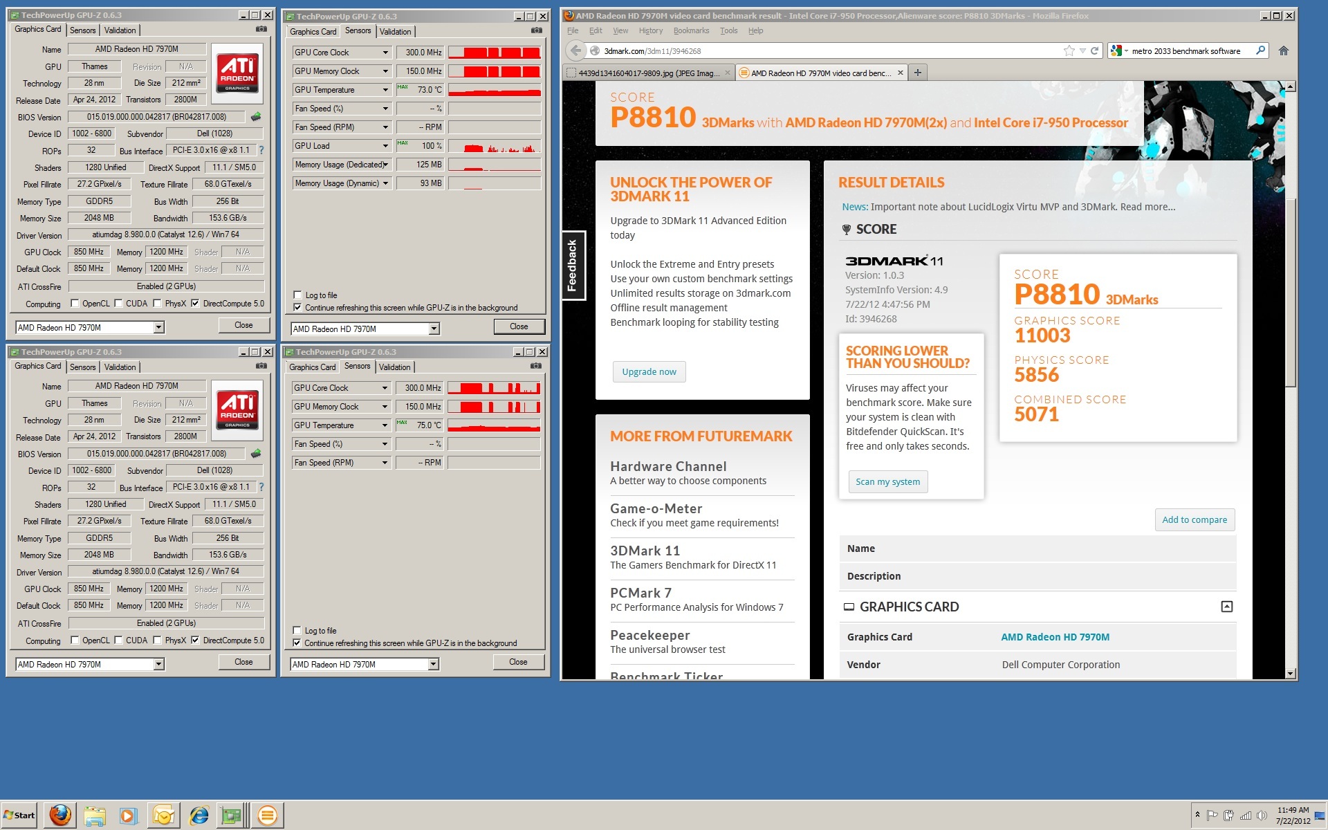

  7. Quick benchmarks... I don't OC, but my biggest concern was the amount of heat generated. These 7970s run so much cooler than my CrossFire 6990 set up. I know people say it all the time, but the R2 is definitely a great laptop considering the upgrade avenues for this thing are not exhausted yet. Overall, I'm a happy owner again.
  8. @svl7 - PM me your email address and I'll send you a copy of the original vBIOS. @Brian - I've been running The Secret World in CrossFire just to check stability and performance. Although it doesn't look that much different than my 2 x 6990Ms, the temps are *significantly* cooler - about 20 degrees Celsius cooler via GPU-z. With that reduction in heat production, I'm hoping it's going to save my R2's guts for a few more years. But I'll definitely get some standard benchmarking done tomorrow and post. @everyone else - It's a load off of my mind to know that I didn't waste that money on this upgrade and I am extremely thankful for everyone's patience and assistance.
