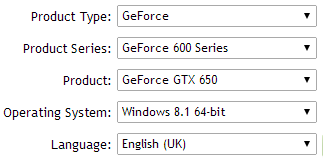

  7. I searched for the drivers: Did not look for specially "internal LCD", as there are no such drivers, I guess. However, after not using the eGPU for a week, I plugged it in yesterday and it did not work anymore. eGPU is not detected by my laptop and the GPU fan is spinning real fast. Any ideas? I have read something about JP4 or similar jumpers, but not sure what they are.
