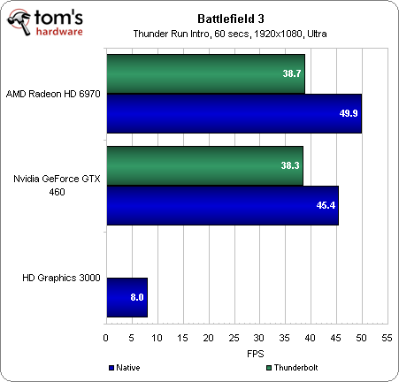

    I assume the Echo Express Pro gives the same performance as the SE/Helios except size/PSU.
    This benchmark is interesting:
    You can clearly see that the higher-end AMD card is faster than the GeForce in a native setting. Limiting each card's interface bandwidth puts them on even footing, though. The good news? There's no reason to spend extra money on a more expensive board.
    Echo Express Pro: Desktop Graphics In A Thunderbolt Chassis - Powerful Add-In Cards...Over Thunderbolt?
    Is buying a GTX760 a bad idea due to thunderbolt's max bandwith?
