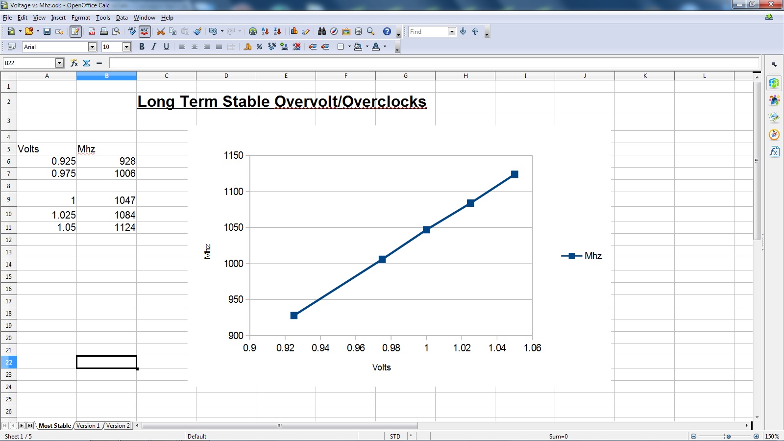

  12. I've been doing some extended long term testing in benchmarks & games with different overvolts & overclocks to work out a range of long term stable overvolt/overclock settings, and I thought you guys would be interested in the results because it might help you work out your own stable settings.
    First thing I noticed is that passing through a 3DMark11 benchmark run sucessfully was not a measure of long term stability. In fact long term stability was usually gained by dialing back core clock by one notch (13Mhz) after achieving a successful 3DMark11 run. Second thing, there seems to be a direct linear relationship between volts & stable overclock frequency; if you take a look at the attached picture you will see that the graph is linear, so that could be useful for you to use to help dial in your own further overvolts/overclocks.
    Hope anyone that reads this will find this useful or interesting!
    EDIT: I was kind of flabbergasted at how linear & exact this relationship was!
