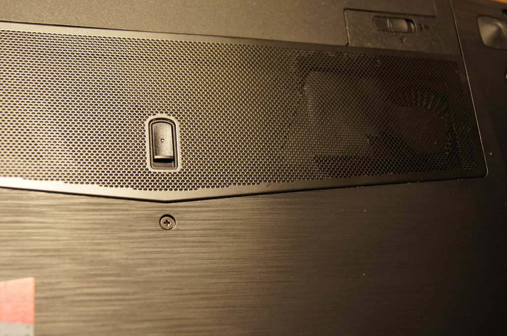

So, I wanted to remove the dust filter mesh that is on the vent as it can block airflow. (Blow on your fingers while keeping them like 1cm apart and use your other hand to see how much air can get through..not much right?)
I did this "mod" to my old XPS 15 and you could feel significantly more air blowing through the vents.

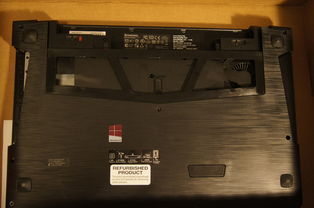

1) Remove the bottom cover of the laptop. You can see other y500 disassembly threads. Pretty simple: take out battery, take out optical drive, unscrew 9 screws, CAREFULLY pry off back, etc

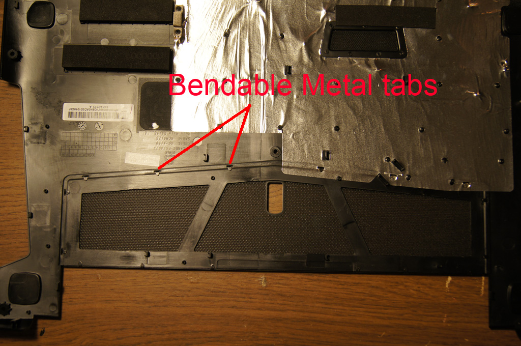

2) To remove the vent, there are these metal tabs which can be bent. I used a very fine/thin flathead screwdriver to pry the tabs. NOTE: If you feel like doing this, don't touch the tabs. Skip to step #4.

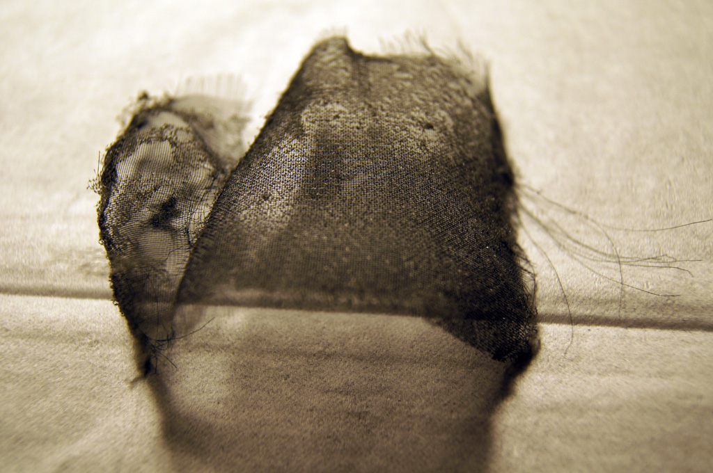

The vent part is pretty much all plastic except for the tabs, so you will scratch it up. Metal screw driver versus plastic...

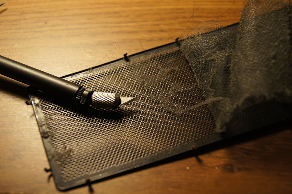

3The mesh itself is actually made from some sort of cloth. I basically used the flathead screw driver to scratch off the mesh. I didn't take off the whole mesh. Just the part that was covering the fan. Then just put the vent back onto the back cover and push down on the metal tabs to lock it in.

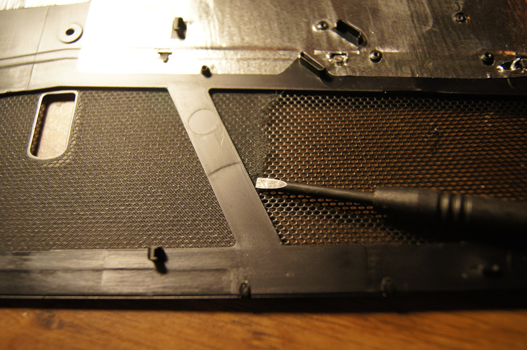

4) Basically steps 2 and 3 was a mistake. It would have been much easier and cleaner to just scrape off the mesh with the vent still on the back part.
5) You can see that it's not very pretty...I would have just gone with step 4 and scrape using the plastic border area as a guide.
For reference: here is what the back would look like if you just took the vent out all together (the back part is obviously missing the optical drive and isnt attached to the laptop)
