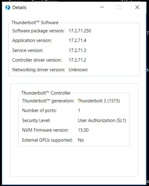

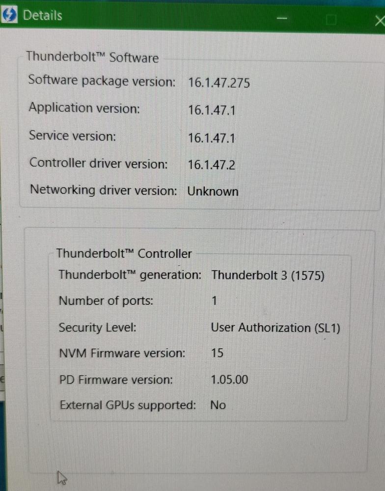

All are running but I cannot get the gpu to show in the device manager.
My Thunderbolt specs say NO egpu support. Did someone here actually manage to make this work?
Acer has a third party chat that is worthless.
I've updated BIOS, Thunderbolt, and Nvidia driver...but no luck.

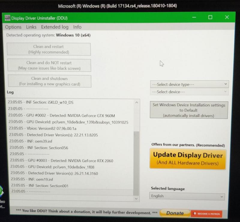

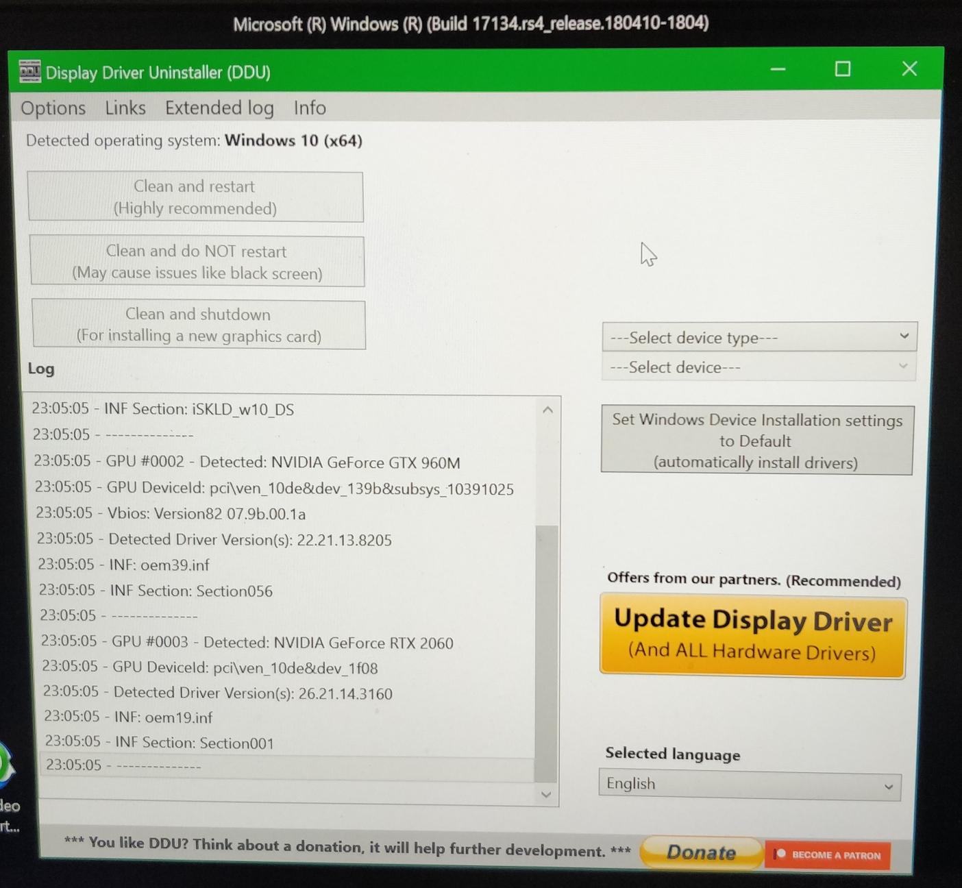

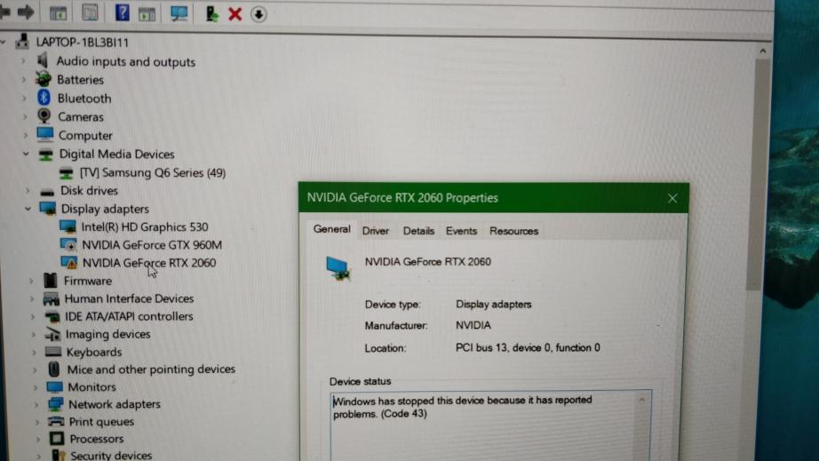

I am struggling with a similar setup.
Got the 15" VN7-592G with the Core X and an nVidia RTX2080.
Got latest BIOS and NVM fw ver 15, did use DDU to clean up and did a fresh install of latest Nvidia drivers for the RTX. The card is NOT recognized on the device manager.

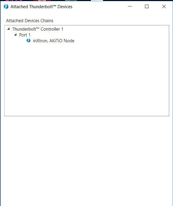

TB3 seems working, the Core is recognized. All similar to rapidDog post as well.

I did all mentioned here and got all as mentioned.
