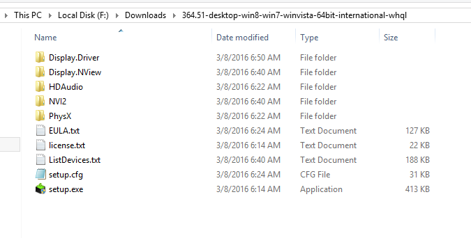

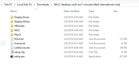

  3. GeForce 365.19 *Install drivers at your own risk* Windows 10 + GeForce Drivers are Killing Samsung and LG Notebook LCD Display Panels Uninstall both PrecisionX & MSI Afterburner (Keep RTSS) including screen overclocking tools *Still at risk* Requirements: Due to driver incompatibility (black screens, TDRs, BSODs...) with previous vBIOS versions you must flash latest @Prema's v2 980M & 970M (Please consider donating to Prema) Win10/8.1 'F8' Boot options 'Safe Mode' & 'Disable driver Signing' cmd (Admin) bcdedit /set {default} bootmenupolicy legacy -> reboot -> F8 -> select 'Disable Driver Signature Enforcement' -> Install drivers Run DDU "Clean & Shutdown (Safe Mode) Extract driver using 7-Zip Display.Driver folder, copy/overwrite the proper .inf file Extracted driver package (delete unnecessary folders as shown below) -> run setup.exe >>> Keep these folders only <<< INF MOD v365.19 nv_dispi.inf (including nvdmi.inf) PEG/Dedicated All Models: M15x, M17x, AW17 R1, M18x, AW18 R1 (including Optimus/M17xR4) excluding AW 2015 - GTX 980M , 970M , 965M , 880M , 870M , 860M , 780M , 770M , 765M , 680M , 675MX , 670MX , 660M nvcvi.inf: Optimus Alienware 17 / 05AA (only) GTX 980M - 970M - 965M Updated throttle free PEG MODs GTX 980M/970M GeForce 353.00 PEG MOD Win7/8.1 - Full_Profiles_11_v353.00.txt GeForce 352.84 PEG MOD Win10 - Full_Profiles_7_v352.84.txt GeForce 365.19 Win 7/8.1 GeForce 365.19 Win10 nv_dispi.inf_v365.19_Win7_8.1_PEG_Dedicated.zip nvcvi.inf_v365.19_Win7_8.1_Optimus_Alienware_17.zip nv_dispi.inf_v365.19_Win10_PEG_Dedicated.zip nvcvi.inf_v365.19_Win10_Optimus_Alienware_17.zip

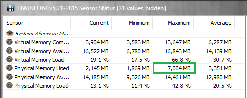

  12. Nothing wrong, RTSS v6.4.1 lacks DX12 support. I thought you were overclocking the GPU, just used steam overlay once...bandicam fps overlay.

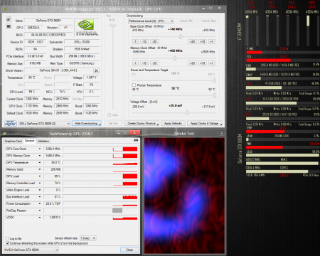

  14. @nick81 you will need to increase voltage for Rise of the Tomb Raider, even my stable 24/7 OC/OV @1266/1.087V, 3DM11 & FS loop settings, incl Valley...364.51 delete unnecessary folders and don't install GFE, don't use RTSS either...FPS counter Steam overlay (latest version) w/ DX12 support Rise of the Tomb Raider DX12 option. RAM used. Don't install v364.51. Instead, flash Prema v1.1.1 before installing Win10 throttle free PEG mod 352.84. v364.51

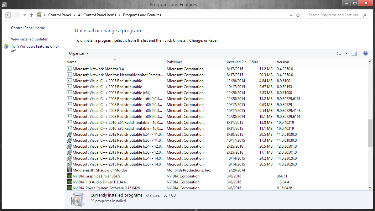

  15. @haXBOXpro Try v362.00. @anarky321 issues w/ SLI Uninstall under programs & features, then DDU leftovers. Delete unnecessary folders as shown above, Run as admin.

  17. Unfortunately...to fully restore this you need to install previous drivers -> reboot -> DDU -> reinstall 364.51, just reinstalling 364.51 won't work. @Tulius Please ask your friend (780Ms) to perform a cold boot like above, holding clocks without issues...OCing. Nice upgrade, there's no way back anymore! Never reset CMOS without a 'backup' card, defaults are UEFI/CSM (GUID partition table detected) instead of full UEFI. Cold boot, just remove the battery and power cable for 5 minutes.

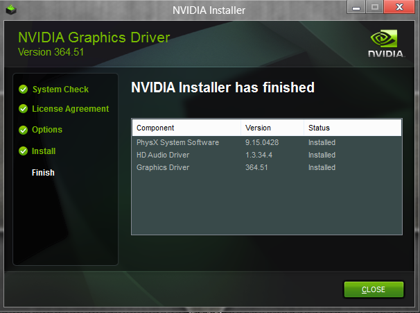

  18. @Tulius thanks man, please try removing the battery and power plug as explained above (cold boot) to rule out "temporary fix". If it doesn't hold clocks anymore you can easily restore this by installing previous driver(?) rebooting then uninstall/DDU and finally reinstalling 364.51. I've posted many temporary fixes, let's see if it behaves different this time. @mariussx M17xR4 120Hz screen upgrade? If so please try installing 364.51 (Prema V2)...including M18xR2's @anarky321 , @82280zx
  19. Prema V2, please try installing v364.51 above using the proper nv_dispi.inf. Both cards ASIC Quality? Try removing power cable and battery -> wait 5 minutes -> reinsert battery and power cable. Hopefully it's not temporary... Valley best FPS since 350.12. NV trying to compensate for previous drivers Fiasco...gimping performance?...

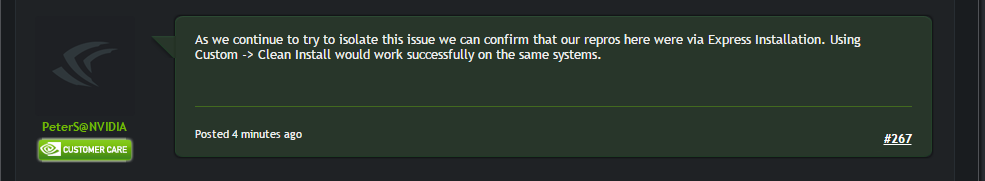

  20. GeForce 364.51 *Install drivers at your own risk* Windows 10 + GeForce Drivers are Killing Samsung and LG Notebook LCD Display Panels Uninstall both PrecisionX & MSI Afterburner (Keep RTSS) including screen overclocking tools *Still at risk* Requirements: Due to driver incompatibility (black screens, TDRs, BSODs...) with previous vBIOS versions you must flash latest @Prema's v2 980M & 970M (Please consider donating to Prema) Win10/8.1 'F8' Boot options 'Safe Mode' & 'Disable driver Signing' cmd (Admin) bcdedit /set {default} bootmenupolicy legacy -> reboot -> F8 -> select 'Disable Driver Signature Enforcement' -> Install drivers Run DDU "Clean & Shutdown (Safe Mode) Extract driver using 7-Zip Display.Driver folder, copy/overwrite the proper .inf file Extracted driver package, run setup.exe -> Keep these folders only <- INF MOD v364.51 nv_dispi.inf (including nvdmi.inf) PEG/Dedicated All Models: M15x, M17x, AW17 R1, M18x, AW18 R1 (including Optimus/M17xR4) excluding AW 2015 - GTX 980M , 970M , 965M , 880M , 870M , 860M , 780M , 770M , 765M , 680M , 675MX , 670MX , 660M nvcvi.inf: Optimus Alienware 17 / 05AA (only) GTX 980M - 970M - 965M Updated throttle free PEG MODs GTX 980M/970M GeForce 353.00 PEG MOD Win7/8.1 - Full_Profiles_10_v353.00.txt GeForce 352.84 PEG MOD Win10 - Full_Profiles_6_v352.84.txt GeForce 364.51 Win 7/8.1 GeForce 364.51 Win10 nv_dispi.inf_v364.51_Win7_8.1_PEG_Dedicated.zip nvcvi.inf_v364.51_Win7_8.1_Optimus_Alienware_17.zip nv_dispi.inf_v364.51_Win10_PEG_Dedicated.zip nvcvi.inf_v364.51_Win10_Optimus_Alienware_17.zip

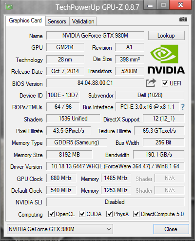

  21. PCI\VEN_10DE&DEV_13D7&SUBSYS_05AA1028&REV_A1 >>Optimus<< copy only nvcvi.inf, disable driver signing before installing drivers. Did you flash Prema MOD V2 980M ? Proper nv_dispi.inf Win8.1? v364.47 Win8.1 v364.51 Win8.1 Win8.1

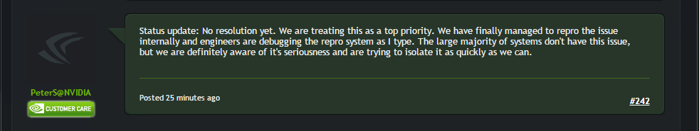

  22. UPDATE: After finding a critical installation issue, the team has replaced yesterday’s driver (364.47) with today’s new driver (364.51). This driver has been submitted to Microsoft for WHQL-approval () and we will update the driver package online as soon as we have the certified package. 364.51 BETA Windows 10 64-bit 32-bit Windows 7 & 8.1 64-bit 32-bit
  23. No issues whatsoever, clean install option. 362.00 > 364.47.

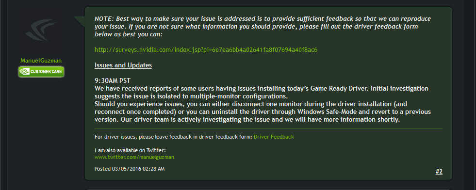

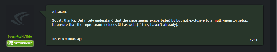

  24. 364.47 >>WHQL<< single & multi-monitor setups BSODs, TDRs and black screens
  25. 364.47 >>WHQL<< single & multi-monitor setups BSODs, TDRs and black screens
