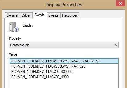

My Frankenstein seems to "work" both with the k5000m and 680m vbios. I installed Windows 7, Optimus enabled results in blue screen, but Optimus disabled allows me to install the 680m driver, without the Windows 8 error. Running 3dmark again.
I have successfully flashed the bios to that version. Did your device id update?

I looked that Information up under Device management, hardware IDs.
*EDIT* command "nvflash -5 -6 k5000.rom" worked, but the device ID is unchanged in windows. Does that sound right?

Loaded GPU-Z, send me a PM with your email so I can send you the vbios.
Info from GPU-z:
GPU GK104 Revision FF
Technology 28 nm Die Size 294 mm2
Release Date June 4, 2012 Transistors 3540m
Device ID 10DE-11A0 Subvendor Dell (1028)
