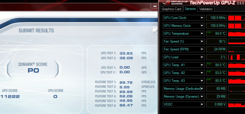

Ok, furmark gone
, I did use the Dell 6970M backplate, but i've grinded it down to the proper size.
But i did forget to modify the heatpipe xD
Done it now and the heatsink makes proper contact now.
These are the temps it reaches during single 3DMarkVantage run.

Hello, everyone.
I've just recently upgraded my M15x to 6970M and i have 2 problems that really keep bugging me.
The most important is heat:
idle temps are 56°C
load temps are (100°C+ furmark after some time the PC shutdowns, and wont start until it cools off) (around 94°C with single 3DMarkVantage run)
The second problem is that in Stealth mode it's almost all the time in 400/900 profile, but when it is out of stealth it downclocks to 100/150 like supposed.
So actually in Stealth it runs over 61°C almost constantly.
What i've done
-flashed to 1V Vbios
-installed latest AMD Drivers (12.10)
