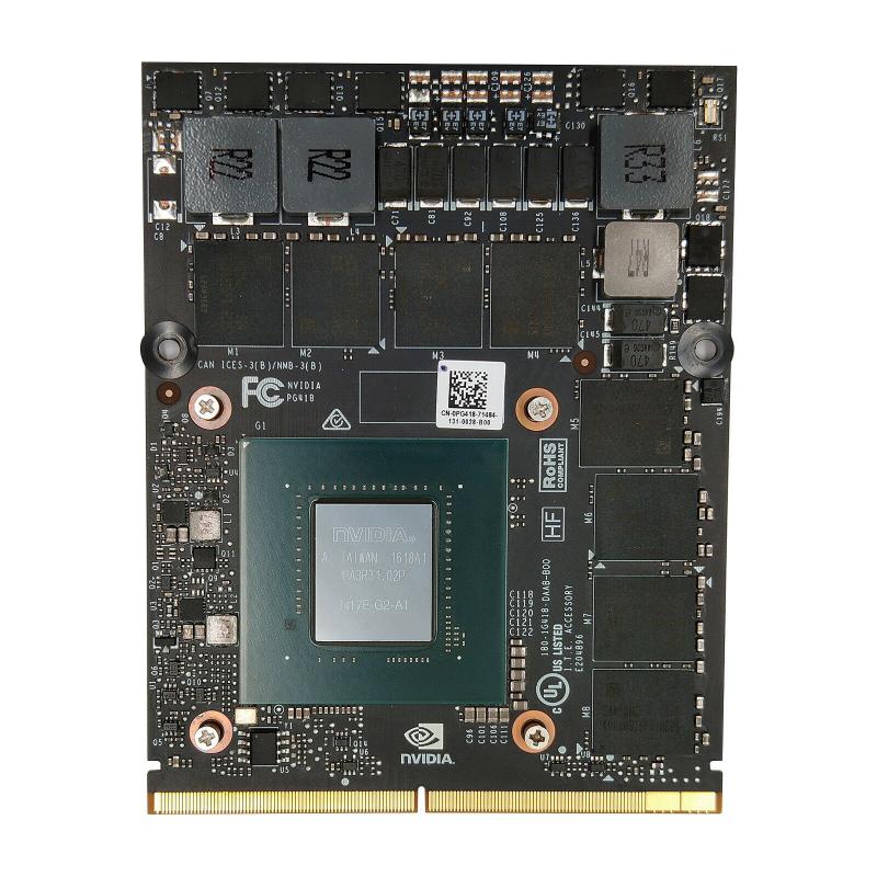

    3) You will Need a 1070m graphics card. This is where things get tricky as there are various 1070 cards you can look at that will fit into the MXM slot, but because I rather keep things simple, and this card was the one that worked for me, we are going to be looking at the standard 1070M 3.0b black PCB standard form factor that will fit straight in with no modifications needed to our frame. I bought mine on ebay and asked the seller if the card had a 1BA1 Vbios IF it has any other vbios other than this, then it will NOT WORK. So i would advise to ask around for various sellers if.

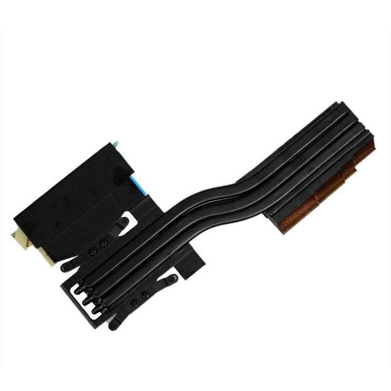

    5) This part is pretty important, a absolute requirement is a Alienware R1 5 pipe copper heat sink. Without this, your GPU temperatures are going to be way up high in the 86Cs under full load with the stock heat sink. When I installed this heat sink and replaced the original one, It easily brought it down  back to  stable temperatures. More on this later. This looks alot like the stock 3 pipe heat sink the laptop originally comes with, but do not be fooled, this is full copper and has 2 extra pipes. If you do skip out on putting the 5 pipe heat sink, I would be surprised if  your 1070 lasts a year

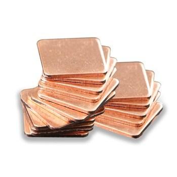

    5a) We also need a 1mm thick 20mm x 20mm copper shim since this heat sink does make direct contact with the core.
    10PCS-LOT-Thickness-0-1-0-2-0-3-0-4-0-5-

    6) take the new R1 heatsink and with some pliers, bend the 4 prongs down slightly. I felt that it was putting too much pressure for the core where the prongs where. Then take the copper shim and apply some thermal paste on the side  that will be touching the heatsink. Make sure that there is enough thermal paste covering the shim and that there are no spots missing thermal paste and do the same for the side touching the core and put thermal paste on the die. (or alternatively, you could solder the shim to the heatsink which will result in better temps)

    8) Once you have thermal pads installed, you can go ahead and put the heat sink on. You will notice that when you go and put the back cover on, it does bulge because of the 2 extra pipes that sit higher, but still closes with force. If you want you could modify the case and cut the piece where it sits higher to make it close properly.

  14. Alright, So In the manual, it says "This card is based on the standard mobile PCI-express module version 3.1 specification, delivering the latest and leading edge GPU benefits for your embedded system" meaning that it is not a 3.0b card? Or is that something totally someting different and I'm mixing 2 different things together that don't need to be mixed at all. Sorry for my noobness in this area.
    And i found out that this card is non G-sync  varient due to the the device ID 1BA1 so i don't think I will need to install a dell v-BIOS
  15. So, what i understand is that if my card has a G-Sync vBIOS on a card that isn't supposed to have a G-Sync vBIOS  then I would have to flash this vBIOS ( This is the one you most likely might of flashed it with)
    https://www.techpowerup.com/vgabios/209886/209886
    (Oddly enough, it says UEFI is not supported?)
    If the card is a legitimately G-Sync card, then I'm guessing i can't do anything there, but return it.
    Edit: As a side note, I also found no mentions G-Sync anywhere in the manual or the product specifications below
     Support DirectX® 12, OpenGL® 4.5 ,OpenCL® 1.2, Vulkan, HDMI 2.0b, NVIDIA Optimus™, NVIDIA BatteryBoost™ , NVIDIA Ansel, NVIDIA GPU Boost™ 3.0, Direct Compute and VR Ready
    So if it does have another v-BIOS that is not a G-Sync one, my assumption would be that I wouldn't have to flash a Dell vBIOS
