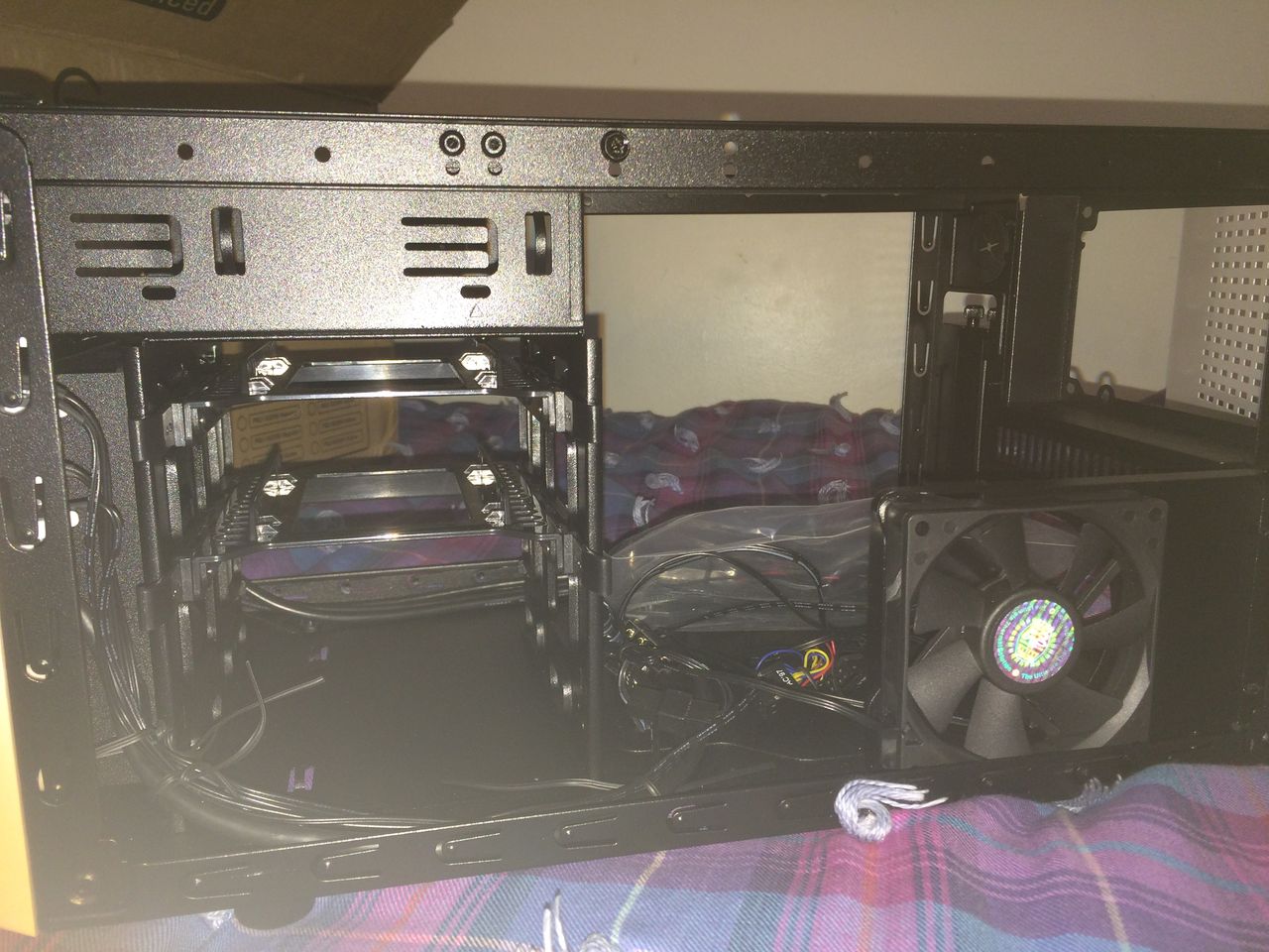

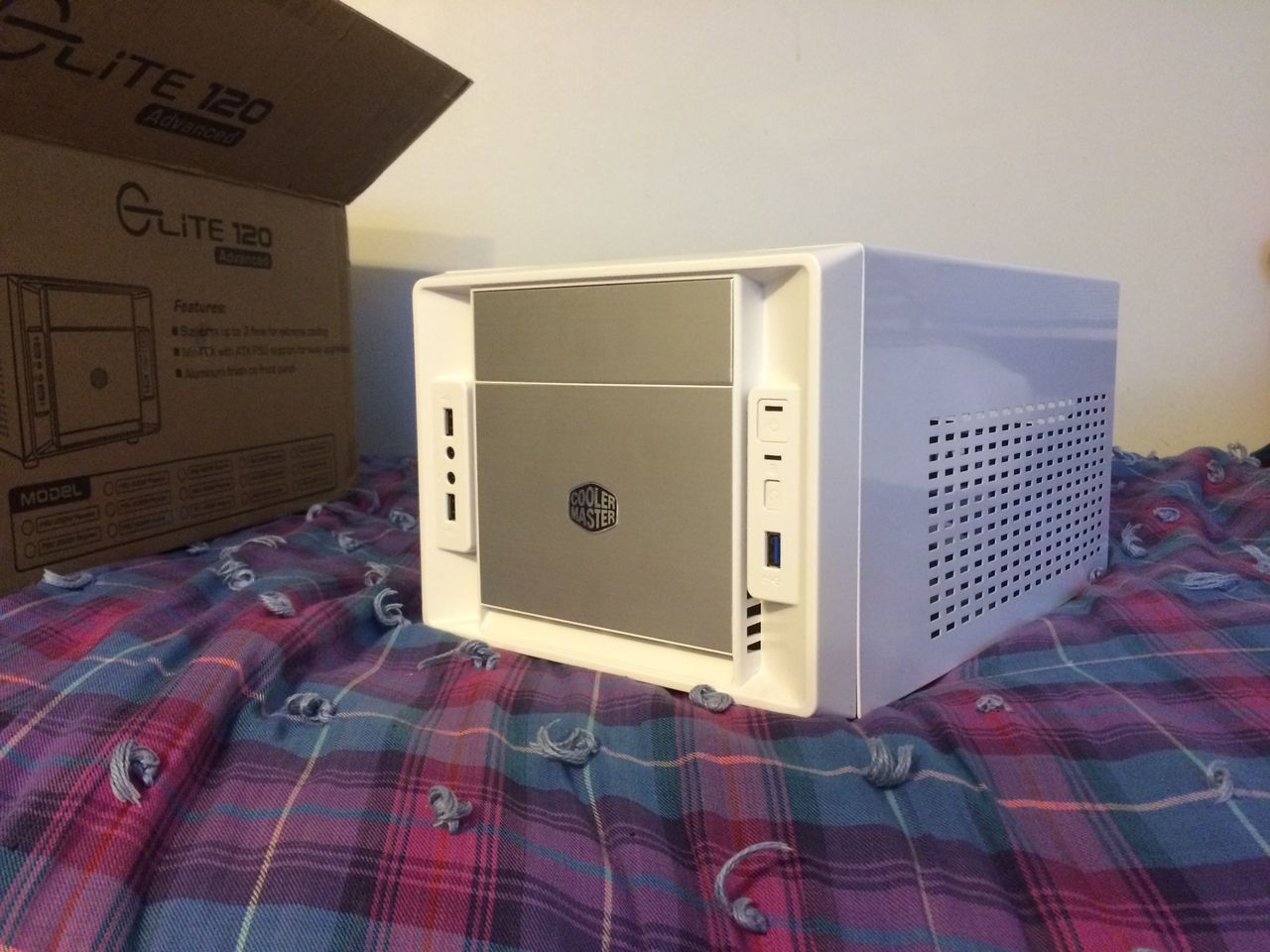

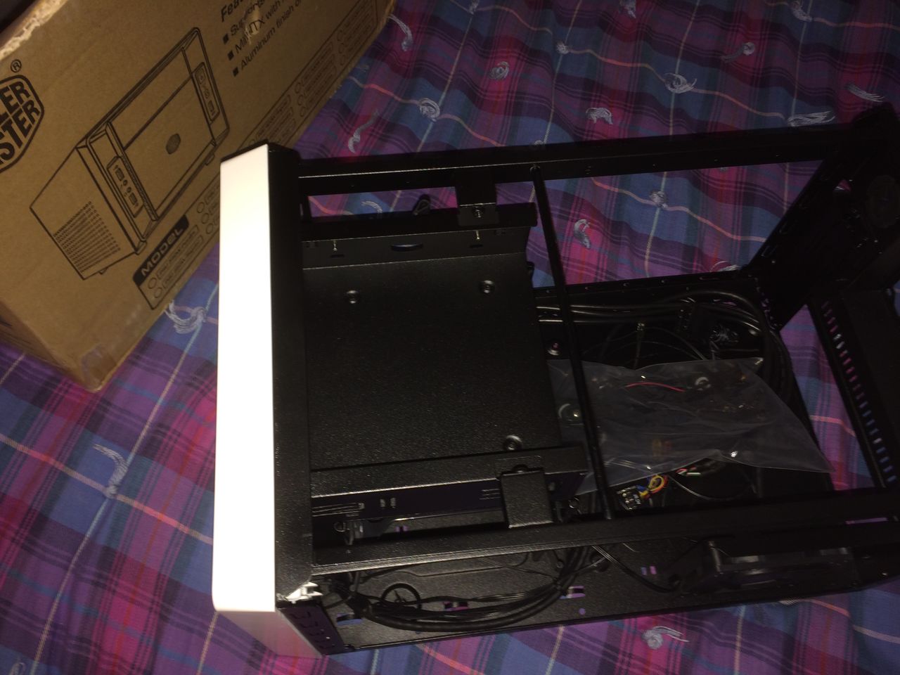

    Since I love the idea of having all my stuff on one sleek, organized computer, I would like to have a 15 inch macbook pro (2015) with an external 'docking station' of sorts that houses hard-drives, a disk drive, and extra ports (usb, ethernet, ect.), and of course, a powerful gpu. I would have two thunderbolt cables: one for the graphics and one for everything else. I would like the external docking station to be housed entirely within a cooler master elite 120 white that I have laying around. The thing is really good looking and seems to be the perfect size. I have attached some pictures of the case for reference.
    I would like to put the power supply, the graphics card, the hard drives, and the disk drives in their natural places in the case, and I would also really, really like the egpu to work in both windows and mac. It would be cool to have the ports on the case work, but this is in no way necessary.
