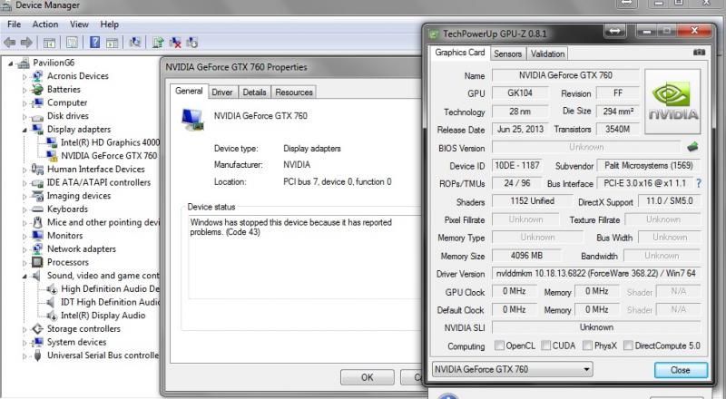

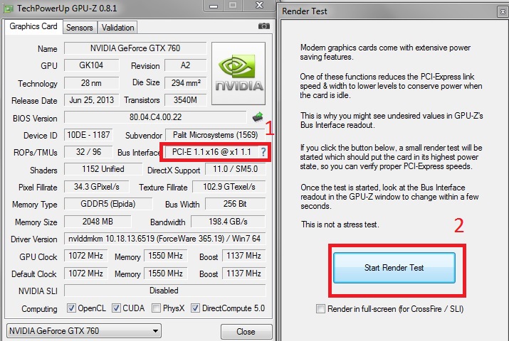

  8. Think you mean Pcie bus interface and you can check that with GPU-Z. Open the app and you should see something like the picture below. Press question mark (1) and start render test (2) and during test the bus interface should change to @x1 2.0. If it doesn't you need to set eGPU from Setup 1.3 to Gen2. I don't really know as well how the thing works with chainloading or startup.bat. I personaly use startup.bat option every windows startup after I saved in the file with F3 every setting I needed. P.S. So you're saying that you payed 65+22+15+25=127$ just for the PE4C adapter? Wow that's expensive. I mean I only payed about 40$ for my GDC Beast (delivered from China). I'm going to check around at hwtools but if it's at 127$ it's no deal for me. I can live with the driver crashing every once in a while and just Gen1 speed.

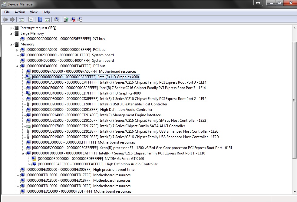

  10. This is getting weird. Now all of a sudden after 8 hours, computer was shut down during this time, I entered windows normally, without setup 1.3 and the video card works again. What is going on here? I mean for a whole day yesterday I couldn't get it to work for just one bootup and now it works again? Anyone any ideas? Edit: Ok update time. It's kind of working for the moment, don't know why now but I'm happy if it stays this way. Difference from above is that I didn't force 32bit compaction on the iGPU (no clue if this makes any difference or not), I had to dial down to Gen1 for the eGPU (was getting constant crashes from nvidia driver otherwise) and I also disabled from setup 1.3 my onboard LAN card (again no clue if this makes any difference but I'm not using it anyway). These is the memory range the egpu uses now: Only issue remaining is this conflict below (doesn't seem to affect system stability or something for now): P.S. Still waiting for suggestions or any insight for my setup.

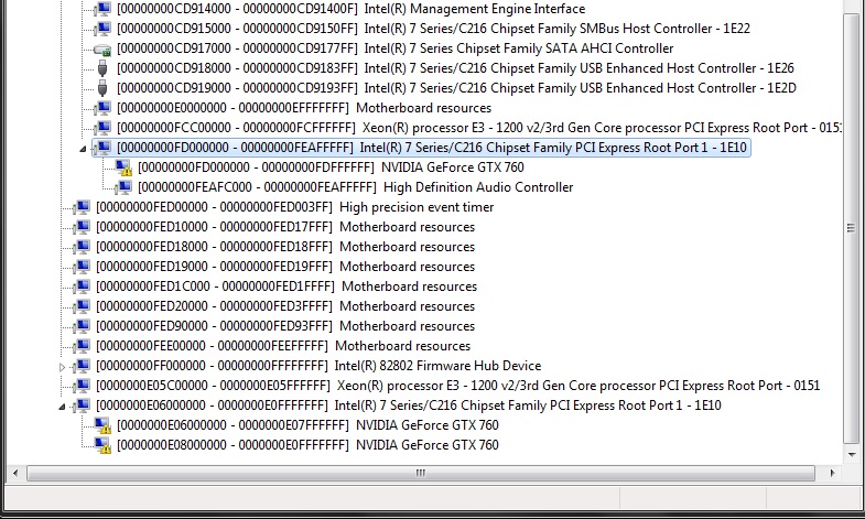

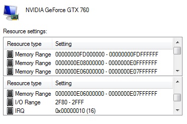

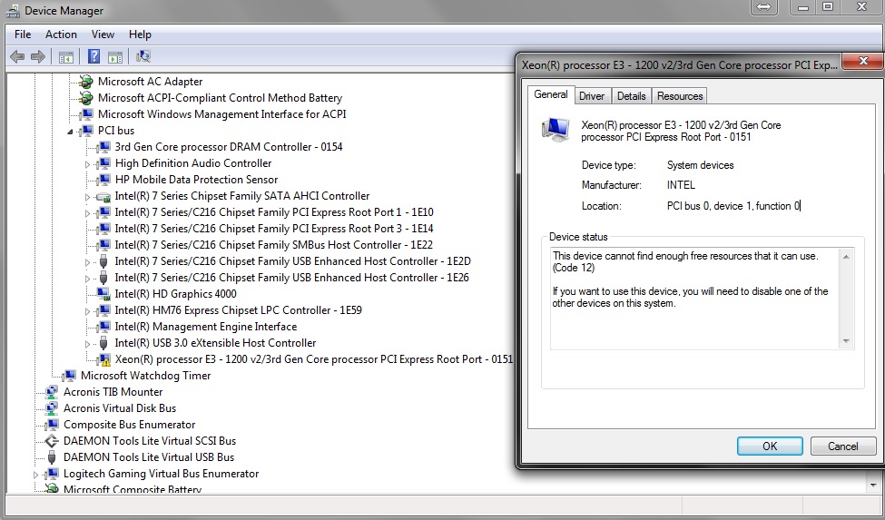

  11. Well my GDC only has one switch that seems to have 3 stages but it's been sitting to the far left since I first used it (that's supposed to be 0 delay or something). But for the love of God I tried almost every option in Setup 1.3 and it seems nothing works. Either I get into windows and the egpu has error 43 or sometimes I get a bluescreen before windows even loads up. Just tell me what info I have to provide to better help my problem solving and I'll provide it. I'm outright baffled that it worked for a week and without touching the setup or installing anything it started this error 43 nightmare. Edit: Ok so I did the DSDT override and allocate the eGPU into 36-bit, Endpoint=56.25GB, iGPU forced to 32-bit, disabled my dGPU, set Gen2 on my eGPU port but I'm still getting error 43. From the pictures below I don't know if I did the DSDT override correct. Anyone can help a bit? Edit2: Ok I actually managed to make the card show the resources tab by puting the laptop into sleep and waking it up. It's getting some conflicts here and the error code changed to 12 ... sigh. Memory Range 00000000CC000000 - 00000000CCFFFFFF not available. Memory Range 00000000C0000000 - 00000000C7FFFFFF not available. Memory Range 00000000C8000000 - 00000000C9FFFFFF not available. Input/Output Range 4000 - 407F not available.

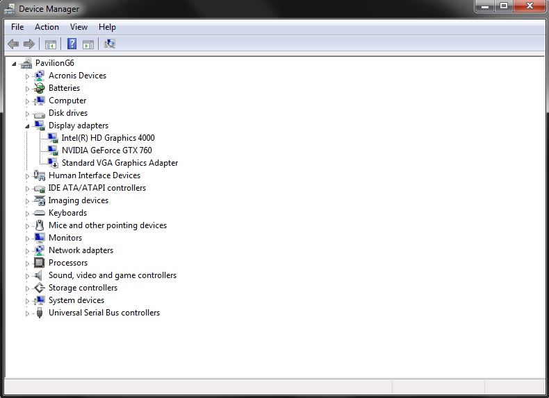

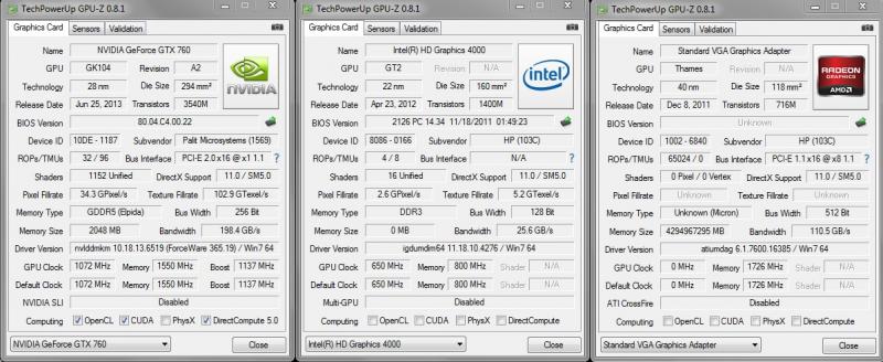

  13. Maybe I don't understand what you're trying to say but what's displayed there in device manager seems right to me. I mean there's the intel igpu (HD 4000) , the egpu (GTX 760) and lastly the dgpu (AMD HD7670M) that has the drivers uninstalled and it's disabled from device manager. Isn't that how it's supposed to be?
  14. Ok so I've been running this setup very well for the past days. Only once did the nvidia driver crash and I had to restart and that happened when the laptop was idle, I wasn't even near it. Now I've tried to run the egpu using the internal monitor with no success sadly. I tried using the desktop and the laptop nvidia drivers, I tried the delay switch on the GDC Beast, I tried hooking the egpu after BIOS and before windows loads up (windows doesn't even detect the egpu if i do it this way) but no luck. I can't disable my AMD dgpu from BIOS so it's only disabled in device manager (where it's detected as standard VGA adapter). Could this last part be a problem? Do I need to edit the nvidia drivers in some way? Do I need to buy DYI e-GPU Setup to set something up in that? Hope someone can help me with this one, if it's even possible to do on my current setup.
