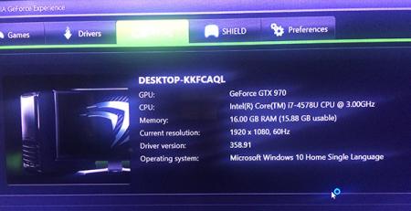

    Results
    Ok, I put the power plan on 'High performance'' and re-ran the 3D Mark benchmarks and got this result:
    GPU 12440:
    http://www.3dmark.com/3dm11/10994632
    GPU 9489:
    http://www.3dmark.com/fs/7718177
    A slight bump on the previous scores...
    I then remembered that I had set the 3D setting in the Nvidia control panel to favour quality over performance. Should I switch that to performance too? I'm now wondering what else I should tweak and optimise in my Windows installation!

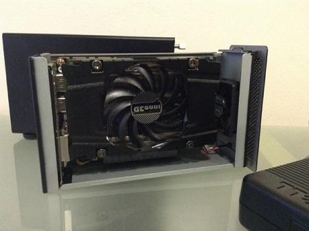

  3. Finally got my Akitio set up working last week. Over three months in the planning... trying to source all the parts from Sydney Australia wasn't as easy as I thought it would be.
    Machine
    Apple Mac Mini (Late 2014)
    i7-4578U @ 3.0hz
    16GB RAM
    250GB SSD
    Iris 5100 Graphics
    eGPU Hardware
    - Akitio Thunder2 box (approx $430 AUD)
    (Bought on a trip to Jakarta, Indonesia. This cost me a lot of $$, but easier than importing to Australia from the US)
    - Inno3D Herculez X1 GTX 970 ($550 AUD)
    (Not the cheapest card I could have got, but it was important to me to have one that fitted in the box without any modification)
    -  Dell DA-2 Power supply ($50 AUD)
    (Got really lucky with this one - found a GumTree ad from someone just a few miles away in Queensland selling one!)
    - Power cable (approx $30 AUD)
    (Props to Dschijn for helping me with the cable to fix everything together.)
    Total - $1060 AUD! Not exactly the cheapest hobby project I ever put together... but overall I'm very very happy with the results.
    Predominantly for use with my (Late 2014) Mac Mini in the lounge for game playing in Windows, but I was on a roll so also installed the drivers on the MacBook Pro too for fun.
    Installation
    Installing on the Mac Mini was somewhat easy, using the OSX script from goalque on this forum.
    I'm running El Capitan so was unsure if the script would work at all, but it worked first try. All I had to do was boot into recovery mode first and run the 'csrutil disable' command for the script to work. I'll have to remember to go back in and re-enable it sometime.
    Next step was to boot the Mac Mini into Windows 10. Hearing the reported issues I didn't expect it to work at all. But lo and behold, as soon as Windows fired up, it recognised the Nvidia card and prompted me to download the driver. Did that, and then rebooted and the card worked immediately. I can now flip between Mac OS or Windows partitions with ease whilst the box and card are plugged in. The only thing I noticed is both the box and card need to be 'on' before starting up the Mac Mini. Once the Mac starts up, the thunderbolt connection 'wakes' the eGPU and powers it up.
    Here are a few beauty shots:
    IMG_0461.thumb.jpg.8220e608aff07d4376c85
    IMG_0467.thumb.jpg.7754ffdb265b12459ed34
    IMG_0469.thumb.jpg.89366ee6f6e8c70ebf189
    IMG_0869.thumb.jpg.17b38696470993f0f7818

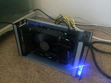

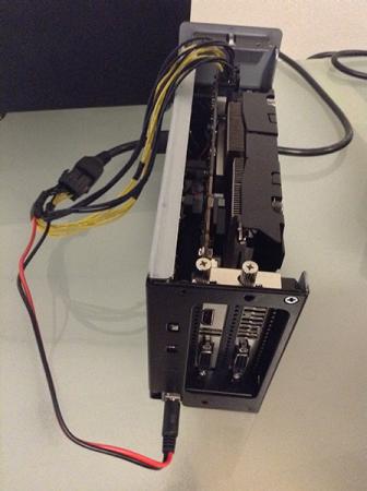

    At the moment the power cable connection is a little clumsy, and I have to use the card with the box open until I solve how to thread the cable out through the back. I don't want to drill any unnecessary holes, and my original plan was to remove the Akitio power plug connector from the board, solder the Akitio power cable directly to the board inside and thread the connector for the DA-2 out of the existing Akitio power plug hole. This looks to not be as straightforward as I first thought, so will probably take me a little while to figure out how best to do it.
    Right now I remove the Akitio outer case then plug everything together each time I want to use the GPU, and then take apart when I'm done so that I'm not leaving the GPU exposed when not in use. I'm terrified that I'm going to break the cable somehow whilst doing this, so will look to find a way to wire it all up permanently soon.
    The Akitio board also begins to run a little hot whilst powered up so I will likely end up cutting a hole in the external case at some point anyway. I have purchase a honeycomb fan grille from eBay ready for when I get around to cutting a hole in the casehttp://www.ebay.com.au/itm/161776314302?_trksid=p2057872.m2749.l2649&ssPageName=STRK%3AMEBIDX%3AIT
    Regardless of all this, I'm well happy with the setup and now just run the eGPU with the external case removed:
    IMG_0870.thumb.jpg.6f194e5194cc7c94831cb
    It would be good to see how others on this forum have solved the power cable issue. I see some are threading the wires through the tiny slots in the end of the GPU card, and some have cut a hole in the front of the Akitio box. I'm really looking for the least destructive method possible :)

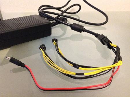

  5. Hi all.
    Loving this discussion. I've finally assembled all my parts - the only missing link is the cable between the DA-2 and the video card.
    I have:
    - Akitio Thunder2
    - Inno3D GTX970 Herculez X1 (to fit in the box with no modifications)
    - Dell DA-2
    Where I'm getting confused is that the card came with a single 6-PIN connector PCI-e power cable like this: 71RTWfffYuL._SL1500_.jpg
    But the card itself has 2x 6-PIN connectors. Is this because the card needs double the power of the previous version? (Which only had a single 6-PIn power connector)
    Or do I only need a single 6-PIN plug as per the supplied cable? I can't find any further info on Inno3D's site regarding this.
    At it's most basic level, I think I need one of these: http://www.amazon.com/dp/B0007RXDDM  (Though not this exact one, as I want the low profile version of the connectors to close my Akitio box.)
    The two 6-PIN males fit into the card, and the 6-PIN female into the right side of the 8-PIN DA-2 connector (+ paperclip in remote/ground holes)
    From there I will add another cable for the barrel plug to power the Akitio as per all the previous examples.
