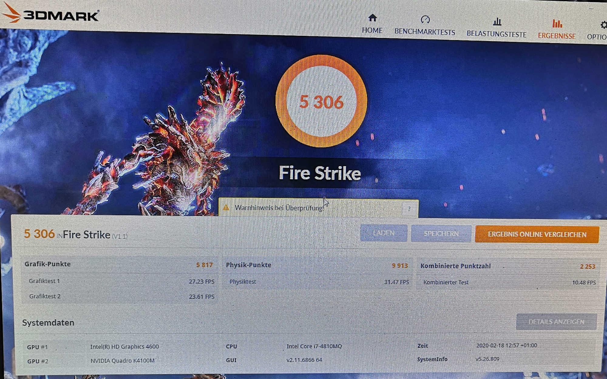

Here is the pic of GT70 (MS-1762 Board--3rd Gen Intel i7 )with Std core/mem Quadro M3000M
4 hours ago, Klem said:
Hi!
I think, as first step, you need to check if original stock Dell vbios 84.04.6D.00.06 will work in your MSI GT70.
thx for answer Klem
In past i tested and sold many GT70 (and GT60- Erazer 782x- 682x )with different cards- the notebooks had open Biosses-
Till today AMD Firepro M6100 and all Quadros K3000-K3100- K4000 and K4100 works fine even with oben Vbios 25% faster than K5100m (see pic Graphicscore 5,8k)
i also flashed the K4100m with HP OC bios and it worked in the GT70 (found and correct work even with MSI Optimus)
So i think it will be no problem with the Dell vbios and i saw a Foto with working M3000M with the Dell bios on it in a Gt70 .
But ok- card is in transfer- takes 1-3 days till i can tell more about-- (have less time in moment to work with the maxwell Tweaker so i thought someone did the job for the M3000M in zhe last years)
Hope someone is still alive ;-)

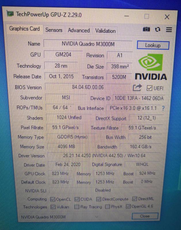

Bought a HP Quadro M3000M card for my MSI GT70.
As seen in a Polen forum the Dell 84.04.6D.00.06 vbios should work in a MSI
https://www.techpowerup.com/vgabios/207075/207075
So is here someone that could send me an open Version of that vbios or another Dell opened Version?

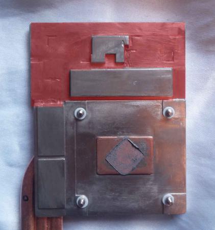

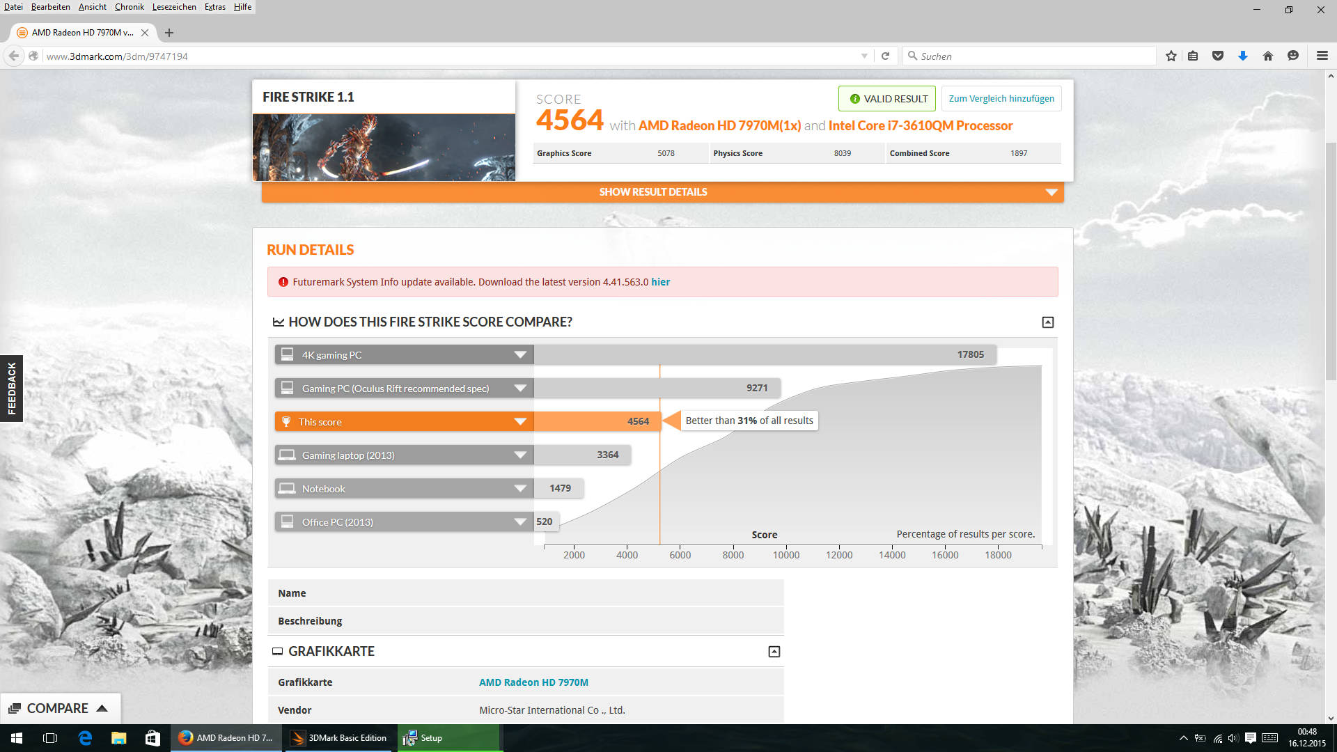

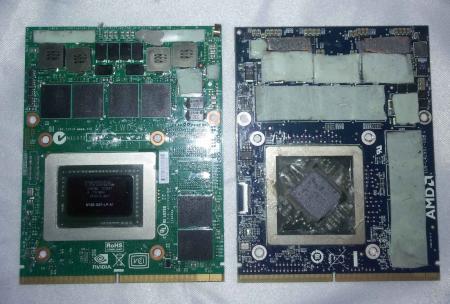

Ok i had a Medion (German manufacturer) X7817 MS-1762 its like GT70 ONS Barebone and a HD 7970M left.-
You also can take a HD 8970M it has the same layout and you`ll get it low cost at Ebay and it has high performance .
Both have DX12 support
HD 7970M is like GTX870M

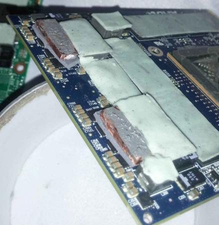

In picture 1 you can see on left site original Nvidia GTX670M comes with it and on the other site the HD 7970M. Thermalpads must be set as in the photo on HD7970M!
In picture 2 you can see what you have to do- the red area must be flat- one layer- the rest can stay as it is!
You can see how optimal the plate is for the ATI Chip in middle!
In picture 3 you can see the copper layer that you have to fit in.
Thats all

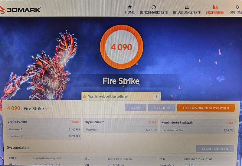

In picture 4 you can see test results with normal settings under Windows10
CPU i7-3610QM - no overclocking yet!- Under Windows7 it will be 200 to 300 points higher because of better driver and faster system!

for your interest:
i upgrated it with a ATI HD 7970m- with standart CPU i7-3610Qm you`ll get a firestrike13 nearly 4,6k without overclocking under Windows10-
(Windows7 value will be higher than Windows10 because of drivers +200 to +300 points)
This is same /better value like a GTX 870m

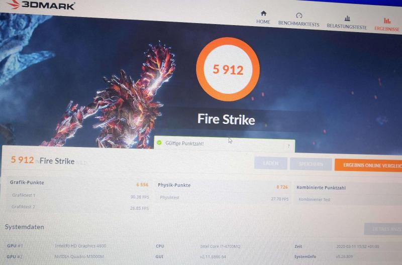

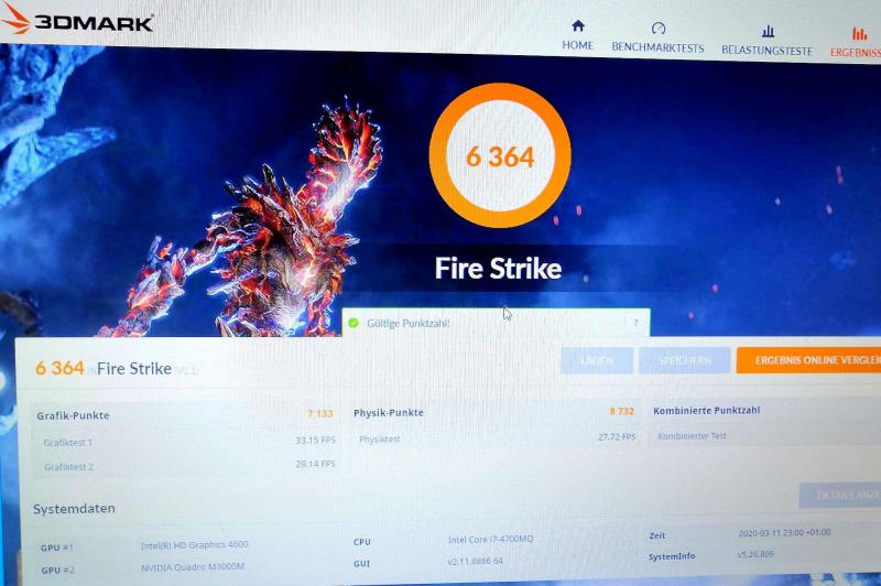

After long tests and mofifications the Nvidia Quadro M3000M fires now a Medion Erazer X7827 Notebook- MS 1763 Board - its like the GT70 2PC.
The first pic shows orig freq - the second +135Mhz..Graficscore is 7133 Pts- not bad and getting near GTX970 std.
Problem now is:
I cannot flash my maxwell Tweaker Mod Vbios cause
1. In Dos the Nvidia card will not be found- No list entry etc..
2. in Win10 nvflash i only can use -6 parameter and flashing will stop without result cause of worng vbios....
So if someone has a idea or a opened Dell bios witch i can check..
