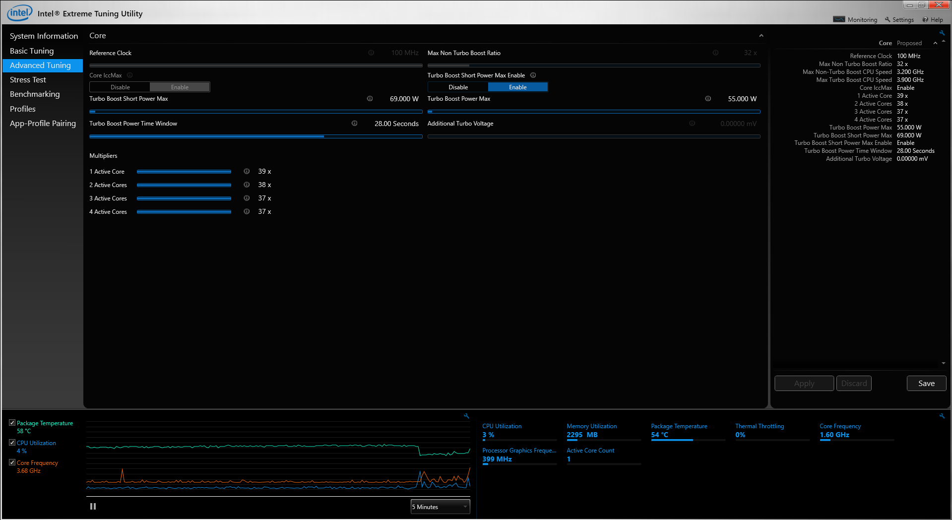

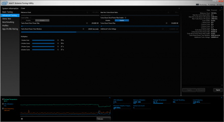

Well this all might be for nothing. If I increase the multiplier in bios on even one core by just +1 I get temps in the mid 90s and thermal throttling, so unless I'm missing something I won't be able to overclock the CPU due to thermal concerns.
The multiplier cores at stock are
1 core = 39x
2 core = 38x
3 core = 37x
4 core = 37x
and as I said if I increase any one of those by just 1 it gets too hot for my comfort.
It will directly take effect, XTU is just an alternative interface.
Understood, but at default bios settings XTU gives me no option to increase the multiplier and stays at the default 1-core 39x. When I change the bios to increase the core multiplier, then XTU shows the increased multiplier (I set it at 40x) but again it is the max and I cannot set it higher in XTU.

One follow up question, when I change the X-core ratio, does that apply the new settings, or does it simply enable the settings to be changed in IntelETU?

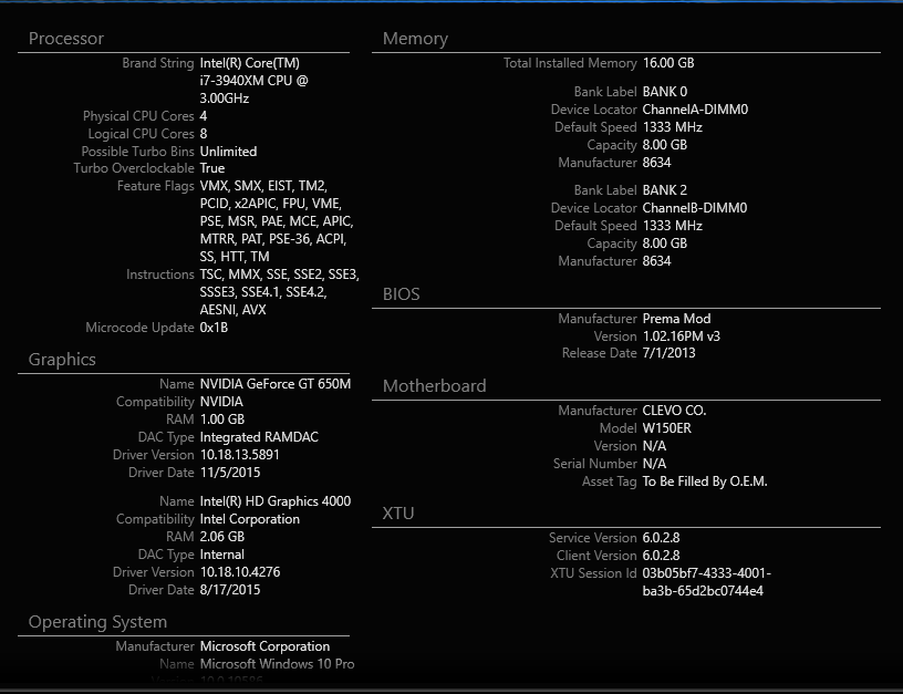

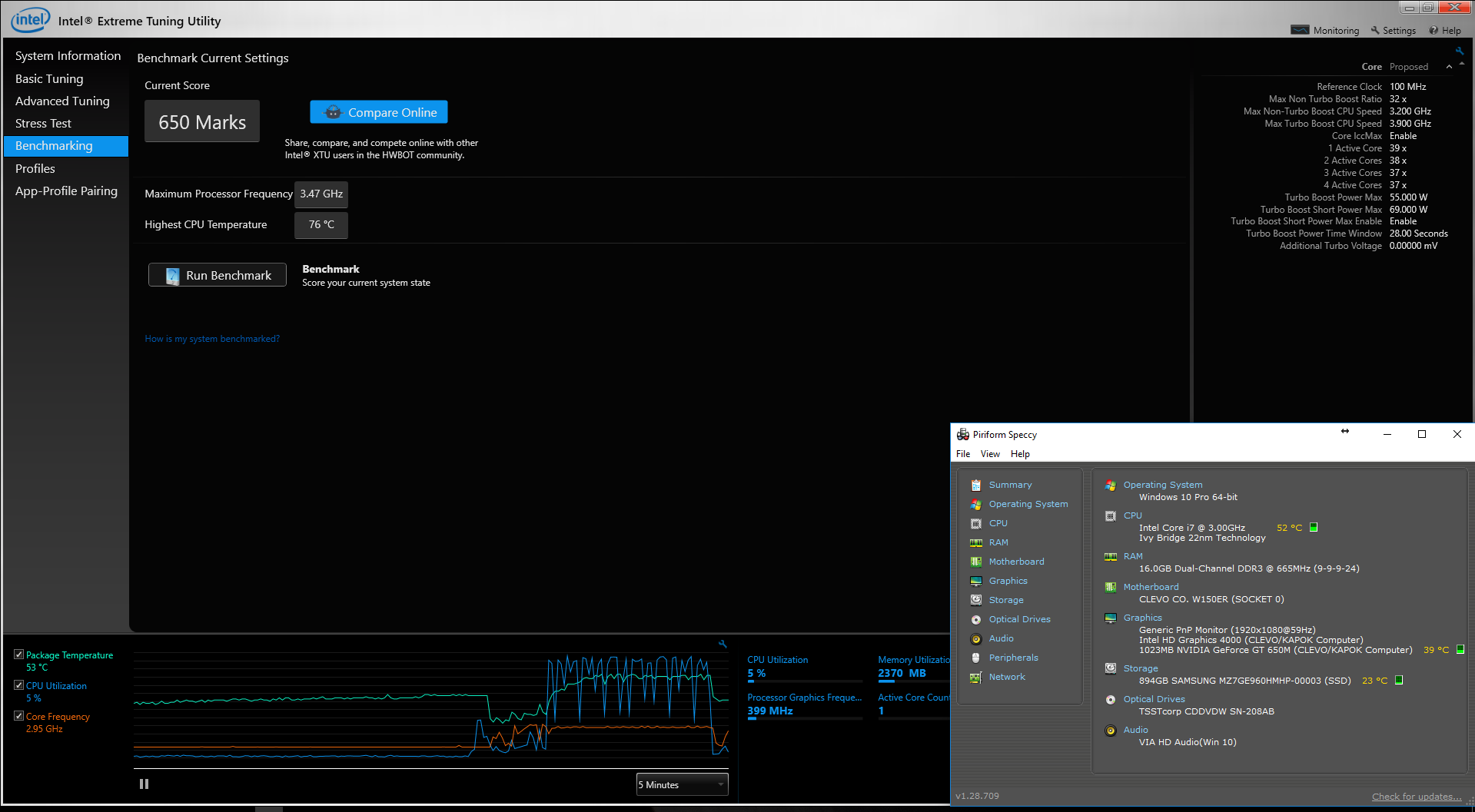

As this is a laptop, the external power supply is 19v, 6.3 amps, 120w. I know that cooling will be limited, but again I'm just looking for a little boost not extreme overclocking. Below is a screenshot of the simple benchmark with Intel ETU. Max CPU temp = 76C, max GPU was around 56C I think. There are adjustment arrows around the multipliers, but I can only adjust the multipliers lower not higher with those arrows. Perhaps I should also mention that the only other sliders I can adjust are "Turbo boost short power max", Turbo boost power max", and "Turbo boost power time window". The option for "Additional turbo voltage" is grayed out and unavailable.
First off I apologize in advance for the completely newbie questions about all this. I have no clue what I'm doing...
I flashed Prema's bios with the intention of overclocking the CPU and GPU a little. I'm not looking for world records here just a little boost. However, after hours of searching and trying to learn about this I have come up short.
The first question I have is the most basic: can I overclock this computer/CPU? I've played around a bit with Intel Extreme Tuning Utility, but no matter what changes I make I don't see any difference in the benchmark scores, and when I upload the score to hwbot there is a message saying "This profile was made on a system which does not allow overclocking. Try to enable overclocking related options in your BIOS, or use a different motherboard. Applying downloaded profiles may not work."
So I'm guessing that there is either a hardware bottleneck that does not allow me to overclock the CPU, or some setting that I am missing.
Here is a screenshot from Intel ETU with my system information:

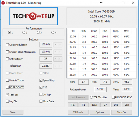

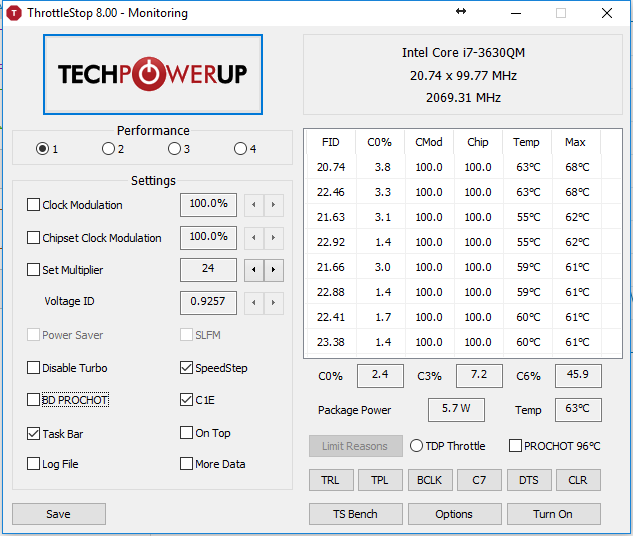

That's all well and good and thanks for the help, but I still don't know why the CPU started maxing at 50% in the first place, and I don't want to have to start Throttlestop every single time I restart the PC.
BTW, I don't see any difference in performance or clock speed when I checked the set multiplier button (34T). Simply starting TS and not doing anything else allows the CPU to go to 100% usage.

Thank you very much for the reply. I will run throttlestop and post the results.
