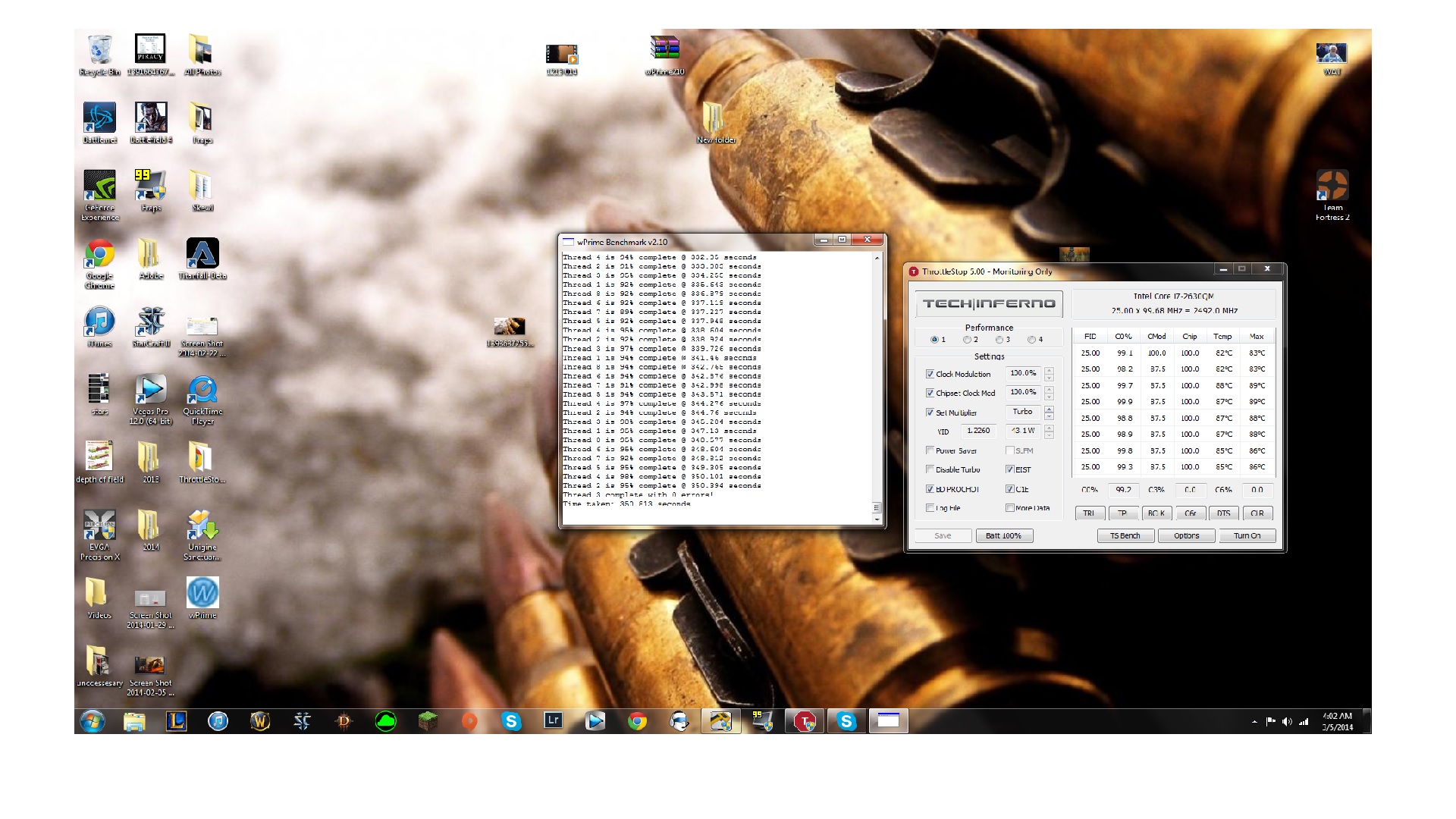

  8. Still spiking down to 6 occasionally, not really sure what could be causing it.. pretty stumped at this point, CPU temps haven't gone above 73 on any of the cores and gpu max 66

  11. Well ever since I did http://forum.techinferno.com/alienware-m17x-aw-17/2285-unlocked-throttlestop-alienware-m17x-r3-r4-m18x-r1-r2.html and went into the bios etc and changed the pwr limits etc, I've noticed my fps being lower overall and spiking. I'm going to undo what I did for now and see if that helps, but not really sure why this is hindering performance. Was I supposed to raise the short/max higher then 72?
  12. I dont know what I fucked up but my temps have been lower, and it seems as if it is running worse, framerate is lower.. might be the new drivers but idk. Wasn't this bad lol. Probably going to just un do this..
