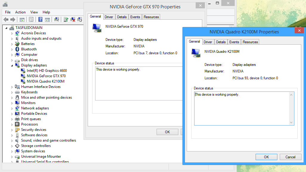

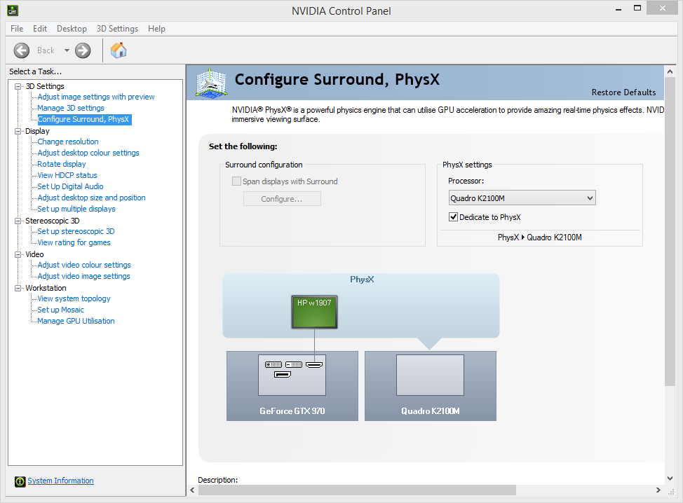

Alright this is a weird situation. I left my computer on overnight, and the driver reconfigured without my knowledge to include both the dGPU and eGPU. I can't boot to windows with both of them on, but if I disable the dGPU in windows and restart with the eGPU attached, PCI compact ignoring dGPU, then chainload to windows there is no BSOD, and I can then reenable the dGPU without crashing the system, and gaining the ability to dedicate the dGPU to PhysX. This has left me thoroughly confused, but I'm not gonna question it. I do have a question, however, directed toward @Tech Inferno Fan or anyone else with knowledge on the subject. Can I use the dGPU for PhysX without any negative repercussions? Previously this would disable Optimus compression to the eGPU, but under the x4-16Gbps link using Thunderbolt, does Optimus compression still exist? Images of everything working:
Here's an implementation I haven't seen yet. Got myself one of these: MSI WS60, an AKITIO Thunder2, and the Zotac GTX 970. I'll get some benchmarks in later (next weekend) because of school, but I've played a little bit of Shadow of Mordor with most settings on ultra and no lag, so thats promising. EDIT: Just "stress tested" (played assassins creed unity on high) for 2ish hours, system is rock solid I've labeled this a WIP however because I can't get the dGPU to work without crashing the system. The closest substitute to this computer would be the W540/W541 due to the workstation dGPU, and in accordance with this so far the key has been to not allow the dGPU to install or I'll get a BSOD (driver irql not less or equal or something on nvlddmkm.sys) on boot. I'd really like to be able to get the dGPU to work, so calling @Tech Inferno Fan or anyone else who can offer suggestions. So far I've tried pushing the dGPU out of 32 bit space by compacting the eGPU into 32-bit space ignoring the dGPU, then calling dGPU[off], but to no avail. The dGPU does turn off, but as far as I can tell reenables the instant windows boots up (albiet in the 93rd pci slot rather than the 1st, I tested turning the dGPU off without the eGPU present otherwise it will BSOD). Is there any way to keep it disabled or is that just a windows thing? I have written up a DSDT override (used it to get all 3 gpu's compacted originally), so if that's required I already have it. I'd really like to get the dGPU working so I don't have to install 8.1 twice to get both eGPU and dGPU functionality. Thanks in advance! Current Working Method: 1. Disconnect eGPU and DDU the system 2. Reconnect eGPU, then disable dGPU in windows device manager 3. Install drivers for eGPU ONLY by rightclick->update drivers in device manager 4. Restart, in Setup 1.30 PCI compact limit 3.78GB ignore dGPU ALL except SATA...etc., then chainload mbr 5. Boot to Windows 8.1, connect external monitor to gtx970 6. Delete C:\NVIDIA to prevent drivers from auto-installing onto dGPU Result: detected and working, but dGPU has to be disabled and drivers prevented from installing MSI WS60 specifications i7-4720HQ 16GB RAM NVIDIA K2100M Thunderbolt2 port eGPU Hardware Akitio Thunder2 Box Zotac GTX 970 430w Seasonic S12II Benchmark results 3dmark Vantage just kept crashing at the very end, so I gave up. All of these results are with the dGPU active but dedicated to PhysX. I turned it off and ran 3DMark 11 again but it was lower by only 6 points so I didn't bother with the others. 3dmark13-FS.GPU=9455 3dmark11.GPU=12005 3dmark06=26253 Screencaps of results are in the spoiler:

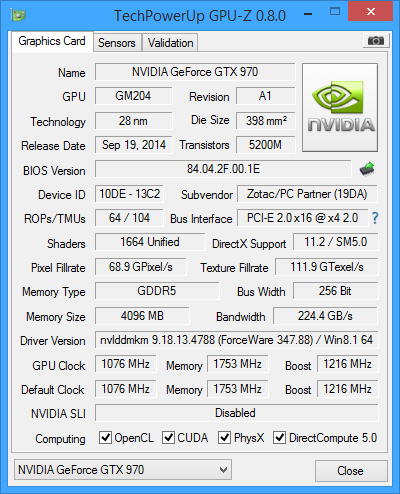

Got the new Zotac GTX 970 today, so I figured I'd run a benchmark and share my setup: PSU is an S12II 430W in case anyone was wondering. Its a little overkill but i don't want to be stuck with a random <300w PSU if i ever go full desktop I only have Unigine benches because 3Dmark doesn't like me or something. I'll fix that after I'm done with college apps I have 8gb of ram in the laptop so I have a dsdt override in place. I use setup 1.x to reallocate everything except sound/sata etc. and keep the iGPU in 32-bit space, then chainload to windows. Everything runs very smoothly, my only complaint is the coil whine on the card, which sounds like a very fast tick/click. At first I thought the fan was hitting a piece of paper, but it only whines when I'm running a game or something. Kinda loud, but I'm hoping its just a day/week 1 kind of thing. If anyone has any advice on that it'd be greatly appreciated, it gets annoying when the card is a foot away from your head.
