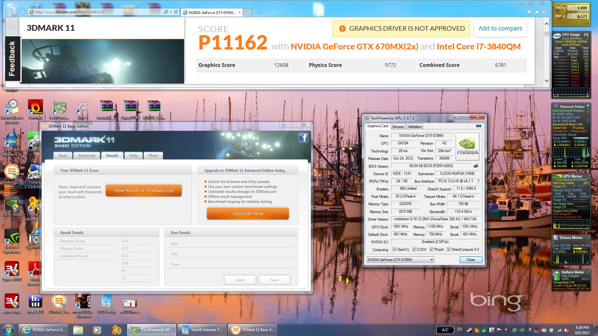

I flashed my 670MX ski with SLV7's bios last summer and they worked great, after a few driver updates over the last year I recently ran 3dmark11 and my score was much lower 12600 gpu score to 8900 now. I ran Metro: Last Light benchmarks and I noticed that after 20-30 seconds the video card was throttling like crazy based on heat points. I am still able to OC and over volt my card to the same levels as before but before there was no throttling. I have gone back to older versions of the drivers and still see throttling. Any idea what to do?

How are your temps on the 670MX? I have a Clevo P370EM with 670MX running in SLI. I am currently at 1050/1150 CPU/MEM at 1.025 and running about 75-77 degrees while gaming. Currently I get around 8350 on Firestrike graphics and 12600 on 3dmark11 graphics.
