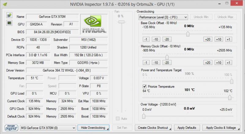

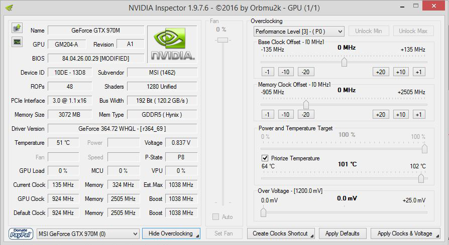

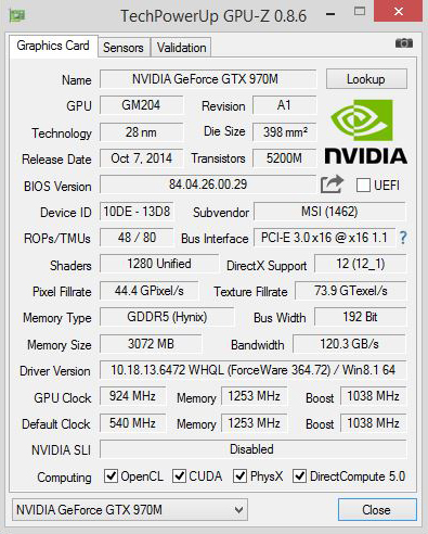

JohnBlackRider Posted April 17, 2016 Share Posted April 17, 2016 Hi all, I was reading for a couple of time about the overcloking of the NVIDIA GTX 900M series cards and I would like to have the opportunity to do that too, but I need some help. A lot of forums talks about Prema Mods for nvidia modding to get the opportunity to OC them, so I came here to find support to do that. I have a MSI laptop (GE62 2QF), all drivers up to date, vbios and bios (original), the graphic card of this pc is 'NVIDIA GeForfoce GTX 970M 3GB'. When I go to Prema's website I can't find any MSI laptop BIOSes, only for alienware and two more brands and I don't know if these BIOS files are compatibles with my laptop or GPU. I uploaded two screenshots on this reply, one about nvidia inspector and the other of gpu-z software with, I think, the regarding information than any of you could need. Thank you Link to comment Share on other sites More sharing options...
