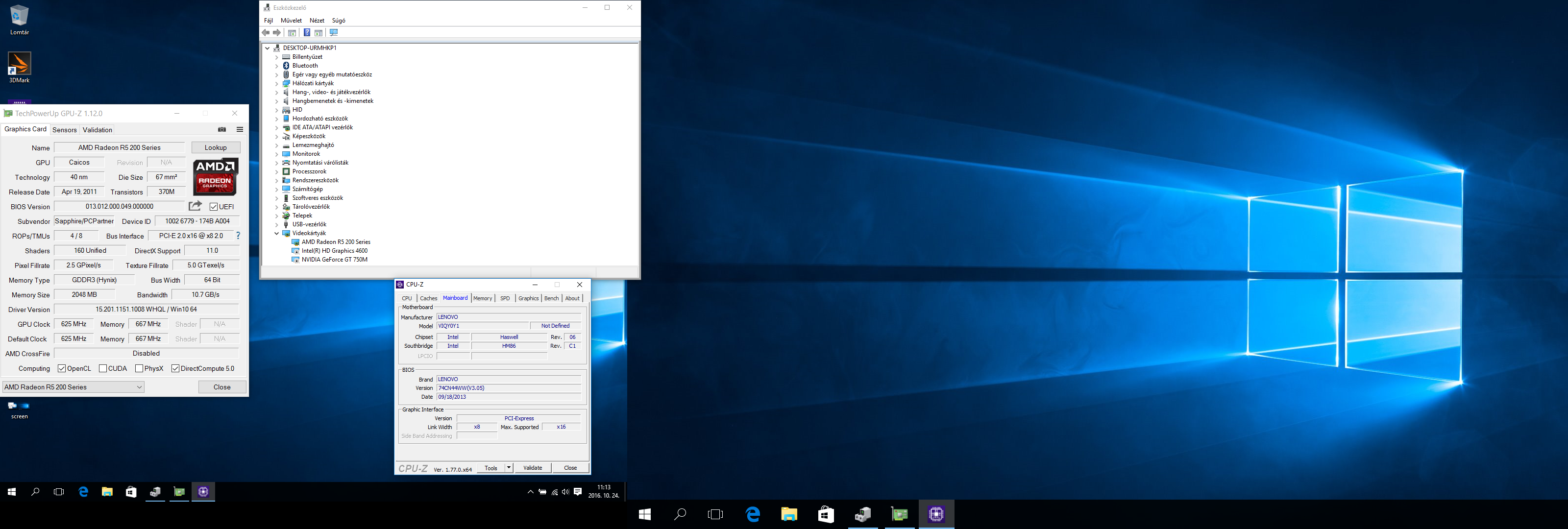

Heterodyne Posted October 24, 2016 Share Posted October 24, 2016 Well, I come bearing news. So, I finally had the time to run some tests with both AMD and NVIDIA cards. All test were under a clean Win10. 1,) With the Ultrabay whitelist removed i got the same results like with it. On 2.07 i got 30 sec reboots with black screen, on 3.05 hangs on boot with black screen. So far the whitelist is not the problem why NVIDIA cards doesn't work. 2,) For some reason the AMD card works for me on 3.05 slv7 version no problem (see screenshot), but I had to disable both the 750m and the Intel igpu, and I didn't got any 5-10 min black screens either. As you can see on the screenshot all gpu disabled except AMD on 3.05 slv7 bios. Quote Link to comment Share on other sites More sharing options...

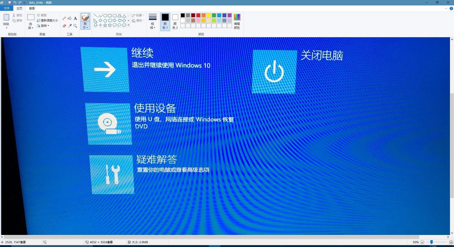

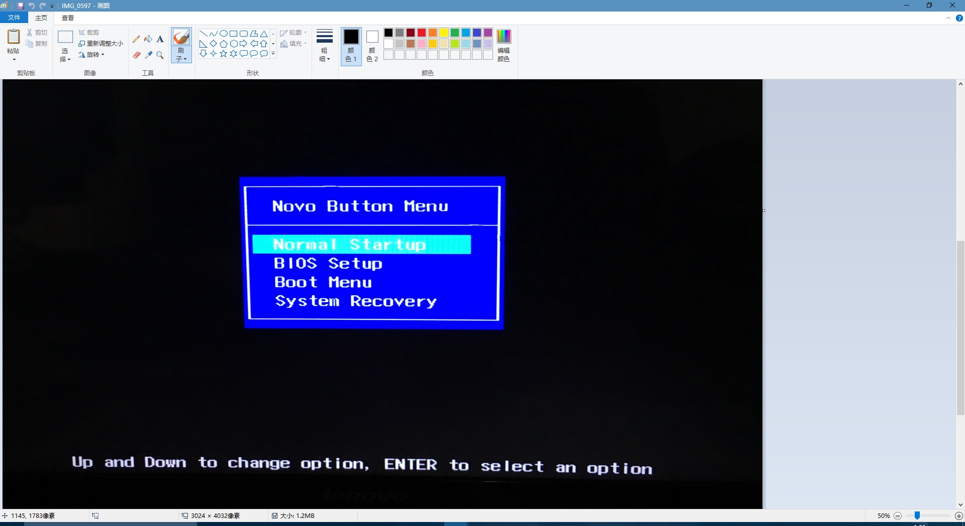

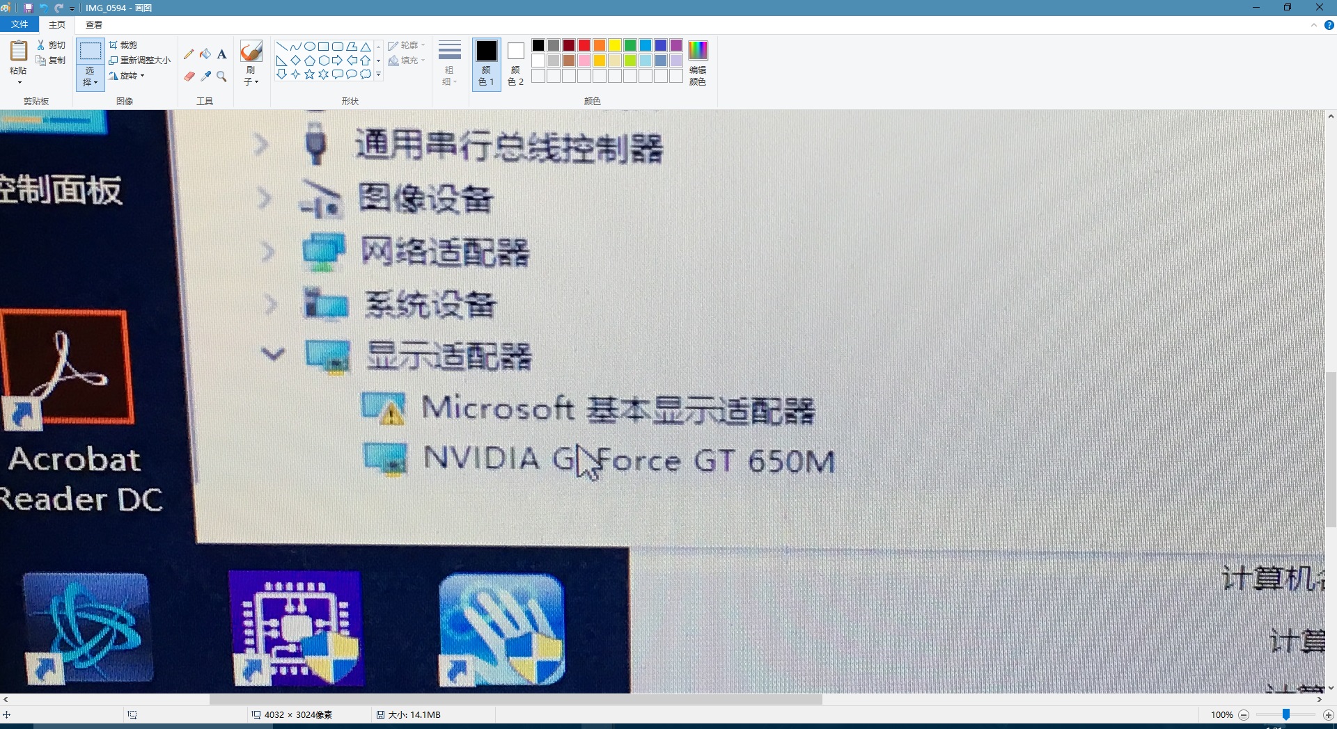

David 'SOAP' Washington Posted October 25, 2016 Share Posted October 25, 2016 (edited) Alright, mine adaptor has arrived yesterday and a new AMD RX480 arrived today. So I test it these days with two Nvidia cards and one AMD card, unfortunately ALL of them failed on my Y500(official V2.04 BIOS). But it has a totally different failure behavior on my laptop. I can even get into desktop after entering the passcode, and it shutdown itself after about 30~40sec after I power on. It totally cut down the power immediately just like what a computer acts when CPU overheating(definitely mine is not overheated at the time). And I tried my best to open the device manager and took a pic of it before it shut down itself. It recognized a basic microsoft video adaptor with an Exclamation, and I also succeed to get the detail info was "This device has no driver", but I have no time to take a photo before it shut down. Then, I plug out the PSU power, and surely the laptop started normally, so I checked the hidden device, I can find the graphic card and the monitor. So, It means that everything is OK before the shutdown. Then I check it several times in different condictions with 3 different cards, not enter the passcode, windows blue screen recovery menu, and finally the NOVO menu(press the small button with an arrow icon beside the power). In ALL condictions it shutdown itself automatically after 30~40secs after I power on. I-Display works and E-Display blackscreen(but the monitor is not in standby condition, the monitor got the signal to keep power on until the laptop shutdown). So did I get another kind of 30secs reboot issue(But mine is shutdown)? And my I-Display works because Y500 doesn't have a i-gpu enable at all and connnet the I-Display to d-gpu directly? Because of the novo button menu also shutdown automatically, I think that it must come from the firmware level but not system level or software level. @Heterodyne , Do you sure for successfully removing the blacklist? Is this different behavior useful for you to find out the trouble head? @rusTORK , you got the very same version Y500(the only difference is mine is a chinese version), plz check out whether yours works well or not and repost it soon, thanks. And Other chinese users will get the adaptors tomorrow, they will check it on v2.02, v2.03 Y4/500 and v2.07 Y4/510p soon, and I will repost soon after I got the results from them. Edited October 25, 2016 by David 'SOAP' Washington Quote Link to comment Share on other sites More sharing options...

Tesla Posted October 25, 2016 Share Posted October 25, 2016 (edited) 1 hour ago, David 'SOAP' Washington said: Alright, mine adaptor has arrived yesterday and a new AMD RX480 arrived today. So I test it these days with two Nvidia cards and one AMD card, unfortunately ALL of them failed on my Y500(official V2.04 BIOS). But it has a totally different failure behavior on my laptop. I can even get into desktop after entering the passcode, and it shutdown itself after about 30~40sec after I power on. It totally cut down the power immediately just like what a computer acts when CPU overheating(definitely mine is not overheated at the time). And I tried my best to open the device manager and took a pic of it before it shut down itself. It recognized a basic microsoft video adaptor with an Exclamation, and I also succeed to get the detail info was "This device has no driver", but I have no time to take a photo before it shut down. Then, I plug out the PSU power, and surely the laptop started normally, so I checked the hidden device, I can find the graphic card and the monitor. So, It means that everything is OK before the shutdown. Then I check it several times in different condictions with 3 different cards, not enter the passcode, windows blue screen recovery menu, and finally the NOVO menu(press the small button with an arrow icon beside the power). In ALL condictions it shutdown itself automatically after 30~40secs after I power on. I-Display works and E-Display blackscreen(but the monitor is not in standby condition, the monitor got the signal to keep power on until the laptop shutdown). So did I get another kind of 30secs reboot issue(But mine is shutdown)? And my I-Display works because Y500 doesn't have a i-gpu enable at all and connnet the I-Display to d-gpu directly? Because of the novo button menu also shutdown automatically, I think that it must come from the firmware level but not system level or software level. @Heterodyne , Do you sure for successfully removing the blacklist? Is this different behavior useful for you to find out the trouble head? @rusTORK , you got the very same version Y500(the only difference is mine is a chinese version), plz check out whether yours works well or not and repost it soon, thanks. And Other chinese users will get the adaptors tomorrow, they will check it on v2.02, v2.03 Y4/500 and v2.07 Y4/510p soon, and I will repost soon after I got the results from them. I just want to know something for sure, Does it cut the power when you say "shutdown" or the Windows shuts down regularly? I had a similar symptoms when I tried the nvidia cards on my y510p but with a black screen and laptop failed to post. unfortunately i dont have a Y500 to test on but I can imagine it could be either a bios thing or more probably some kind of a protection circuit that is kicking on. Edited October 25, 2016 by Tesla Quote Link to comment Share on other sites More sharing options...
David 'SOAP' Washington Posted October 26, 2016 Share Posted October 26, 2016 (edited) 6 hours ago, Tesla said: I just want to know something for sure, Does it cut the power when you say "shutdown" or the Windows shuts down regularly? I had a similar symptoms when I tried the nvidia cards on my y510p but with a black screen and laptop failed to post. unfortunately i dont have a Y500 to test on but I can imagine it could be either a bios thing or more probably some kind of a protection circuit that is kicking on. Unfortunately, it cuts the power, as I said so, it even shutdown when I kept staying in Novo Button Menu without doing anything. At that time, windows or any other System/Software Level program should not started yet. So, it must be something on Firmware Level caused shutdown in 30s. And within 30s, everything seems to be alright, windows recognized a basic microsoft video adaptor and also one more display, this is what it should be without installing a driver for the graphic card, isn't it? So all I can do at this time is waiting for others to try it on different version BIOS until someone findout a useful version? Edited October 26, 2016 by David 'SOAP' Washington Quote Link to comment Share on other sites More sharing options...
David 'SOAP' Washington Posted October 26, 2016 Share Posted October 26, 2016 On 2016/10/24 at 5:40 PM, Heterodyne said: Well, I come bearing news. So, I finally had the time to run some tests with both AMD and NVIDIA cards. All test were under a clean Win10. 1,) With the Ultrabay whitelist removed i got the same results like with it. On 2.07 i got 30 sec reboots with black screen, on 3.05 hangs on boot with black screen. So far the whitelist is not the problem why NVIDIA cards doesn't work. 2,) For some reason the AMD card works for me on 3.05 slv7 version no problem (see screenshot), but I had to disable both the 750m and the Intel igpu, and I didn't got any 5-10 min black screens either. As you can see on the screenshot all gpu disabled except AMD on 3.05 slv7 bios. Hi, According to your screenshot, it seems to be two different resolution display. Is the smaller one the Integrated Display and the bigger one the e-display? Does the integrated display work eventhough disabled the integrated graphics card? What happens when you didn't disable them? Hangs on boot? 30sec reboot? or 30 sec shutdown like mine? Did you open the start up sound in windows settings? Could you plz recheck the windows start up sound to make sure does your laptop really hangs on boot or it just did't display any thing on the dispaly? And also recheck has windows started before 30 sec reboot? ; And, one more Question for Any other users who succeed to start up normally, can your laptop read out the E-GPU's temp and fan speed? Does this the reason? I cannot find out any other reasonable things can shutdown the laptop like this. Or Lenovo DO did some tricks to detect the e-gpu and shutdown deliberately......What about other PCI-e devices? PCI-e SSD, network adaptor, or etc? Did them cause the trouble? Quote Link to comment Share on other sites More sharing options...

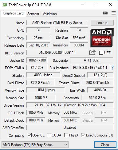

Heterodyne Posted October 26, 2016 Share Posted October 26, 2016 4 hours ago, David 'SOAP' Washington said: Hi, According to your screenshot, it seems to be two different resolution display. Is the smaller one the Integrated Display and the bigger one the e-display? Does the integrated display work eventhough disabled the integrated graphics card? What happens when you didn't disable them? Hangs on boot? 30sec reboot? or 30 sec shutdown like mine? Did you open the start up sound in windows settings? Could you plz recheck the windows start up sound to make sure does your laptop really hangs on boot or it just did't display any thing on the dispaly? And also recheck has windows started before 30 sec reboot? ; And, one more Question for Any other users who succeed to start up normally, can your laptop read out the E-GPU's temp and fan speed? Does this the reason? I cannot find out any other reasonable things can shutdown the laptop like this. Or Lenovo DO did some tricks to detect the e-gpu and shutdown deliberately......What about other PCI-e devices? PCI-e SSD, network adaptor, or etc? Did them cause the trouble? The smaller screen is the external one, it's and old 4:3 monitor I had lying around. I had to disable the igpu because every program kept using it instead of the AMD gpu. The internal screen works even if I disable the igpu, but that just the matter of how ju set up multiple displays. With igpu disabled the internal screen works as a secondary screen. No, with AMD gpu I didn't encounter any problem, it even works for me with 3.05 bios, it was plug and play basically. Only NVIDIA cards aren't working, which has nothing to with the whitelist, and I am sure I removed it because its similar to the wlan/wifi whitelist, and it doesn't boot into windows, with 2.07 it reboots with 30sec intervals and with 3.05 it just hangs. Quote Link to comment Share on other sites More sharing options...
David 'SOAP' Washington Posted October 26, 2016 Share Posted October 26, 2016 9 minutes ago, Heterodyne said: The smaller screen is the external one, it's and old 4:3 monitor I had lying around. I had to disable the igpu because every program kept using it instead of the AMD gpu. The internal screen works even if I disable the igpu, but that just the matter of how ju set up multiple displays. With igpu disabled the internal screen works as a secondary screen. No, with AMD gpu I didn't encounter any problem, it even works for me with 3.05 bios, it was plug and play basically. Only NVIDIA cards aren't working, which has nothing to with the whitelist, and I am sure I removed it because its similar to the wlan/wifi whitelist, and it doesn't boot into windows, with 2.07 it reboots with 30sec intervals and with 3.05 it just hangs. It means that you haven't hear the windows start up sound both in 30 secs reboot and hangs condition? This Y-series even doesn't have a HDD LED. So, any idea or thoughts of what caused the 30 sec shutdown? It's not a BIOS issue? Can yours read out the E-GPU's temp and fan speed? Or do you have any other non-graphics card to have a try? Quote Link to comment Share on other sites More sharing options...
Heterodyne Posted October 26, 2016 Share Posted October 26, 2016 1 hour ago, David 'SOAP' Washington said: It means that you haven't hear the windows start up sound both in 30 secs reboot and hangs condition? This Y-series even doesn't have a HDD LED. So, any idea or thoughts of what caused the 30 sec shutdown? It's not a BIOS issue? Can yours read out the E-GPU's temp and fan speed? Or do you have any other non-graphics card to have a try? It's definitely a BIOS issue, but I have no idea what's the cause. Quote Link to comment Share on other sites More sharing options...
gerald Posted October 26, 2016 Author Share Posted October 26, 2016 8 hours ago, David 'SOAP' Washington said: Hi, According to your screenshot, it seems to be two different resolution display. Is the smaller one the Integrated Display and the bigger one the e-display? Does the integrated display work eventhough disabled the integrated graphics card? What happens when you didn't disable them? Hangs on boot? 30sec reboot? or 30 sec shutdown like mine? Did you open the start up sound in windows settings? Could you plz recheck the windows start up sound to make sure does your laptop really hangs on boot or it just did't display any thing on the dispaly? And also recheck has windows started before 30 sec reboot? ; And, one more Question for Any other users who succeed to start up normally, can your laptop read out the E-GPU's temp and fan speed? Does this the reason? I cannot find out any other reasonable things can shutdown the laptop like this. Or Lenovo DO did some tricks to detect the e-gpu and shutdown deliberately......What about other PCI-e devices? PCI-e SSD, network adaptor, or etc? Did them cause the trouble? Reading the eGPU temperature and the fan speed should work. I'm using the AMD driver Crimson 16.9.2 and a AMD R9 Nano. I have disabled all other graphic hardware in the device manager. Quote Link to comment Share on other sites More sharing options...

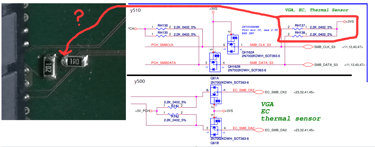

David 'SOAP' Washington Posted October 27, 2016 Share Posted October 27, 2016 (edited) @gerald @Heterodyne @Tesla @others Thanks at first, and I'm here again with both good news and, of couse, bad news. The good news is that both two Y510p we got works just fine with A-Card(still doesn't get any N-Card or other pci-e device to make a further test on them), 2.07 and even 3.05! And they tell me that the 3.05 even have an option to disable the D-GPU in the BIOS which will stop windows to recognize the D-GPU at all, and this can avoid a I-Display "screen freeze bug" when rebooting the windows. Of couse, the bad news is that all of the Y400/500s failed including mine. Most of us have a Y400/500, that means only two mentioned above succeed. We tested it on 3 different version BIOS Y400/500s, 2.02, 2.03 and 2.04. All of them got the same symptoms jusk like I mentioned before, the "30~40 secs shutdown". No matter what you do, the deadline countdown starts at the time once you pressed down the power button(Soft Reboots at windows 10 blue screen menu doesn't reset the countdown). @Tesla So by now, there's two of 3.05 Y510p succeed(including Heterodyne's). Are you interested in rechecking why 3.05 doesn't works on your laptop again? Maybe you can get the real point meanwhile and help us. Or any advice for us? Is it the only way that we have to flash every version BIOS to make a try? As official version 2.02~2.04 failed, the only left and what we can find is 1.05. Does SLV7's crack BIOS 2.02~2.04 worth an additional try? Or any advice for avoiding bricking the laptop during flashing? Did you flash them under DOS or exe in windows or even chip programer directly? And as for 3.05 is now MAY work but not CANNOT work and @Heterodyne said that it seems nothing to deal with the whitelist in BIOS, are we started at a wrong direction? What does EC effect in the whole system? Heterodyne seems to be the only one among us who is experienced in modding BIOS level, @Heterodyne according to what you know, what else do you think can cause this shutdown if it is not the BIOS itself at all? EC, Thermal Sensor or anything else? Or we just not findout what tricks have Lenovo done yet. Which is more reasonable? Could you make a whitelist removed BIOS for Y400/Y500 for us to make a try? It seems OK for a Chinese version laptop motherboard to flash a worldwide version BIOS after one of us tried to do so and succeed on Y510p(2.07). @gerald One of us findout that the Y500 circuit diagram maybe a little different from Y510p?(See below)(Only thoughts cuz we are not professional) Are these two chip resistor the things circled in the circuit diagram? Did them have to be removed to adapt a Y500? And what other chip resistors designed on PCB are used for? Did they missed or have to be removed for a Y500? If you can take some time to recheck the differences between the Y500 and Y510p in circuit diagram to make a sure that is this PCB design suitable for a Y500 or not, would be very nice. I know that this adaptor isn't designed for a Y500 at a very begining and you never guaranteed that it works well on a Y400/500, but we do need your help now too. @rusTORK Have you repired your laptop yet? I missed you so well. So, the point now in brief is that this adaptor may not suitable for a Y400/500. I may a little experienced about knowing what does windows or others software should be, or may be able to flash BIOS to an existed BIOS ROM, but as for a hardware error or BIOS level issue, I'd rather say that I'm a totally noob or even can't say I'm a noob cuz I have no idea about them, it's far more beyond my knowledge. By now the only thing I can do may just guess and try blindly. Anyone who's more experienced plz help. (I got more than 30 users who is interested in this adaptor gathered in an instant messaging group chat by now, more than 2/3 of us have a Y400/500. The older model Y400/500 goes out of date first, and the users are more eager to update it, isn't it. And most users of Lenovo is in china, isn't. Got crowds to be saved.) Edited October 27, 2016 by David 'SOAP' Washington Quote Link to comment Share on other sites More sharing options...
Tesla Posted October 28, 2016 Share Posted October 28, 2016 (edited) @David 'SOAP' Washington Heterodyne's y510p is different than ours (Manystrongwords, Gerald and me). Now as for the 3.05 bios (model of y510p w/pcie3.0), I already checked it extensively before -with slv7 mod and without- and in both cases it gave me an error msg "remove the adapter...blah bla". I tried to mess with the advanced display settings in slv7 mod and I almost bricked my y510p (in fact I completely bricked it by setting the display to the external pcie lol) but was able to restore it back thanks to team viewer, I was able to reflash older version remotely. I tried the version 1.05 and it didn't not work. Now for the slv7 mod on 2.07/2.04 that will help you out if you've replaced your wifi card. and that is what im running at the mean time (2.07 slv7) but the whitelist has nothing to do with the external graphics card. I don't encourage you to mess with the bios a lot as it can be bricked. If you really want to, then at least buy some spare bios chips in case something goes wrong. I've confirmed for the y510p that both 2.04 and 2.07 work well with the adapter. Edited October 28, 2016 by Tesla Quote Link to comment Share on other sites More sharing options...
