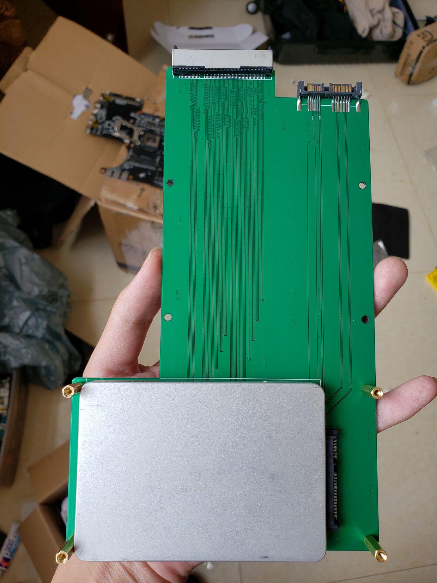

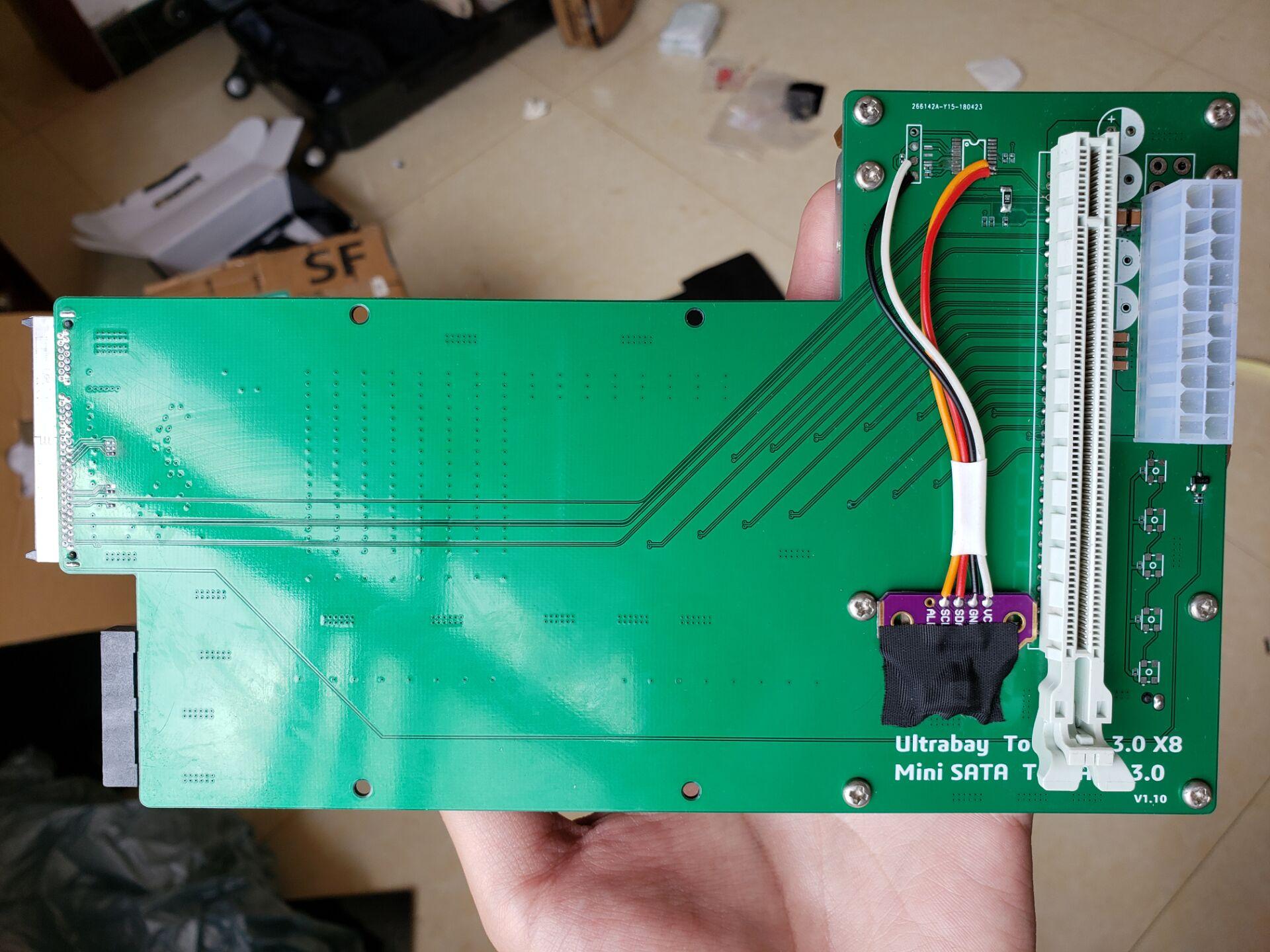

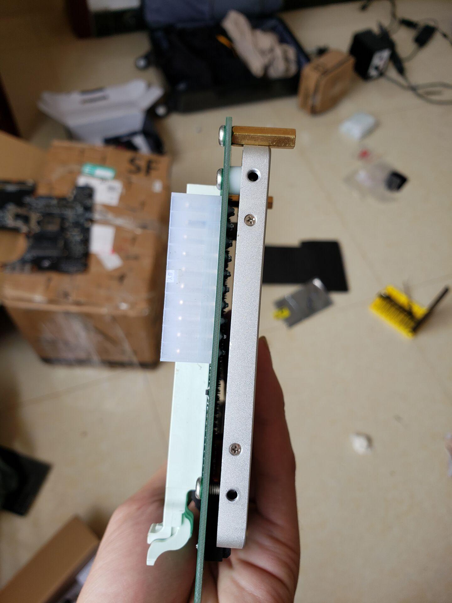

Swung Huang Posted August 7, 2019 Share Posted August 7, 2019 Hi everybody! I'm working on a new adapter now! Now it's Plug-n-play and won't need a modified BIOS. 1 Quote Link to comment Share on other sites More sharing options...
Swung Huang Posted August 7, 2019 Share Posted August 7, 2019 Some other pics Quote Link to comment Share on other sites More sharing options...
IronWolf0117 Posted August 8, 2019 Share Posted August 8, 2019 31 minutes ago, Swung Huang said: Hi everybody! I'm working on a new adapter now! Now it's Plug-n-play and won't need a modified BIOS. Should there be any significant differences between using this new one with an unmodded bios VS if we have the older one with a modded bios? Or is it just for the convenience of not needing to flash a modded bios? Btw, I successfully received my adapter and am in the process of setting it up. Thanks again for carrying on where Gerald left off and making further advancements on these! Quote Link to comment Share on other sites More sharing options...
Swung Huang Posted August 8, 2019 Share Posted August 8, 2019 16 minutes ago, IronWolf0117 said: Should there be any significant differences between using this new one with an unmodded bios VS if we have the older one with a modded bios? Or is it just for the convenience of not needing to flash a modded bios? Btw, I successfully received my adapter and am in the process of setting it up. Thanks again for carrying on where Gerald left off and making further advancements on these! There are 2 major modification from the old one. a. It now integrate the SATA wiring onto the PCB. b.It now uses the aforementioned hardware mod to make it Plug'n'play without a BIOS mod. But if you get your previous version up and running, it should behave the same as the new one. Also, the pics here is still a testing sample. I want to make the finished one just have a simple chip soldered on the board to do the trick instead of such loose jumping wires. Quote Link to comment Share on other sites More sharing options...
