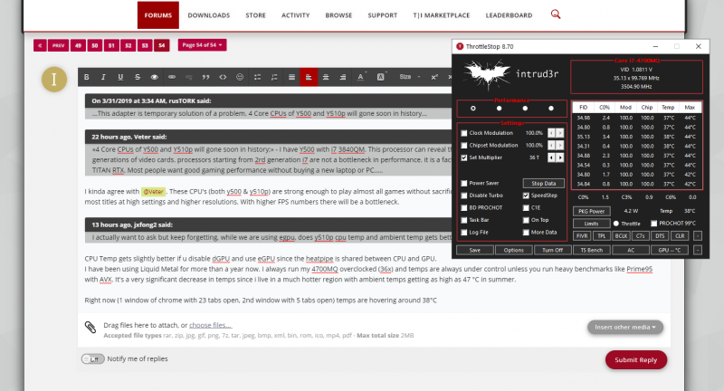

intruder Posted April 1, 2019 Share Posted April 1, 2019 On 3/31/2019 at 3:34 AM, rusTORK said: ...This adapter is temporary solution of a problem. 4 Core CPUs of Y500 and Y510p will gone soon in history... 22 hours ago, Veter said: «4 Core CPUs of Y500 and Y510p will gone soon in history;» - I have Y500 with i7 3840QM. This processor can reveal the potential of new video cards and also of the next two or three generations of video cards. processors starting from 2rd generation i7 are not a bottleneck in performance. it is a fact. Besides, no one here seeks to get a system of 4 videocards TITAN RTX. Most people want good gaming performance without buying a new laptop or PC..... I kinda agree with @Veter. These CPU's (both y500 & y510p) are strong enough to play almost all games without sacrificing much performance provided the GPU is good enough to play most titles at high settings and higher resolutions. With higher FPS numbers there will be a bottleneck. 13 hours ago, jxfong2 said: I actually want to ask but keep forgetting, while we are using egpu, does y510p cpu temp and ambient temp gets better? How much is your system temp? CPU Temp gets slightly better if u disable dGPU and use eGPU since the heatpipe is shared between CPU and GPU. I have been using Liquid Metal for more than a year now. I always run my 4700MQ overclocked (36x) and temps are always under control unless you run heavy benchmarks like Prime95 with AVX. It's a very significant decrease in temps since i live in a much hotter region with ambient temps getting as high as 47 °C in summer. Right now with 1 window of chrome with 23 tabs open, 2nd window with 5 tabs open, temps are hovering around 37-38°C (18°C ambient temperature). Quote Link to comment Share on other sites More sharing options...

intruder Posted April 1, 2019 Share Posted April 1, 2019 1 hour ago, rusTORK said: Y500 (at least my) have got problem of CPU thermal throttle. I saw somewhere here, that it's because of EC (what's this?).... Cooling system is really pathetic in lenovo ideapad series. You simply can't do anything to get rid of throttling. Thermal throttling can be reduced though. Thermal throttle is inevitable due to: 1. Bad stock thermal paste 2. Heatsink not being flat on the die 3. GPU and CPU heatsink combined. 4. No VRM cooling First and second can be solved using good quality highly conductive thermal paste and re-aligning heat sink. Heat sink can be adjusted using washer mod, bending it slightly (careful here) and lapping. I did all the above and it's been more than a year since i've opened up my laptop's heatsink and temps are same as i was getting back then. Third issue however cannot be solved so easily. It'll require custom made heat sink. The contact between GPU die and heatsink is also horrible. Since i am now using eGPU, i don't have to worry about it. Those idiots placed VRM directly below the heasink. Right now you cannot increase the TDP but even if you are able to do it, VRM throttling will start. There's no way to cool VRM's in the current design. There's are other ways the CPU can throttle ofcourse. Like, EDP current limit. It cannot be changed and one reason why upgrading CPU won't help. 1 hour ago, rusTORK said: ...If GPU is 53°C (or more) then CPU got signal to lower it's core frequency from highest (3.2 GHz probably) to 2.4 GHz... I have read about it but never encountered it. Are you using ThrottleStop? If not then try it. It's a godsent program to help with a lot of throttling woes. 1 hour ago, rusTORK said: ...I have plans to install thermostat mod on CPU fan, but it will take time to get proper thermostat. But i hope it will help (when thermostat detect 50-55°C on GPU heatpipe it will break CPU fan pwm wire and it's start to spin on full speed).... That could help. Make sure you remove the grill mesh dust filter on the bottom of the laptop for more fan efficiency. I personally use ideafan. I only run it when gaming, other times the laptop is silent anyway. I'd love to mod a switch to run the fan at full speed but dont get much time for that. 1 hour ago, rusTORK said: ...P.S. I am currently use Graphite pad on both CPU and GPU as experimental.. From what i heard it doesn't do a very good job. I'd rather suggest Conductonaut (as i'm using it) but it's very risky if not done properly. 1 hour ago, rusTORK said: ..Another problem i faced, that sometime i have got cap of 60 FPS at Vally benchmark (with GTX 1080 Ti !). That's weird. Have you tinkered with any nvidia control panel settings? Quote Link to comment Share on other sites More sharing options...

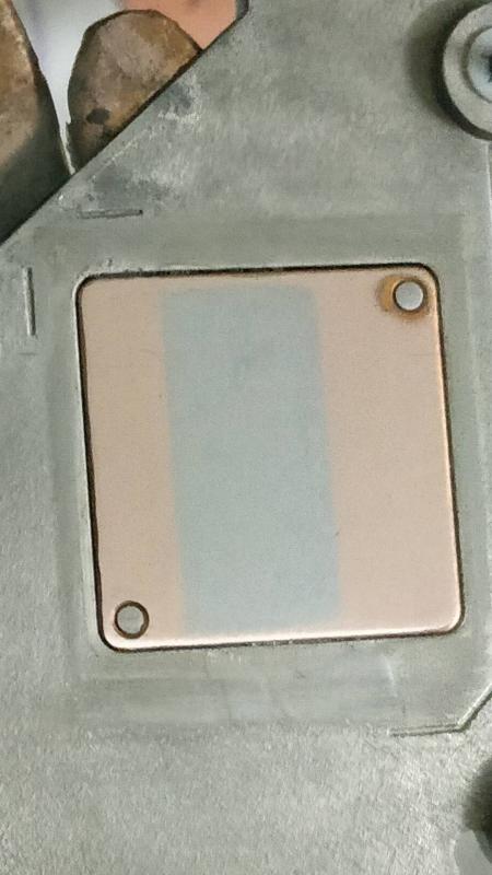

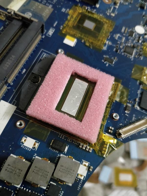

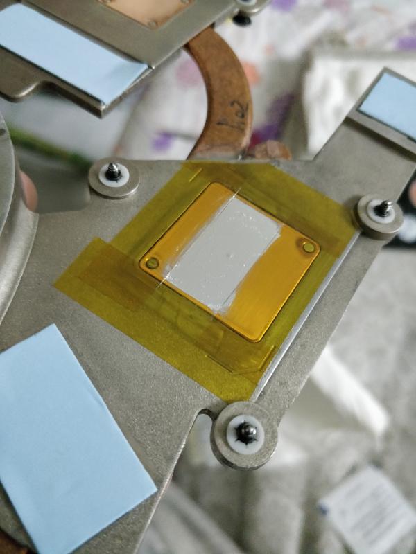

intruder Posted April 1, 2019 Share Posted April 1, 2019 4 minutes ago, Veter said: Please share the results after testing Grizzly Carbonaut. My results for use of 2 LM: ЖМ-6 and Coollaboratory liquid pro: at first, everything very COOL, but after 6 months the temperature has become higher than cheap thermal grease. I disassembled the laptop: the metal crystallized on the CPU, the heel of the copper radiator received two small holes and LM penetrated into the entire top layer of copper. Perhaps in the composition of copper radiators there is some kind of impurity, due to which the liquid metal crystallizes. There is opinion: nickel radiator surface and cpu ceramic surfaces are suitable for LM. But in my Y500 I have copper radiator( The reason why you saw crystallization is due to gaps between heatsink and cpu die which allowed air to go into the system. As long as there's no gap (airtight fitting), LM will never dry out. The heatsink needs to be fully flat against the die with even pressure to use LM otherwise everything can go wrong. Copper heatsinks are good when it comes to LM. LM penetrates into copper surface but it doesn't in any way hamper the heat conduction. It's more like a stain that won't go away but doesn't affect performance. Aluminium heat sinks on the other hand should never be used with LM. You are getting bad results with LM like most people simply because of bad application. If applied correctly you don't ever have to worry about it. I've thrown my laptop around, carry it almost everyday on a motorbike, all the things you can imagine would make LM leak but it never happened to me. Quote Link to comment Share on other sites More sharing options...
Veter Posted April 1, 2019 Share Posted April 1, 2019 4 minutes ago, intruder said: The reason why you saw crystallization is due to gaps between heatsink and cpu die which allowed air to go into the system. As long as there's no gap (airtight fitting), LM will never dry out. The heatsink needs to be fully flat against the die with even pressure to use LM otherwise everything can go wrong. Copper heatsinks are good when it comes to LM. LM penetrates into copper surface but it doesn't in any way hamper the heat conduction. It's more like a stain that won't go away but doesn't affect performance. Aluminium heat sinks on the other hand should never be used with LM. You are getting bad results with LM like most people simply because of bad application. If applied correctly you don't ever have to worry about it. I've thrown my laptop around, carry it almost everyday on a motorbike, all the things you can imagine would make LM leak but it never happened to me. "As long as there's no gap" - And how did you do it? Quote Link to comment Share on other sites More sharing options...
intruder Posted April 1, 2019 Share Posted April 1, 2019 1 minute ago, Veter said: "As long as there's no gap" - And how did you do it? Already posted above: 51 minutes ago, intruder said: ....Thermal throttle is inevitable due to: 1. Bad stock thermal paste 2. Heatsink not being flat on the die 3. GPU and CPU heatsink combined. 4. No VRM cooling First and second can be solved using good quality highly conductive thermal paste and re-aligning heat sink. Heat sink can be adjusted using washer mod, bending it slightly (careful here) and lapping. I did all the above and it's been more than a year since i've opened up my laptop's heatsink and temps are same as i was getting back then... Image if you're curious: As you can see i was very careful not letting LM touch the surrounding aluminium heat sink. This was the first time i applied LM. ^ This is after a month of use. The grey area you see is LM penetrating copper which is only at the surface and can be sanded off. The way i did it is applied LM first time, used it for a month, reopened heat sink assembly, sanded off copper shim (the pic above) and applied LM again. LM won't continuously invade copper forever, like i said it only happens at the surface (a couple microns). I was pretty careful to prevent any leaks just in case: I did not mean to be offensive but people tend to treat LM like any other thermal paste and ended up killing the motherboard and then say it doesn't work and not worth it. Anyway, if you're or any other individual reading this want to try out Liquid Metal, I'd say do as much research as you can, ask questions so people with experience can help. Otherwise stay away from it. Quote Link to comment Share on other sites More sharing options...
Tesla Posted April 2, 2019 Share Posted April 2, 2019 Im running the 4700mq at 4.1ghz w/ LM. I regret not doing this from the start years ago. Simple put the cpu is running to its limits without throttling or over heating. In fact it stays relatively cool, mid 60s during gaming and mid 80s when being stressed out on all cores while pulling around 45 to 54w. Quote Link to comment Share on other sites More sharing options...
intruder Posted April 2, 2019 Share Posted April 2, 2019 (edited) 9 hours ago, Tesla said: Im running the 4700mq at 4.1ghz w/ LM. I regret not doing this from the start years ago. Simple put the cpu is running to its limits without throttling or over heating. In fact it stays relatively cool, mid 60s during gaming and mid 80s when being stressed out on all cores while pulling around 45 to 54w. I vaguely remember doing that but i stopped as our systems are not meant to handle that kind of speed since it draws too much power. You can't run continuously at higher TDP (54-57W) since it creates issues. I've had a lot of issues in the past because of this. One reason i remember is that the power connector on the motherboard was burned (the female end of the power cable, no damage to the pins on motherboard though, lucky i guess). I don't have any other personal laptop and that's why i try not to do anything that might damage it. So yeah even without thermal throttling, there's nothing to be done to increase the performance in the long run. It's a design flaw. Also, i remember you doing research for replacing the display panel on your y510p. Have you found anything on that? EDIT: Just now remembered that microcode bug. Edited April 2, 2019 by intruder Quote Link to comment Share on other sites More sharing options...
Tesla Posted April 2, 2019 Share Posted April 2, 2019 actually it depends on your chip, mine is doing 3.9 4c, 4.1 on 2 cores with increasing the voltage offset by +10mV only. and 4.1 on all cores with +46mV. which is not a lot. now if i go to 4.2 or 4.3 it would require +200mV which is insane. However with those speeds and my normal use of PC everything feels snappier. and it doesnt consume that much more power. and the bios does power throttle the chip back to 3.4 once power draw exceeds 55W-57W which is something you will never hit with gaming+multitasking. so i guess its not all bad if u know what you're doing and +600mhz does make a difference on an old chip. Quote Link to comment Share on other sites More sharing options...
intruder Posted April 2, 2019 Share Posted April 2, 2019 2 minutes ago, Tesla said: actually it depends on your chip, mine is doing 3.9 4c, 4.1 on 2 cores with increasing the voltage offset by +10mV only. and 4.1 on all cores with +46mV. which is not a lot. now if i go to 4.2 or 4.3 it would require +200mV which is insane. However with those speeds and my normal use of PC everything feels snappier. and it doesnt consume that much more power. and the bios does power throttle the chip back to 3.4 once power draw exceeds 55W-57W which is something you will never hit with gaming+multitasking. so i guess its not all bad if u know what you're doing and +600mhz does make a difference on an old chip. Ok now i'm intrigued. Can you tell me which microcode version you used? Did you edit BIOS to add the buggy microcode? Quote Link to comment Share on other sites More sharing options...

Veter Posted April 2, 2019 Share Posted April 2, 2019 21 hours ago, intruder said: Heat sink can be adjusted using washer mod, bending it slightly (careful here) and lapping. This is called accuracy. I did everything neatly. Metal only concerned copper and processor. The radiator was attached to the processor over the entire area. And over the whole area there were crystals. I thought you could tell me about the method of isolating metal from air. Your way in NO way isolates metal from air. Sooner or later it crystallizes. To be honest, you are the first living person who has not encountered the problem of crystallization. 22 hours ago, intruder said: LM will never dry out It can't dry out )) this is metal. it reacts with copper (the gray mark is the reaction). that is, one of the LM components is absorbed into copper (LM is a mixture of several metals) and the rest of the substance begins to change its properties. including crystallization. heating in this case speeds up the process. On my working laptop (not Y500) LM worked for more than 18 months, because I do not play on it and do not do overclocking. Thus, the laptop worked most of the time with medium or low temperatures. What is your processor model 22 hours ago, intruder said: LM won't continuously invade copper forever I am not interested in copper. The radiator works well with grinding and without grinding. I speak only about the fact that LM is an unfinished product. 22 hours ago, intruder said: I did not mean to be offensive You shared your experience. I shared mine. You may consider yourself smart. It does not affect anything Quote Link to comment Share on other sites More sharing options...
