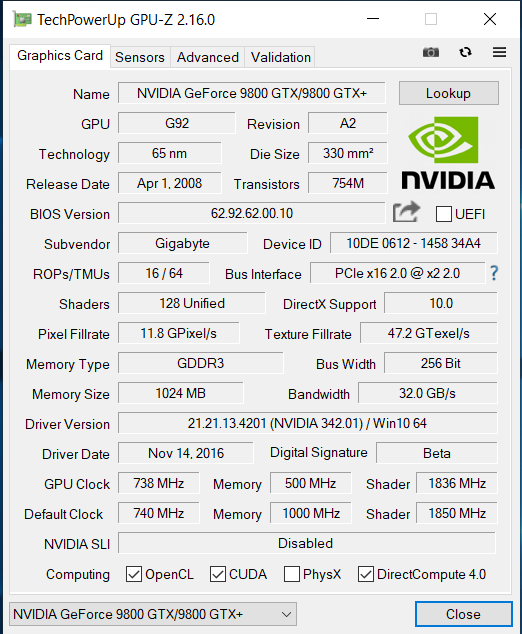

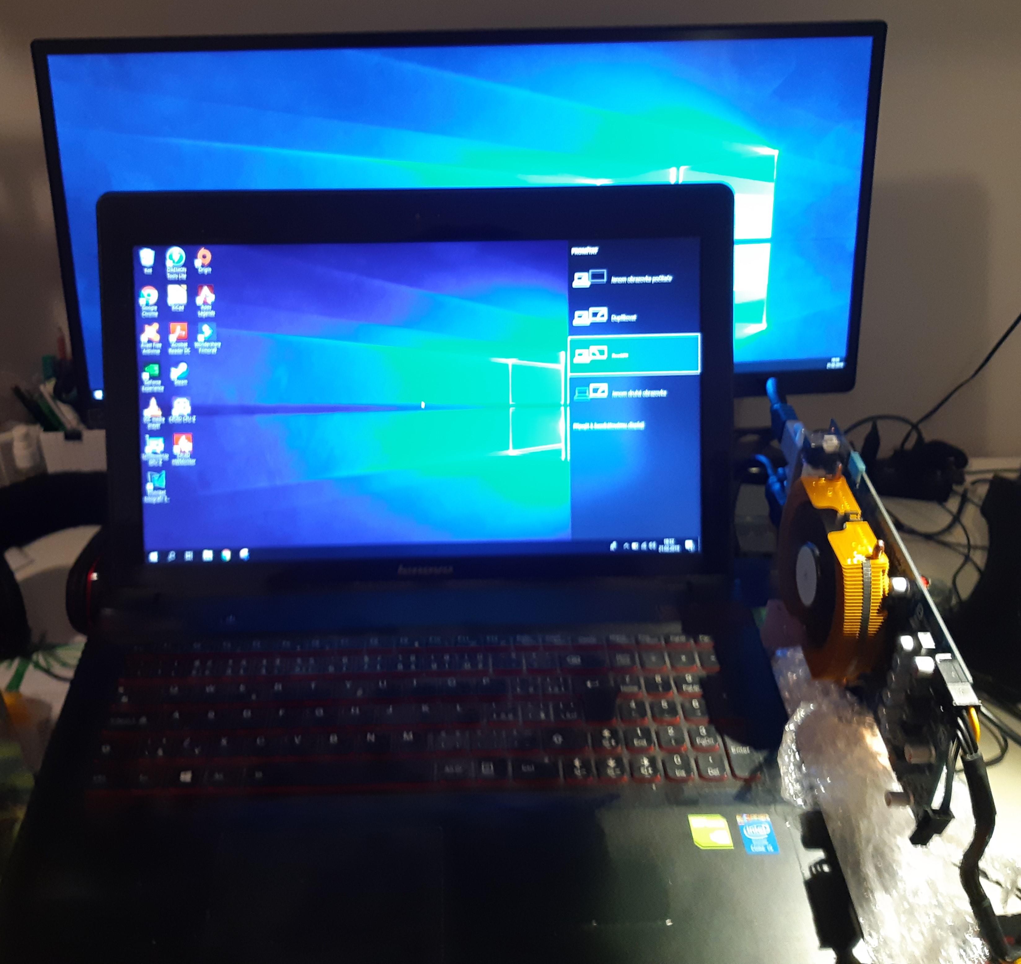

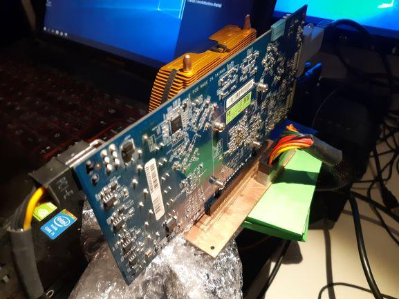

Hello guys,
I have some good news :) My adapter is finally working :D Here are some screens and photos. I will add more as soon I get better GPU. GPU-Z output is somehow wrong in some info, but I think it is caused by old GPU.
If I count material only I spend something about 50 EUR. Plus lot of work :D Yes, I agree my next approach is to make some kind of case for it and also I would like to do better version with cable extension to put it somewhere away from laptop.

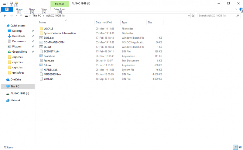

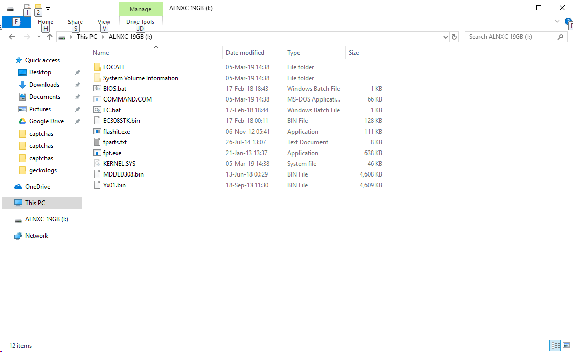

_
These are the contents of the Pen Drive
