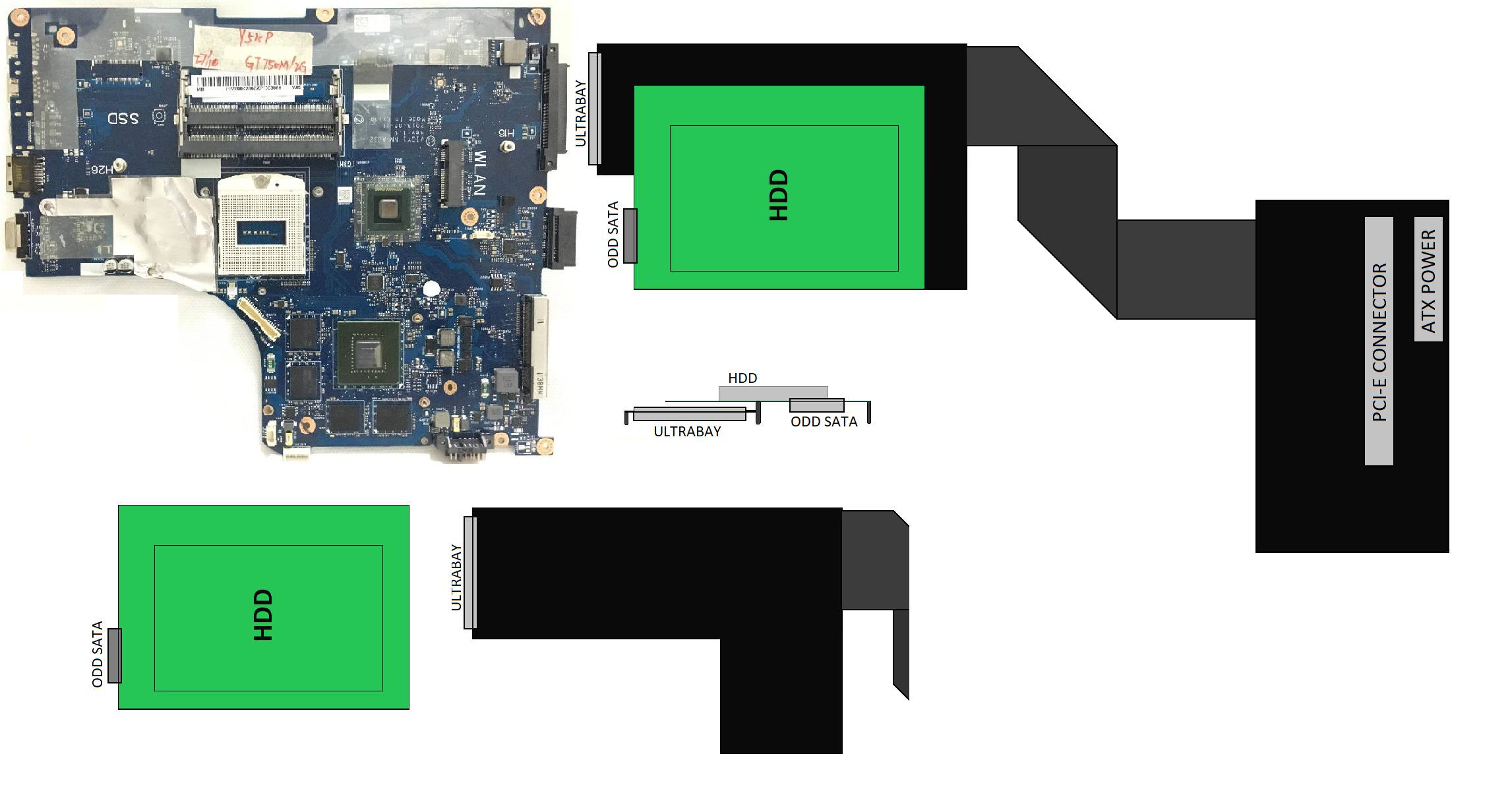

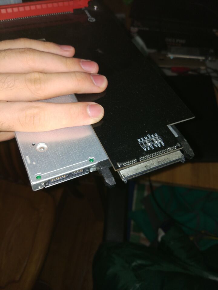

Just to make sure you understand what I said, I was thinking if it was possible to have the 2nd drive inside the ultrabay slot, and your eGPU Ultrabay adaptor to be connected on the outside, Like this example (just to illustrate), where the mPCI is outside:
This way I would kill 3 rabbits with just one shot (2nd internal SSD, eGPU support and a Plug-in adapter)
Thank you mister!

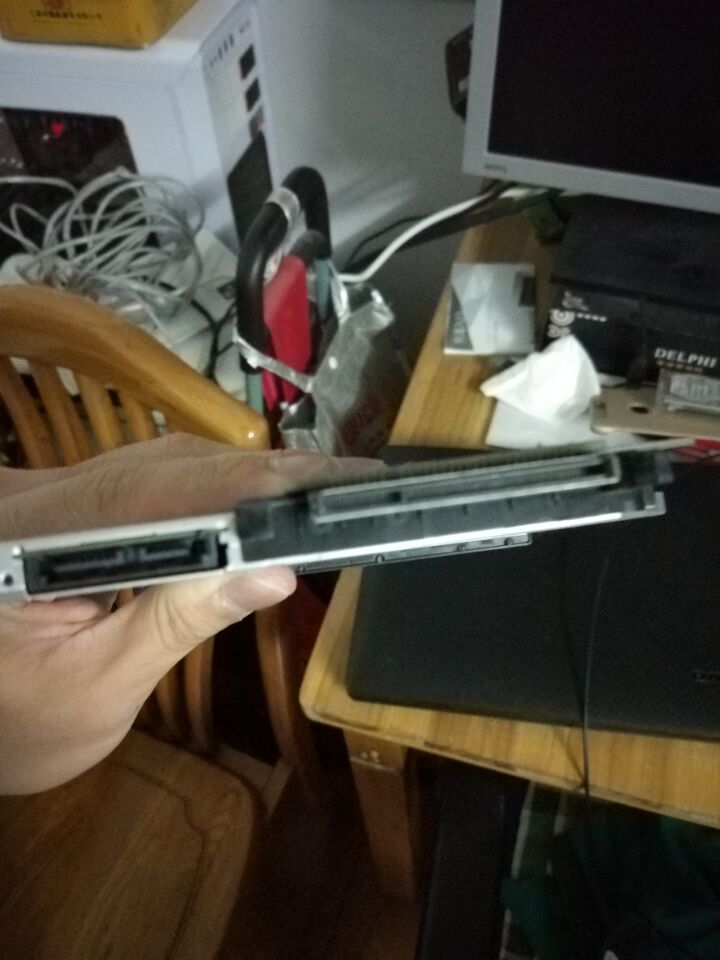

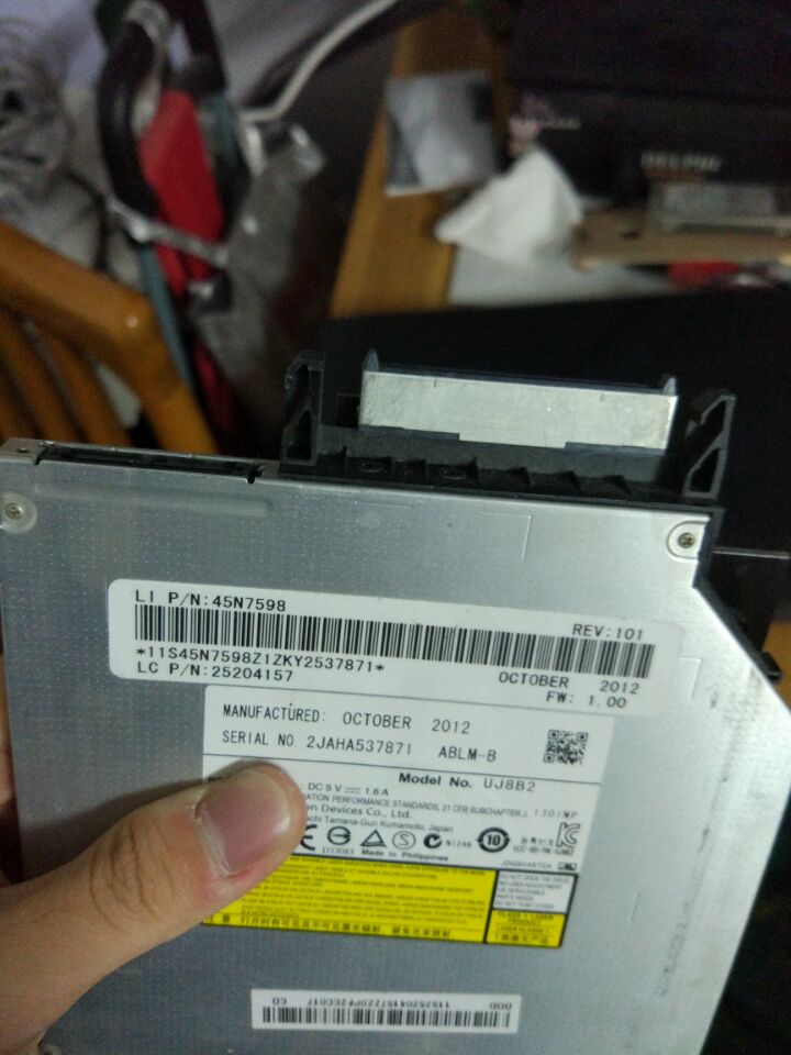

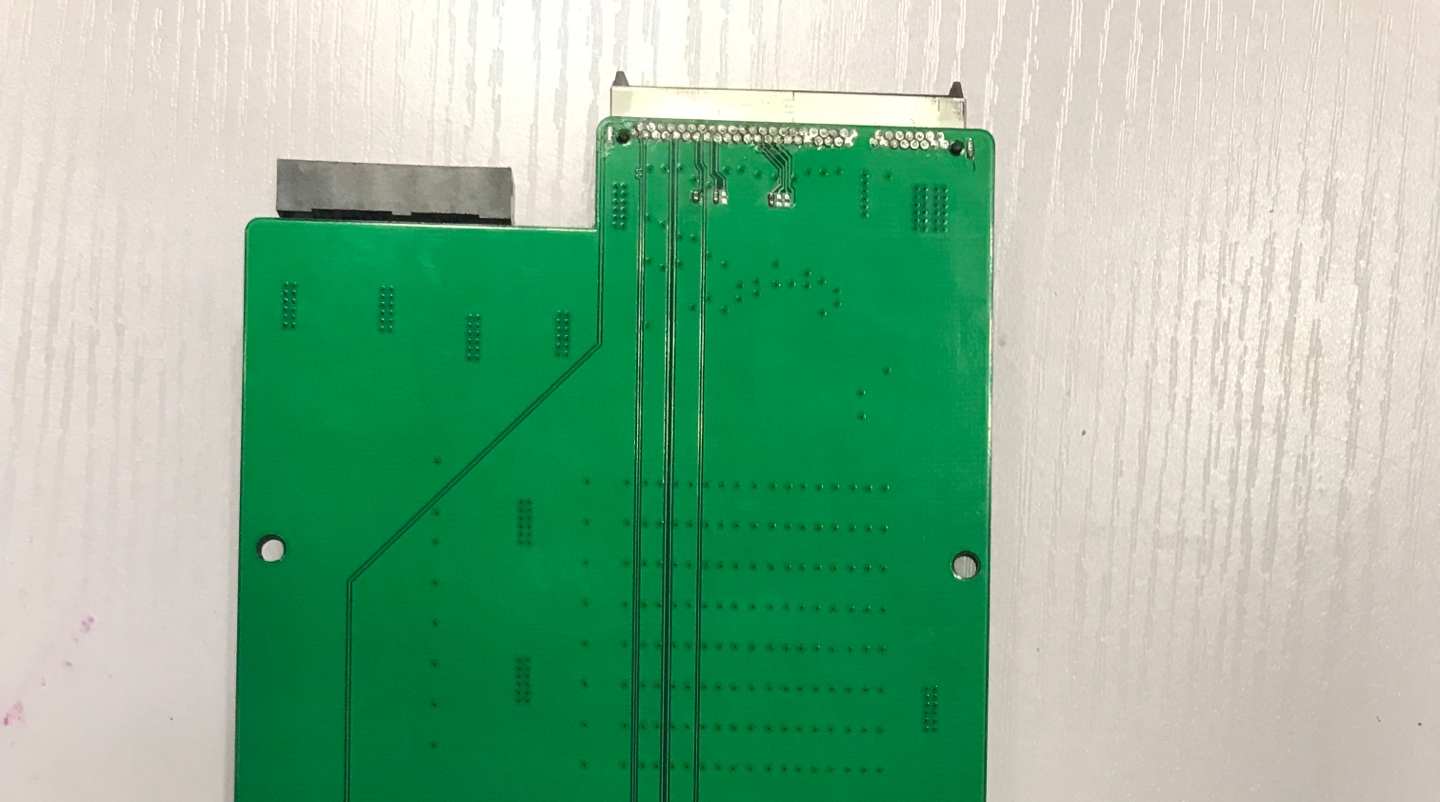

Ah that's relatively easy. you just buy that odd to 2.5' bay. you could align the cables to it and make a cutout on the bay to let the cables run outside the laptop. I have tried it before that's ok

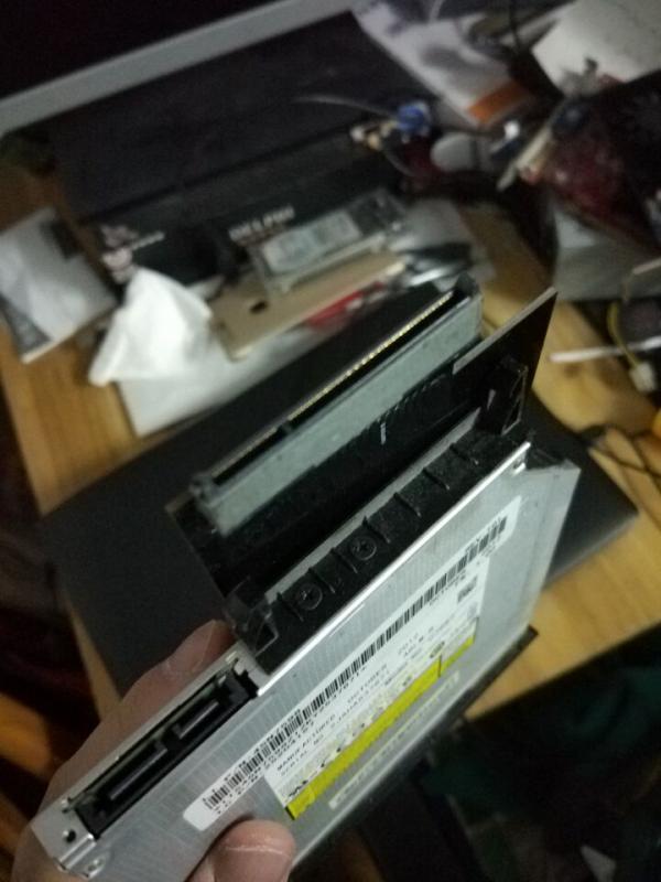

To illustrate what I'm talking about, I have some pics. hopefully they will help you(I don't wanna shut my computer so just pick the things lying around for example lol)
or this one

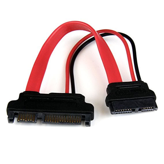

28 minutes ago, AllanDavidson said:
Nice, a internal SATA/Ultrabay combo adapter, and a external eGPU.

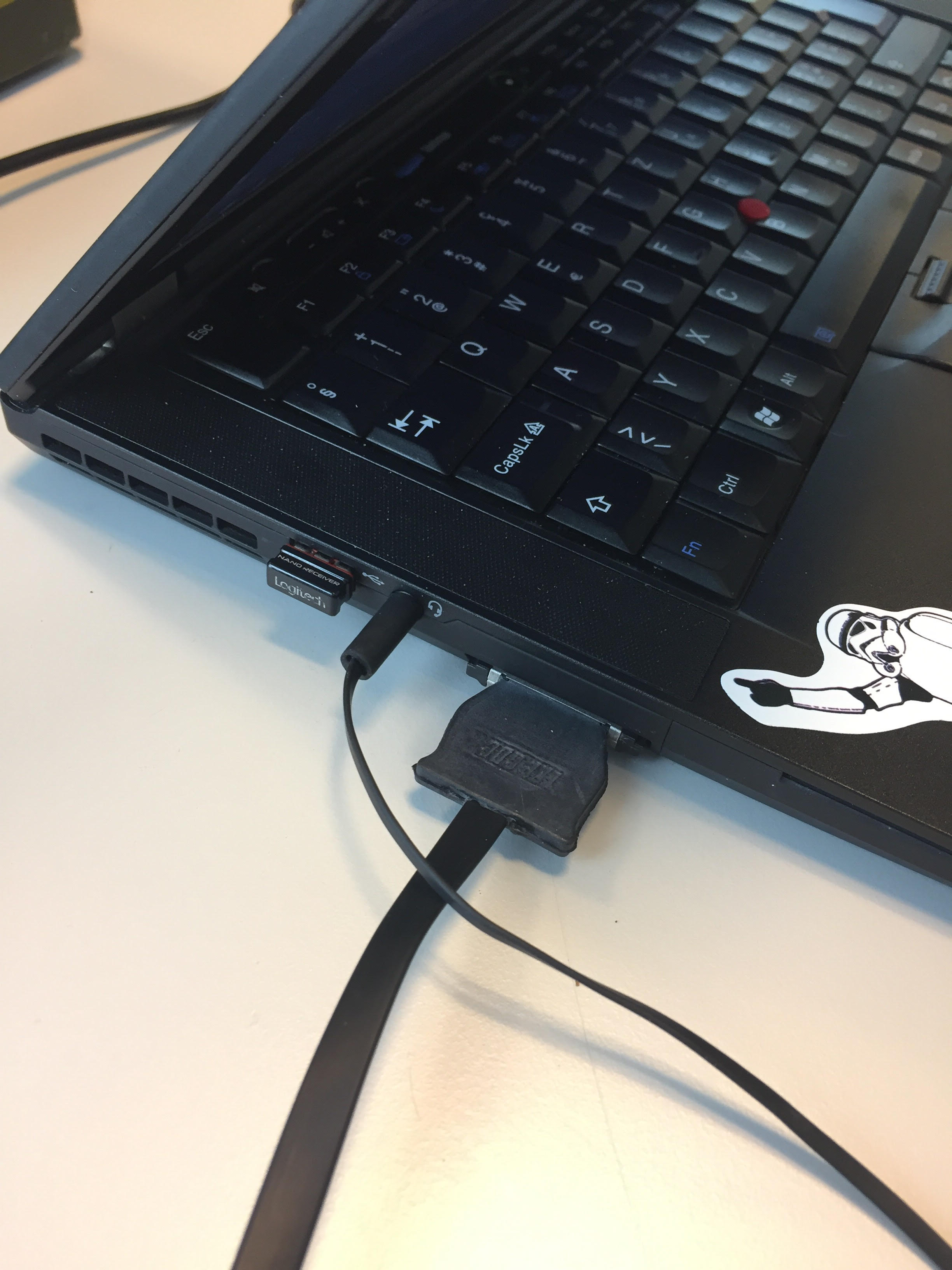

Just illustrating, something like this, with the internal adapter and the external eGPU being interconected by a single plug-in cable.
But maybe a D-SUB wont be able to handle the 8x PCIe... Displayport maybe?
I just got one end of the cable lengthed by an pcb is for the convenience of attaching and detaching

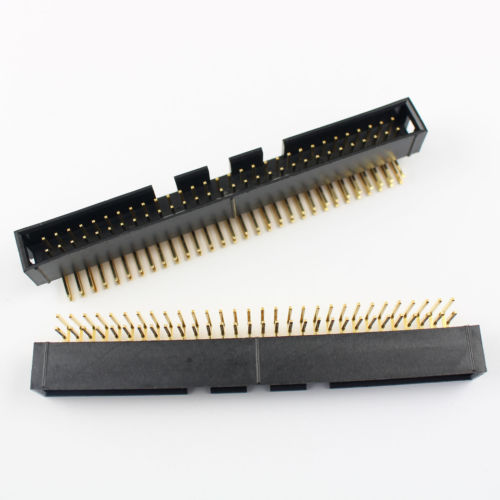

I did have thought of HDMI/DP or others. They are not qualified for this job. They will cause the display driver stop running or just not showing up the egpu(maybe electrical interference or something) They just don't work well. I even thought of placing a vertical PCI-E x16 slot and get a extension cable for it. It just not being elegant. :(
I even thought of SFF cables. They will just bring the price of it out of control...

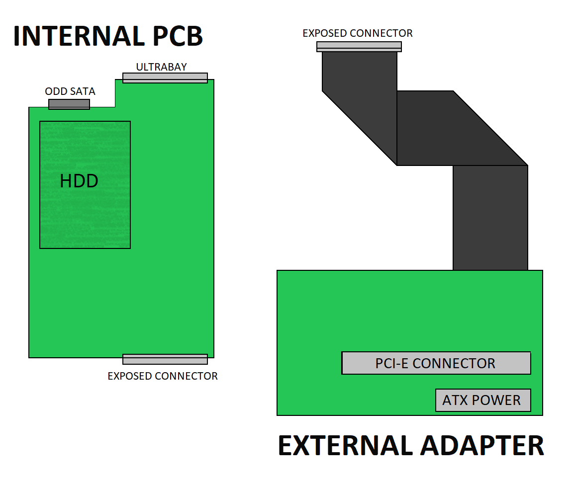

Enjoy my madddzzz skilllzzz at Ms Paint. :bananapowerslide:
(I know I'm bad at it)

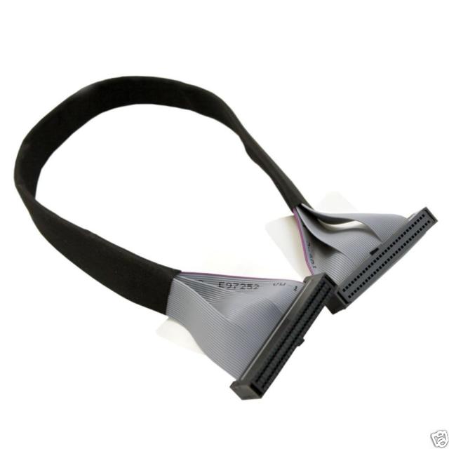

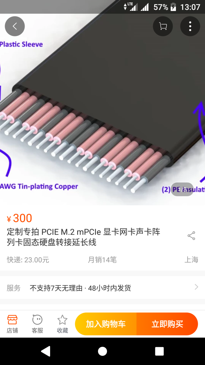

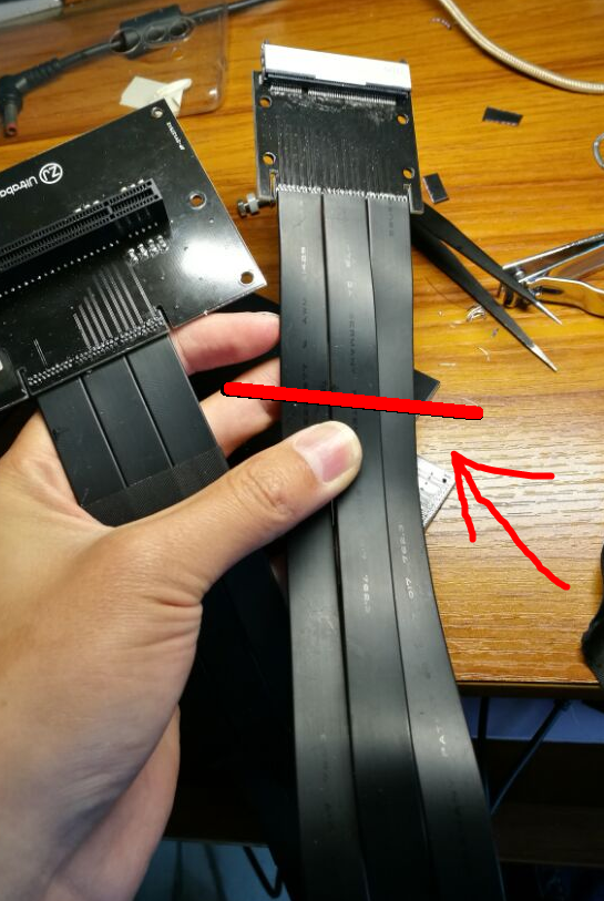

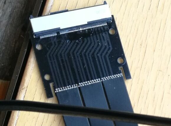

My thought is the same as you. But how to do about the EXPOSED CONNECTOR? How about the signal integrity? What's the connector should be used? PCIE is specially designed. That's why I designed them as directly soldered to the board... I DID experienced signal degradation when using these random connectors. They just don't work well.
The pics are the cables I used. They are really not cheap.

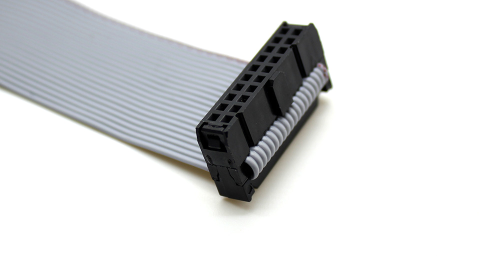

These are 30 AWG right? IIRC, Network cables (like Cat5e RJ45) are 30 AWG, the shielding may vary.
Depending on how many wires are really needed to make it work, some standard cables might do it.

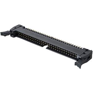

I found this looking for many-pin cables. They are Dell PowerEDGE server cables.
https://www.ebay.com/p/Dell-POWEREDGE-Pe750-Cable-60-Pin-Dd0s20th003-12-Inches-X1026/1362838324

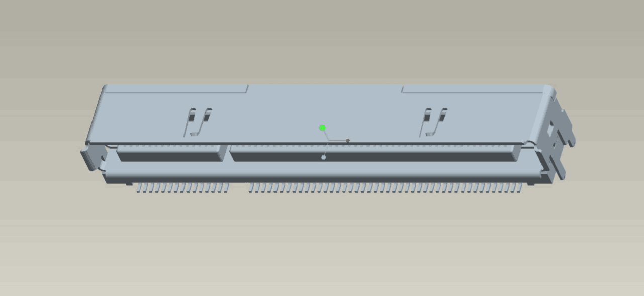

Well... I found the female connector of ultrabay. part No.2199022-1. But i'm probably not gonna produce one of that... So good luck!
Hell no! It would be very expensive and unnecessary, just one single male adapter is required to send the data to the laptop, the rest can be made with other connectors.
This is a very expensive 3M PCI-Express Extender, and they use 30 AWG .025" cables.
https://www.digikey.com/product-detail/en/8KC3-0726-0500/3M12026-ND/3641403
These wires are 24 AWG, and are cheap.
https://www.discount-low-voltage.com/Cable/Cat3-Telephone-Wire-Cable/BC3RI5024GYCO?gclid=Cj0KCQjwodrXBRCzARIsAIU59TJsjAsKsmUtyWH9iUvtiAyGwcx-6VUBCw5c-hIz3pYULxNrHd-qkfcaAl6XEALw_wcB

I was also thinking about making things simpler, since the cable is expensive and the connectors are not trusty. Have 2 PCBs, one on top of the other (almost like you already did).
2 PCBs, one for the Ultrabay adapter, and one for the Sata HDD. This way it would be possible to plug-in or plug-out the Adapter (black board on image) without plugin-out the HDD (green board on image).
OR this black PCB can be just your adapter with a handle that make it easier to pull it and push (without messing with the SATA HDD)

The problem is you can't use a telephone line to passsthough pcie signal... I said these PCIE ones are specially designed...
That's why I got them soldered the cable directly on pcb and they are expensive. I can't just pick a bunch of random copper cable and frankenstein it and call it a day...
Using pcie extenders can extend them like 2 meters or even 10 meters,but they are specially designed for pcie. Using Non-PCIe cables can cause stability issues.

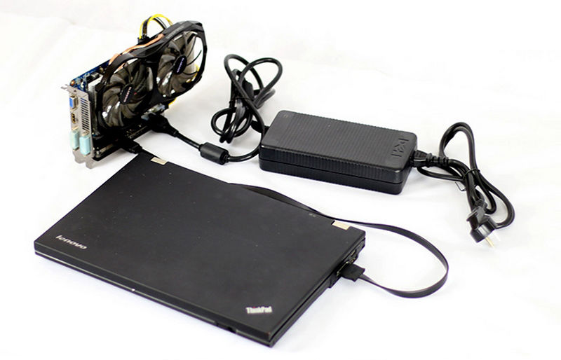

Guys I wanted to thank you all for the work you put in the adaptor- it works like a charm with my y510p- I got the internal screen working with the modded BIOS, version 3 of the adaptor and a wonderful GTX980 :-)
Thank you!
A last question remains for me: Do you have any clue if i can use a pci express extender cable to put the hot gtx a few inches away from the laptop? I tried it once with a cheap cable from thermaltec, but that didn't work out. Do you guys have any experience with these extenders? Or is geralds adaptor wired in sone way that an extender wouldn't work in the first place?
