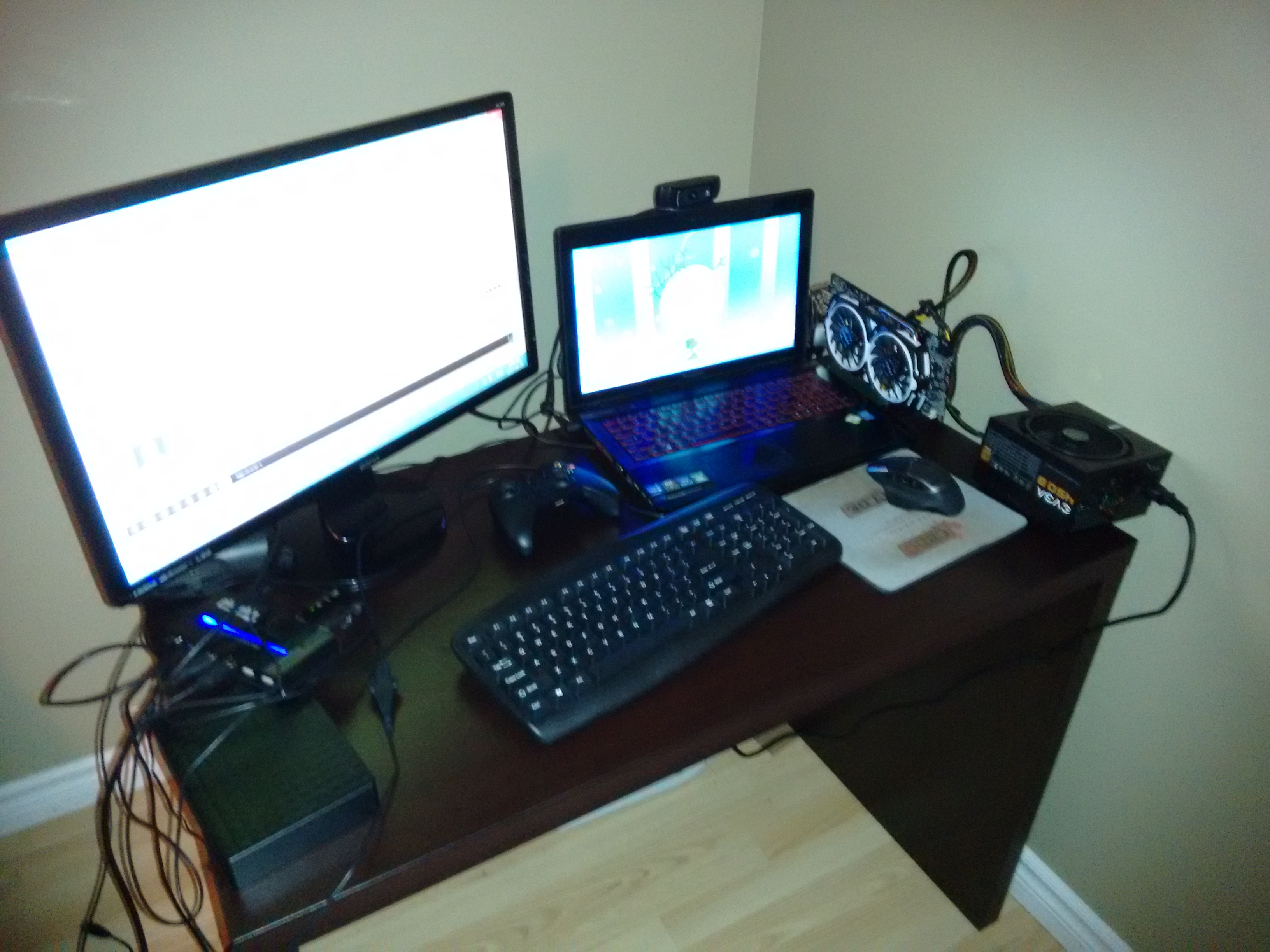

I don't need the egpu going to my laptop screen. I game on my monitor connected to the egpu and use the laptop screen as a secondary monitor. I've already done some streaming with a game running on my monitor and using the laptop screen for obs and chat and that's worked perfectly fine.

I can drag applications from one screen to another and it works.  I'm constantly doing it with chrome tabs and other programs. Just then to make sure it worked with something beefier, I started a game in windowed mode, dragged it over to my laptop screen, and it ran perfectly fine.
Spoiler
I kind of managed to fit everything on my desk though cable management is a bit of a nightmare at the moment especially because of the non-modular psu (please excuse the image quality I took it with a potato).
The only problem I'm having right now with regards to the egpu setup -other than needing a bigger desk- is that the adapter won't seat very well in the connector at all so if I move anything I get an hard lock and have to reboot. Taking that picture I tried to see if I could move that cord that is sticking up behind the gpu into a different position and it was enough of a jostle to lock my computer up. I have the adapter pushed in as far as it will go.
My adapter isn't under pressure or stress from anything, it just doesn't seat well.  I wish it seated better but the only reason it's annoying for me is that my girlfriend broke her monitor so she's been using mine and I've been disconnecting and reconnecting it to the egpu over the last couple of days. Once she gets another monitor/hdmi cable it's a non-issue since it's not going to happen very often that I'm fiddling with it or moving things while it's running.

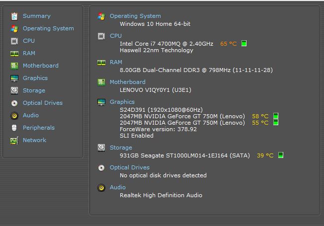

Hi all, I need some advise to get my y510p tuned.  I'm pretty interested to get the adapter. But my main concern is about compatibility, I Have the y510p with the 750M SLI version, WIN10 64bits, migrated from Win 8.1 ,
I'm aware that must be an AMD card, so I will buy this card
GPU
https://www.pccomponentes.com/sapphire-nitro-radeon-rx-480-oc-4gb-gddr5
PSU
https://www.pccomponentes.com/tacens-mars-gaming-vulcano-750w-80-plus-silver-modular-rojo
Do you think that the y510p will manage this card? Anyone with compatibility issues? My main concern is about compatibility, because I need to do some invest in the GPU, the eGPU adaptor and the PSU. Of course, my long term invest is to build my new computer. My other concern is related to the CPU temp, the y510p withstand such power? My concern is the overheating issues, I see some people removing the keyboard, a NO option for me. I will not tweak the CPU fan curve, voltages and removing the 4700MQ from the hood.
In regards with the PSU, I will buy something around 600W power. My bios version is the V2.07 stock.
Any comment will be appreciated, the specs are on the file bellow. Thank you and best regards.
I run an XFX RX 480 with the laptop CPU at stock. The adaptor will not add any extra heat to your laptop CPU if anything it will reduce it as the embedded graphics cards will no longer be running. You could also buy a cooling pad if you are really worried.
