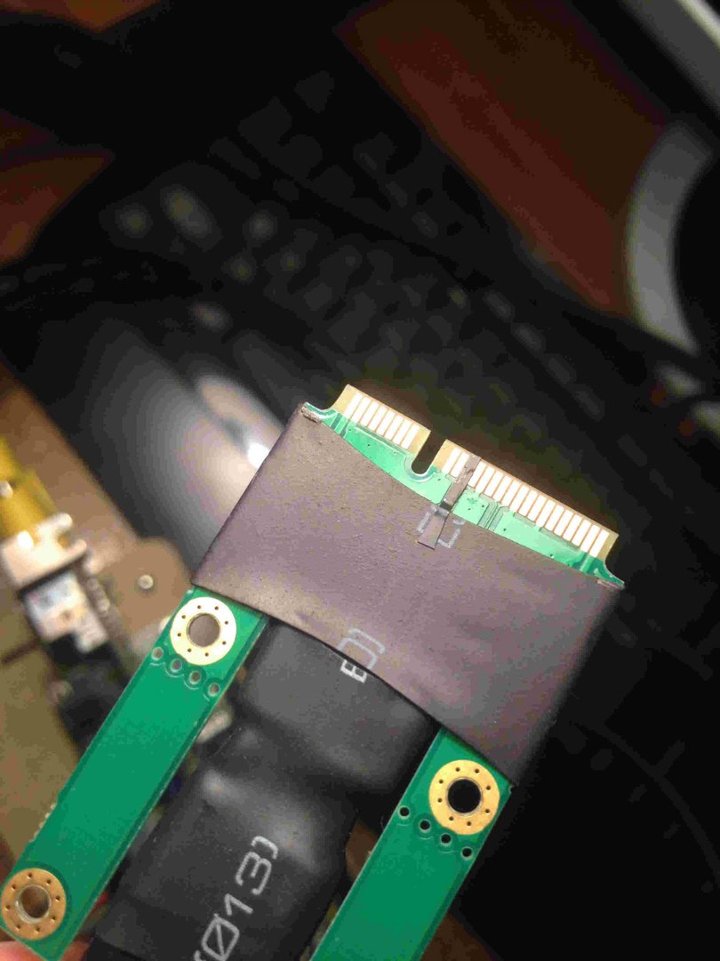

Roman Posted December 23, 2015 Share Posted December 23, 2015 (edited) On 12/18/2015 at 4:52 AM, Tech Inferno Fan said: Pls work through https://forum.techinferno.com/index.php?/forums/topic/8947-mpcie-egpu-troubleshooting-steps/ including jumpering the PSU to be always on and also test isolating pin 22 of the mPCIe adapter to bypass the BIOS detection black screen on boot. i tried reset bios, upload latest bios... i tried pin 22... with it my old 9600gso is not working too... windows is loading but no way to see egpu if no pin then black screen... 9600gso working good without pin22 i cant manage mpcie in bios. what is difference between 9600gso(working) and gtx950(not working) gtx750 (not working). i dont know what to try next.... and how could setup 1.3 can help me... maybe if i put here mpcie x1 then it'll work... Edited December 24, 2015 by Roman Link to comment Share on other sites More sharing options...
