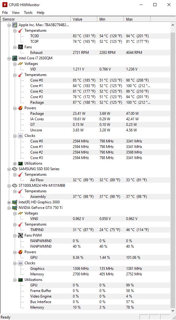

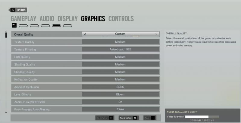

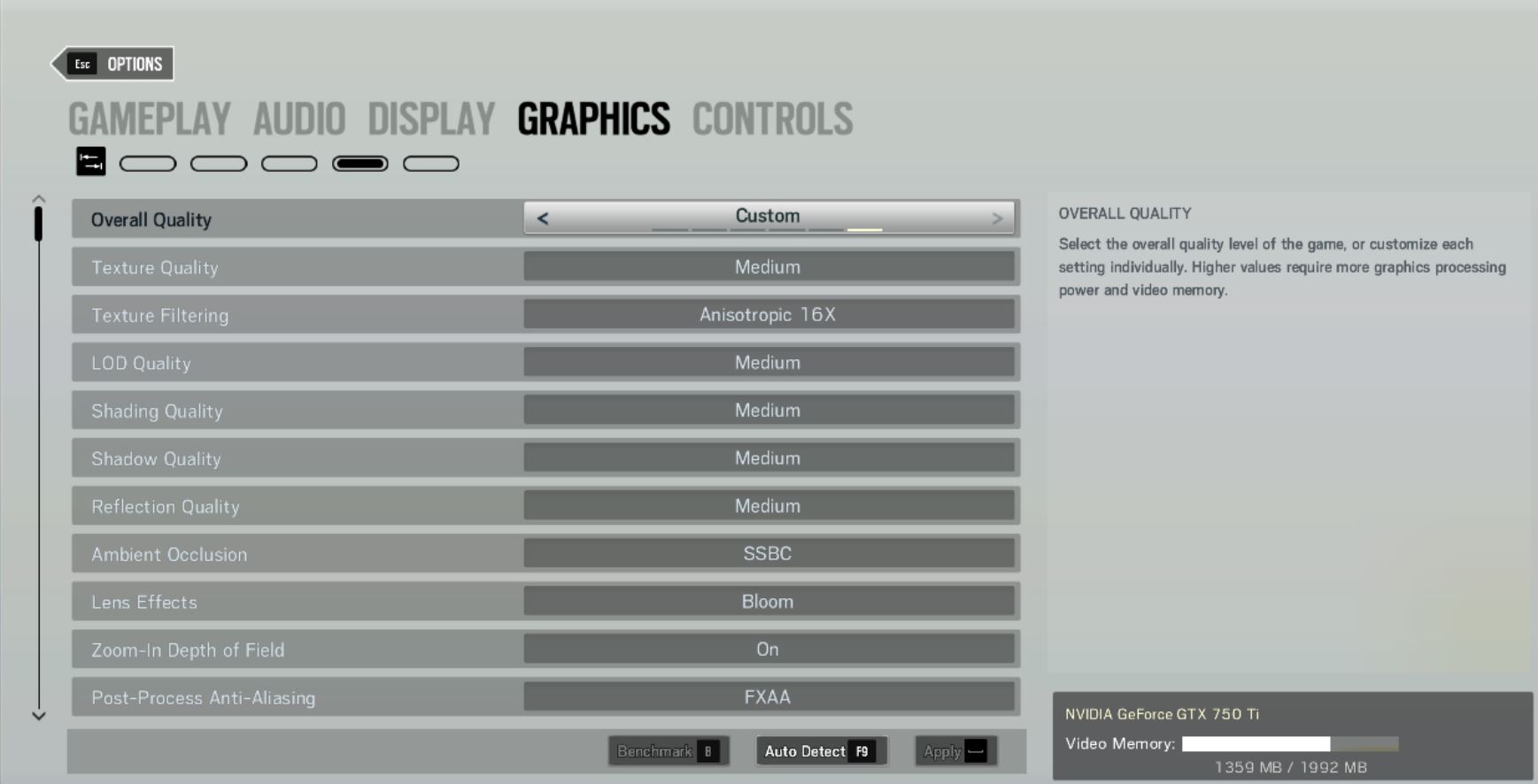

Hiding the cables is kind of a non issue NOW. It seems like my card is crashing wayy more than it ever did with the other 60watt power supply...i was playing rainbow 6 siege a lot today, and couldn't really play for more than a few minutes at a time without having the card crash. I finally downloaded an app to monitor my cpu and gpu power etc, does this look right to you? (Note the column all the way to the right is the highest, the middle is the minimum and the left is the current) keep in mind I'm not running crazy settings within the game, everything is pretty much at medium and i'm getting 50-65fps at these settings too. I know that the cpu temperature does seem hot, but it's a mac mini and they run super hot, the doesn't even throttle until it reaches 221(f)/105(c) degrees believe it or not. So it's not the cpu getting too hot. Anyways, if you could take a look at the chart and give me your feedback I'd appreciate it.
Thank you!
-Bill

@Dschijn My gpu hasn't been stable since I switched to this evga 400watt psu. when I run hw monitor pro oit constantly says that my gpu voltage is .962 and hasn't changed. Even after flashing my bios so the card will read 65.5 watts. Is there a reason that you you can think of why my gpu would only be a consistent .962volts and never change whatsoever? You can see the table that i posed above...
Thanks!
