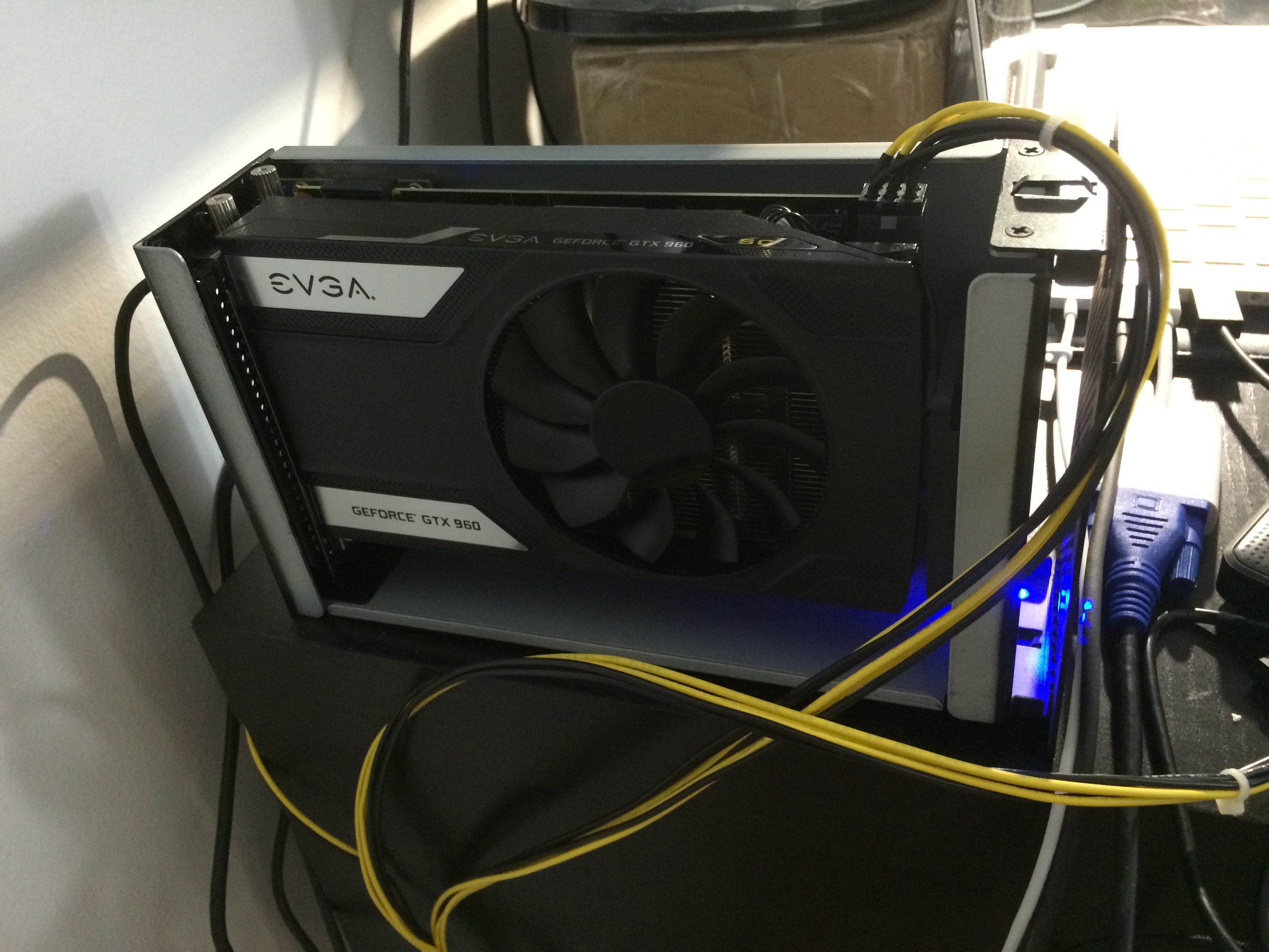

I hope this guide has been helpful to you. This is more of a boot-guide than a hardware set up. As I was reading the forum threads, many people were having issues with the 2015 13" Macbook pros. I hope my method will solve your issue.
Please write down below to let me know if it worked or not. I've tested this on both Windows 8.1 and Windows 10 and it has worked 100% of the time (Replicated this three times each. ie. fresh installed Windows three times each)
Thanks for reading and here is a potato pic of my eGPU hardware.
