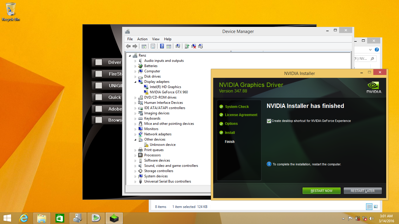

anyway, still not working with delay switches. Is there a way that I can force the driver to install? I tried my other laptop and it works to dell inspiron. :(
Now, I finally installed the driver... I use hotplug trick on wifi and pe4c while in sleep mode. But when ever I restart my laptop, the driver becomes undetected again and I have to reinstall the driver.
I'm out of ideas for now :question:
