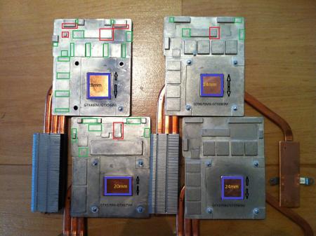

Here You can see the different Heatsinks for Nvidia GPU`s and the Modification for a GTX 970M / GTX 980M.
The cheapest Way is to modify Your own Heatsink from Your GTX 560M,ist only a little work.
I think You don`t want buy a Heatsink for this Money like this on Ebay: 272144365752
All Heatsinks in my Picture fits in every MS-16F1 / MS-16F2 / MS-16F3 / MS-16F4 / MS-1761 / MS-1762 / MS-1763
Red : Remove
Green: Upholster with Thermalpads
Blue: Thermalpaste
Yup the Gt70 heatsink is too expensive, but I can see a problem there. I have 570m so my cooper part of heatsink is wider and only 20mm long. Should I fill the missing 4 mm by termopads or, by thermalpaste or just left it alone? If it really is as easy as it seems and require only drilling some part of heatsink and changing vbios I will order clevo gtx970m tomorrow. Thanks guys for all your help.

This seems like a huge risk. The copper should touch the entire core. There is a chance it will fit anyway though - I think the copper part is bigger than necessary.
Please note the green parts - where you need to add thermal pads, are 0.5cm high in some cases. You will need to put at least 2-3 layers of thermal pads there.
Some of them are supposed to cover mosfets for voltage. these things really needs to be kept cool and you cannot measure the temp on these - you can see only the temp on core.

Some people don't feel comfortable or dont have tools to modify heatsink. You have to be careful, if you dremel something off, you cant get it back.
But yes, it's not that hard, it took me about 20 minutes to modify GTX560m heatsink for GTX770m. But you need to be careful, precise and make sure it fits perfectly. You really dont want the heatsink to touch anything it shouldnt.
New heatsink is expensive, I give you that, but you can be sure it will fit, you dont have to "fake" missing parts by adding 3 layers of thermal pads (which greatly reduce heat condictivity) and as a bonus, you are getting additional heatpipe (cooler boost2) connected to CPU heatsink which helps to reduce or even out the temps, depending on on GPU/CPU usage.
I's about personal preference imho. If you have skills to do it yourself, its cheaper.
I personally wouldnt mind throwing couple of dozens bucks more for heatsink that is a bit more efficient, especially for a GPU that is quite expensive as well.

That`s right,but for everyone who can flash a Vbios and modify a Heatsink it is cheaper.
With a GTX 970M You can use every Heatsink,also the GTX 570M Heatsink is OK because the Temperatur are low.

better cooling enables higher overclock potential though. And GTX 970m is a beast. I was able to push mine +360core +300memory while overvolting by 50mV. Temps are at 86C but the difference in performance is day and night.
But yes, as for "just getting it to work", handmade heatsink would be more than enough. At stock clock, mine didnt went past 72C (GTX580m in the same machine reached 87C any day.)
I just bought a GTX 970m 6gb from a guy Woodzstacks in Canada (i have a Medion Erazer X6819 / MSI GT683) - he asked the model of Laptop etc and the Kit came right from the factory with vbois already done - all i did was mod the heatsink as in the diagram above. He was very helpful with advice on modding etc and i highly recommend him.
