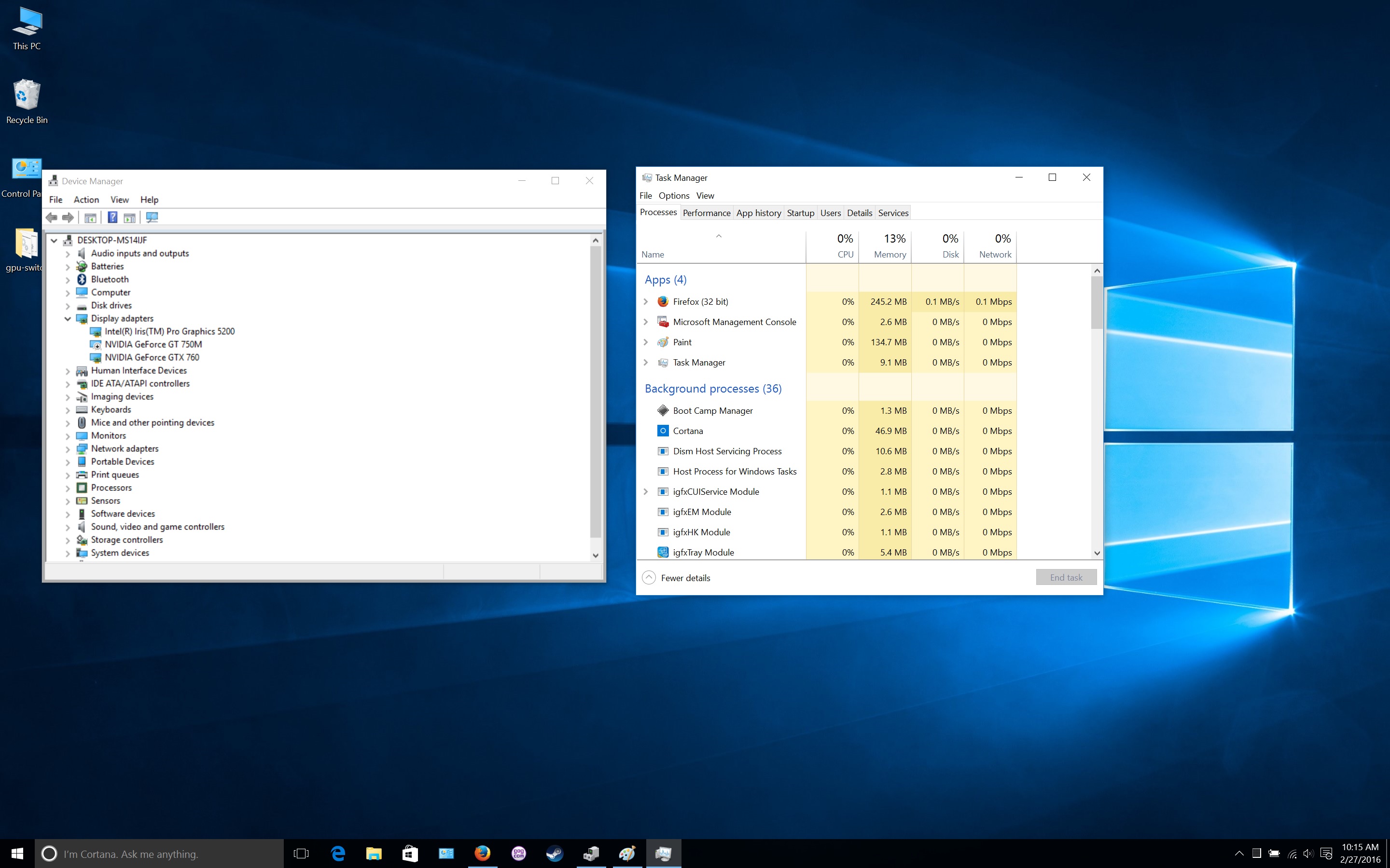

pizzacat Posted February 26, 2016 Share Posted February 26, 2016 (edited) here are the basic steps: reFit/apple_set_os.efi to enable Iris gpu-switch (integrated.bat) to select the iGPU / reboot install the iGPU drivers and run integrated.bat / shutdown -- connect eGPU and boot you should have 3 devices in Device Manager, with the eGPU showing an error icon disable the dGPU in Device Manager and run integrated.bat / shutdown boot with the eGPU connected, check Device Manager for 2 enabled GPUs open Task Manager, there should be a constant 10-15% CPU load from the System process Hibernate (a fix to remove the CPU load) Reboot and the CPU load will be gone, eGPU will work with Optimus! How to shutdown (this is important!) Enable dGPU in device manager gpu-switch dedicated.bat If you get a black screen on reboot, at any point, you probably used gpu-switch and selected a disabled GPU reboot into windows safe mode to fix this Edited February 26, 2016 by pizzacat 1 Quote Link to comment Share on other sites More sharing options...
tre87 Posted February 26, 2016 Share Posted February 26, 2016 1 hour ago, maarten said: Hi there. That worked! Thank you so much for the suggestion. I did have to install both x86 and x64! Now I am still wondering how to get Optimus and the eGPU working on the internal LCD... - When I switch to the internal GPU (Iris Pro), the rendering on the internal LCD is done by the internal GPU - When I switch to dedicated GPU (750M), the rendering on the LCD is done by that one. How do I get the rendering to be done by the eGPU (GTX 760) on the internal LCD? Do I need to disable the dedicated GPU (750m) in device manager after enabling the internal GPU (Iris pro)? Last time I disabled the dedicated GPU, windows refused to boot. Thanks! Try disabling the dGPU for starters. Create a restore point before you do it. So that if it fails, you can either boot in to safe mode or use that restore point to recover As I haven't messed around with Optimus alot, I don't know if you can choose the Optimus device within the nvidia settings? Maybe someone else can answer this Did running the the integrated.bat for the gpu-switch fix the problem you had changing the brightness? Quote Link to comment Share on other sites More sharing options...
maarten Posted February 27, 2016 Author Share Posted February 27, 2016 16 hours ago, pizzacat said: here are the basic steps: reFit/apple_set_os.efi to enable Iris gpu-switch (integrated.bat) to select the iGPU / reboot install the iGPU drivers and run integrated.bat / shutdown -- connect eGPU and boot you should have 3 devices in Device Manager, with the eGPU showing an error icon disable the dGPU in Device Manager and run integrated.bat / shutdown boot with the eGPU connected, check Device Manager for 2 enabled GPUs open Task Manager, there should be a constant 10-15% CPU load from the System process Hibernate (a fix to remove the CPU load) Reboot and the CPU load will be gone, eGPU will work with Optimus! How to shutdown (this is important!) Enable dGPU in device manager gpu-switch dedicated.bat If you get a black screen on reboot, at any point, you probably used gpu-switch and selected a disabled GPU reboot into windows safe mode to fix this I tried the steps you mentioned above, and everything went fine. However, the Iris Pro is still doing the rendering on the internal LCD, instead of the eGPU. The eGPU is connected and seems to run fine. I can't figure out why it is not using Optimus and the eGPU. This is what my device manager looks like: 16 hours ago, tre87 said: Try disabling the dGPU for starters. Create a restore point before you do it. So that if it fails, you can either boot in to safe mode or use that restore point to recover As I haven't messed around with Optimus alot, I don't know if you can choose the Optimus device within the nvidia settings? Maybe someone else can answer this Did running the the integrated.bat for the gpu-switch fix the problem you had changing the brightness? I cannot see any settings in the Nvidia control panel that would allow enabling optimus. Yes, the brightness problem seems to have disappeared when using the gpu-switch. I can now use the keyboard buttons again to change brightness. Thanks for the help guys! Quote Link to comment Share on other sites More sharing options...
