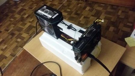

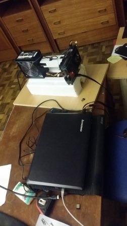

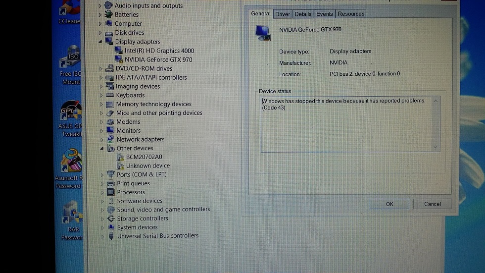

Hello there, i hot almost identical specification to yours, although i still encounter some problems in windows. Could you let me know step by step, how did you get it done?
I have
Lenovo y580 i7 3630QM 256GB mSATA , 1TB 5400ot/min , windows 8.0 64bit
i purchased beast v8.0, ASUS MINI GTX 970 COLERMASTER 500W
After following all instruction in your manual i still have some difficulties. It seems like windows see this card...but it does not allow it to work properly.
It shows error 34.
By the way , I am planing to build DIY case later on.
Please see pictures. Do you know any more forums, links where i can het help?
thank you
I have
It shows error 34.
thank you
I have similar issue. Did you solved it already?
I'm using Lenovo W520, Intel Core i7 2760QM, 12GB RAM on OEM Windows 10 64-bit with Quadro 6000 and Quadro 4000 for Mac, both show same error.
Beat V8 mini PCIe with Whitelist v1.42 BIOS
Did you use mPCIe or ExpressCard?
Did you plug the 6 pin auxiliary power cable to the GPU from the PSU?
