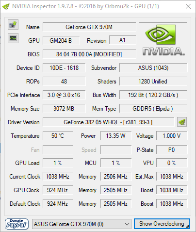

O L I V . R Posted May 21, 2017 Share Posted May 21, 2017 (edited) @Klem Hey Mr. Klem! I'm looking for a vBIOS that could help me push my 970m a little bit further. Asus RoG G752VT - 6700HQ - 970m 3GB - GSync Display // I installed a vBIOS months ago but cannot recall where I got it from. // Here's a screenshot of my Inspector // + I would need the necessary nvflash to install the vBIOS. Thank you so much! // Here's my current vBIOS. Extracted from GPU-Z! Check attachment under the attachment below: GM204.rom GM204.rom Edited May 21, 2017 by O L I V . R Added: 3rd & 4th // Quote Link to comment Share on other sites More sharing options...
Bios Modder Klem Posted May 21, 2017 Bios Modder Share Posted May 21, 2017 6 hours ago, O L I V . R said: @Klem Hey Mr. Klem! I'm looking for a vBIOS that could help me push my 970m a little bit further. Asus RoG G752VT - 6700HQ - 970m 3GB - GSync Display // I installed a vBIOS months ago but cannot recall where I got it from. // Here's a screenshot of my Inspector // + I would need the necessary nvflash to install the vBIOS. Thank you so much! // Here's my current vBIOS. Extracted from GPU-Z! Check attachment under the attachment below: GM204.rom GM204.rom Hi! Check PM. 1 Quote Link to comment Share on other sites More sharing options...
