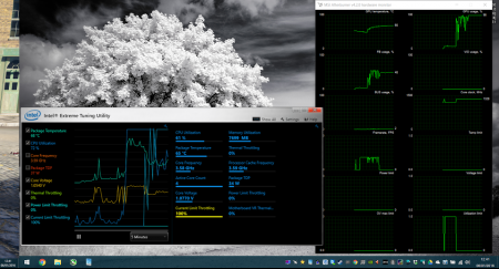

fejerm Posted February 29, 2016 Share Posted February 29, 2016 On 2016. 01. 11. at 8:18 PM, snowpepsi said: I have a P775DM1-G, Nvidia 980 (notebook) and a i7 6700K installed. In taxing games (Assassin's Creed Syndicate), I am getting Current Limit Throttling on the CPU. I've attached a screenshot of XTU. The retailer has forwarded my query direct to Clevo last week, but figured I'd query here while waiting for a response. It's not desirable that the 6700K is being downclocked during gameplay. What's going on? It's not something there is lots of info about, compared to Power or Thermal Throttling. Perhaps I set something incorrectly in XTU. I think the P870DM might be experiencing the same? I've had the laptop since mid december, and it's occurred several times. The only reason I noticed this was due to XTU monitoring. Now that I have noticed it.. it's bugging me. Other than this issue, the performance of this laptop is amazing. Wow, just saw this post...wow. I've expected it to throttle during Lynx or Prime95 stress test, but it even throttles during gaming?! Why? Too low thermal limit? To high default voltage? Or just a bug in the factory bios? What does the Prema BIOS exactly do to fix this? Currently in the EU the best place to get this machine is the british PC Specialist. Are they Prema partners? If not, is it possible to buy the Prema bios sepparately? How much different are the temps with Prema bios? Also, would it make any difference considering temperature if I buy a 65W 6700 instead of a 93W 6700k? I have no plans to OC. Also, the review on the Prema site is uploaded really slowly Quote Link to comment Share on other sites More sharing options...

ggow Posted March 8, 2016 Share Posted March 8, 2016 (edited) I just bought a P775DM1-g from pcspecialist, been using it for a few days now. With Windows 10 everything works perfectly including processor states etc. Further testing has revealed that gaming in Windows 10 or anything that loads the processor causes throttling. This concurs with what @snowpepsi said. However, with Xubuntu 14.04 - 16.04 + Linux Kernel 4.5-rc7, my preferred linux distro. There are are few problems, including one major issue - There is severe processor throttling when under load - starts at 4.2 GHz then throttles all cores down to 800 MHz (major) - WiFi wasn't able to work as support for the Killer 1535-ac wireless card isn't fully included as standard which I solved this by installing the correct firmware files - No backlight control The processor throttling is an issue for me because I do a lot kernel and Android OS development so linux is my main OS normally. Edited March 16, 2016 by ggow Further Testing with Windows 10 Quote Link to comment Share on other sites More sharing options...
