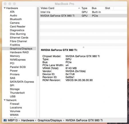

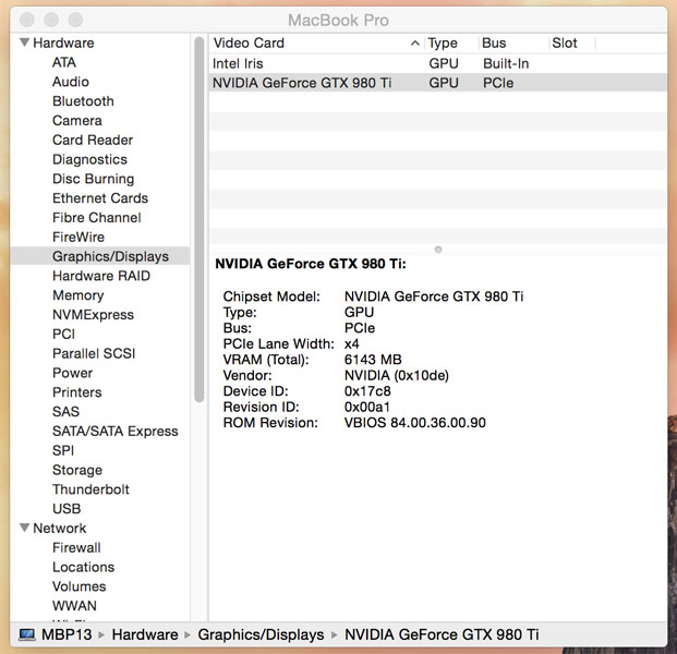

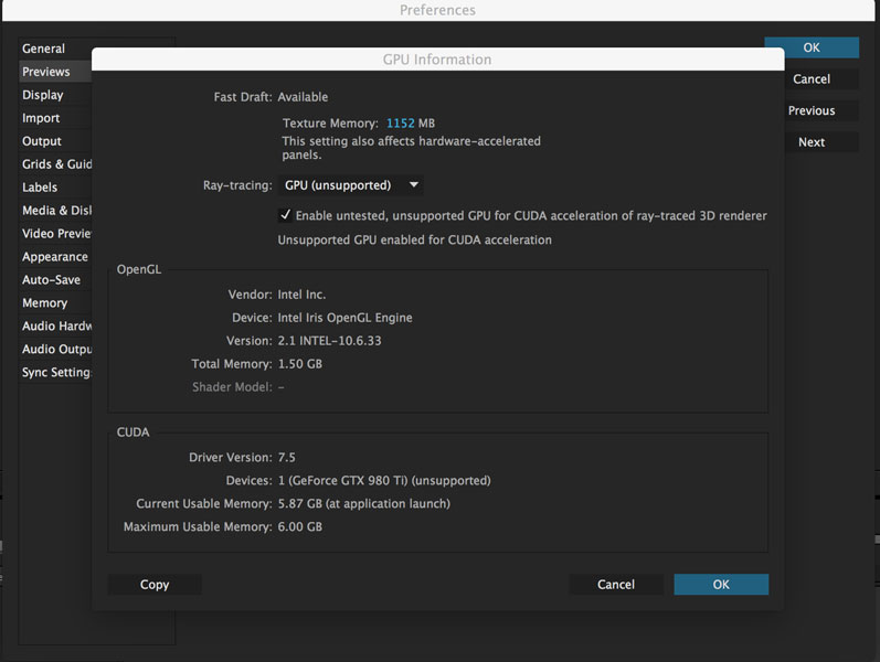

pyramidgod Posted November 29, 2015 Share Posted November 29, 2015 I'm have a similar issue. I have a maxed out Late 2013 Macbook Proand GTX 980 TI w/ 850 EVGA Power Supply. My main use in Davinci Resolve and Adobe Premiere (I've also used Adobe Media Encoder) and it seems as though it's not working. Can I change the supported cards lists in CC 2015? I can see it in After Effects when I turn on allow unsupported cards but still not Premiere Pro. 1 Quote Link to comment Share on other sites More sharing options...
pyramidgod Posted November 29, 2015 Share Posted November 29, 2015 How did you get it to work? Quote Link to comment Share on other sites More sharing options...

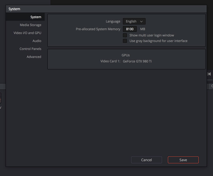

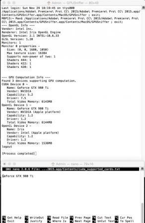

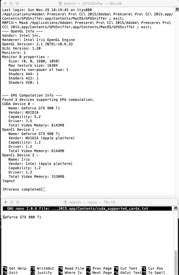

Dschijn Posted November 29, 2015 Share Posted November 29, 2015 @pyramidgod: Sth like this? Quote Link to comment Share on other sites More sharing options...
pyramidgod Posted November 29, 2015 Share Posted November 29, 2015 @pyramidgod: Sth like this? I tried to make it work for CC 2015 but it still doesn't work. It's functioning properly for you? Quote Link to comment Share on other sites More sharing options...

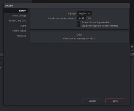

Grubersky Posted November 29, 2015 Share Posted November 29, 2015 I'm have a similar issue. I have a maxed out Late 2013 Macbook Proand GTX 980 TI w/ 850 EVGA Power Supply. My main use in Davinci Resolve and Adobe Premiere (I've also used Adobe Media Encoder) and it seems as though it's not working. Can I change the supported cards lists in CC 2015? I can see it in After Effects when I turn on allow unsupported cards but still not Premiere Pro.[ATTACH=CONFIG]16661[/ATTACH]Hi, does it work with DaVinci though?Marco Quote Link to comment Share on other sites More sharing options...
pyramidgod Posted November 29, 2015 Share Posted November 29, 2015 Yea but now maybe I'm thinking it could be how my Akitio is powered. Do my stats look right for my 980 Ti in Cuda-Z?CUDA-Z Report=============Version: 0.10.251 64 bit CUDA-ZOS Version: Mac OS X 10.10.5 14F1021Driver Version: 10.4.2 310.41.35f01Driver Dll Version: 7.50Runtime Dll Version: 6.50Core Information---------------- Name: GeForce GTX 980 Ti Compute Capability: 5.2 Clock Rate: 1190 MHz PCI Location: 0:10:0 Multiprocessors: 22 (2816 Cores) Threads Per Multiproc.: 2048 Warp Size: 32 Regs Per Block: 65536 Threads Per Block: 1024 Threads Dimensions: 1024 x 1024 x 64 Grid Dimensions: 2147483647 x 65535 x 65535 Watchdog Enabled: Yes Integrated GPU: No Concurrent Kernels: Yes Compute Mode: Default Stream Priorities: YesMemory Information------------------ Total Global: 6143.81 MiB Bus Width: 384 bits Clock Rate: 3505 MHz Error Correction: No L2 Cache Size: 48 KiB Shared Per Block: 48 KiB Pitch: 2048 MiB Total Constant: 64 KiB Texture Alignment: 512 B Texture 1D Size: 65536 Texture 2D Size: 65536 x 65536 Texture 3D Size: 4096 x 4096 x 4096 GPU Overlap: Yes Map Host Memory: Yes Unified Addressing: Yes Async Engine: Yes, BidirectionalPerformance Information-----------------------Memory Copy Host Pinned to Device: 1275.66 MiB/s Host Pageable to Device: 1250.38 MiB/s Device to Host Pinned: 1379.6 MiB/s Device to Host Pageable: 1355.51 MiB/s Device to Device: 108.758 GiB/sGPU Core Performance Single-precision Float: 7083.75 Gflop/s Double-precision Float: 233.783 Gflop/s 64-bit Integer: 485.834 Giop/s 32-bit Integer: 2430.57 Giop/s 24-bit Integer: 1631.03 Giop/sGenerated: Tue Nov 24 12:14:16 2015 Quote Link to comment Share on other sites More sharing options...

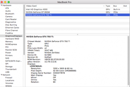

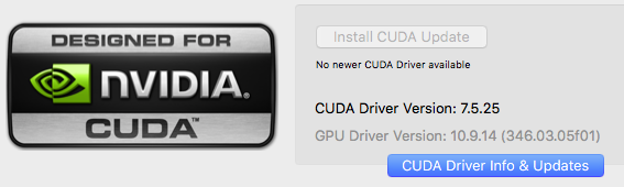

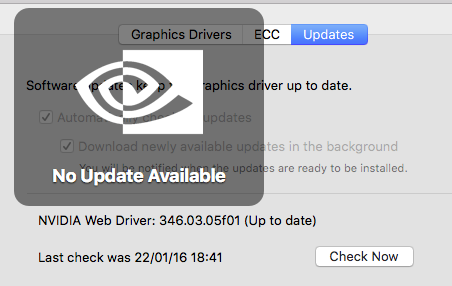

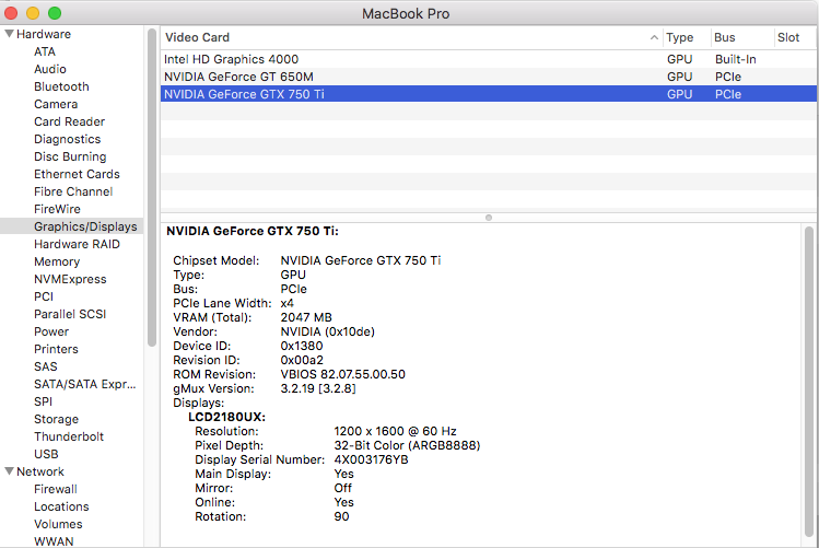

BAZZINGA Posted January 22, 2016 Share Posted January 22, 2016 Hi everyone, first off: shout outs and many thanks to @goalque + @Dschijn and everyone else here. Without you I would not have been able to set up my current build.Which is: 1) MBPr 2012 in Clamshell-mode 2) Akitio Thunder2 3) Original Apple TB-Cable 4) GTX 750TI 5) 120W Power supply 6) external Monitor – directly hooked up to the Graphics Card, NOT via TBDriver + OSX-specs: see attachmentADOBE CC 2015 Everything seems to go well – but unfortunately NONE of my Adobe-products are working! Not even the GPU-sniffer or CUDA-Z are working:GPU-SNIFFERTester="Photoshop" snifferStart="2016-01-22_18:37:36" AIFCoreInitialized=1 AIFOGLInitialized=1 caught signal 14, exit 4 done.CUDA-Zsimply freezesGRAPHICS-GLITCHFYI: my MacBook has this technical glitch you might have heard of:http://www.macrumors.com/2015/02/19/2011-macbook-pro-repair-program-apple/ Unfortunately Apple won't repair my MacBook for free since my warranty has expired. So that was the reason why I got the eGPU in the first place: I'd rather spent X$ and double my GPU-performance instead of paying Y$ and get the same old MacBook. Did I fool myself here cause I should have made the repairs anyways? Or did I make the right choice... but I am just missing something in my setup/build? Any help, hints and pointers much appreciated! So long, Bazzinga Quote Link to comment Share on other sites More sharing options...
