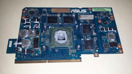

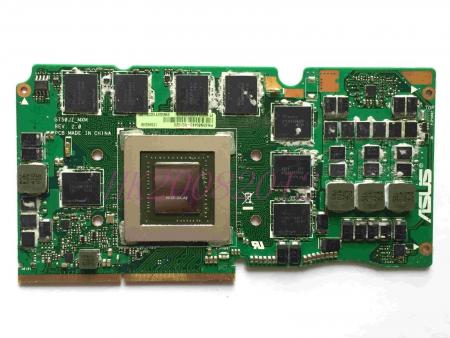

Mine has a GTX 660m, you can swap it with the 670m but it's not an upgrade.  The GTX 880m will fit the socket but I'm not sure it will fit the case and the screw mounts won't line up as well as the 660m heat sink not properly fitting.  However, you may be able to rig it in there with electrical tape but I'm not even sure it will run do to voltages, I can't find any documentation on it and am looking myself.  I'm tempted to order it since many of the ebay vendors have a return policy and documenting it myself.

GTX 660m
GTX 880m
Would be a hell of an upgrade too.

Heya all, I am actually working on doing this exact upgrade. I have been able to modify the case to accommodate the 880 but I am having problems getting the machine to  boot with it inserted. Over at the ROG forums, there were a few doing a 760M upgrade but that was with Dreamonic's immense experience. He has since moved on so we are without that resource. Does anyone know of a member here who may be able to help with the vBIOS flash?
