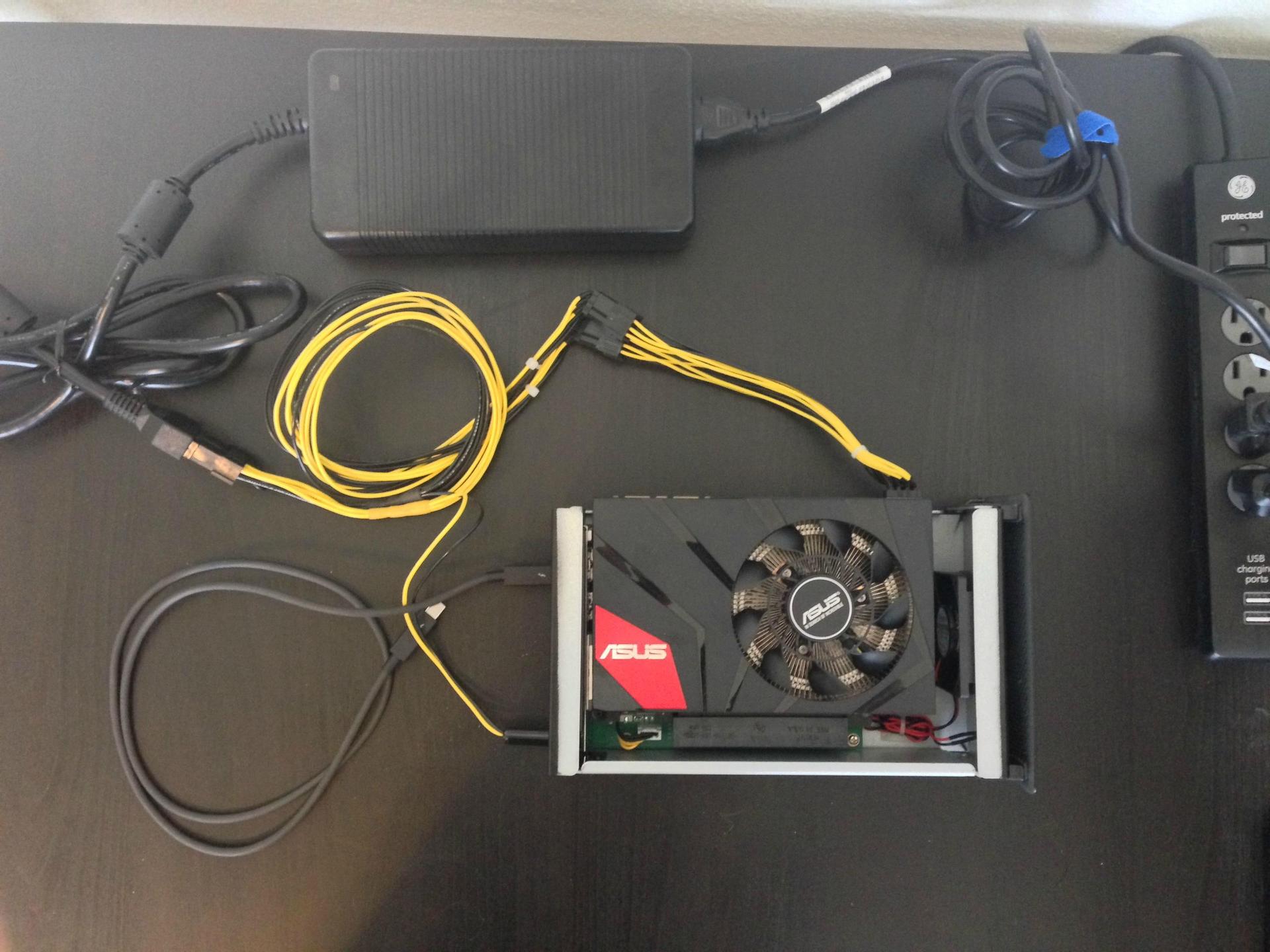

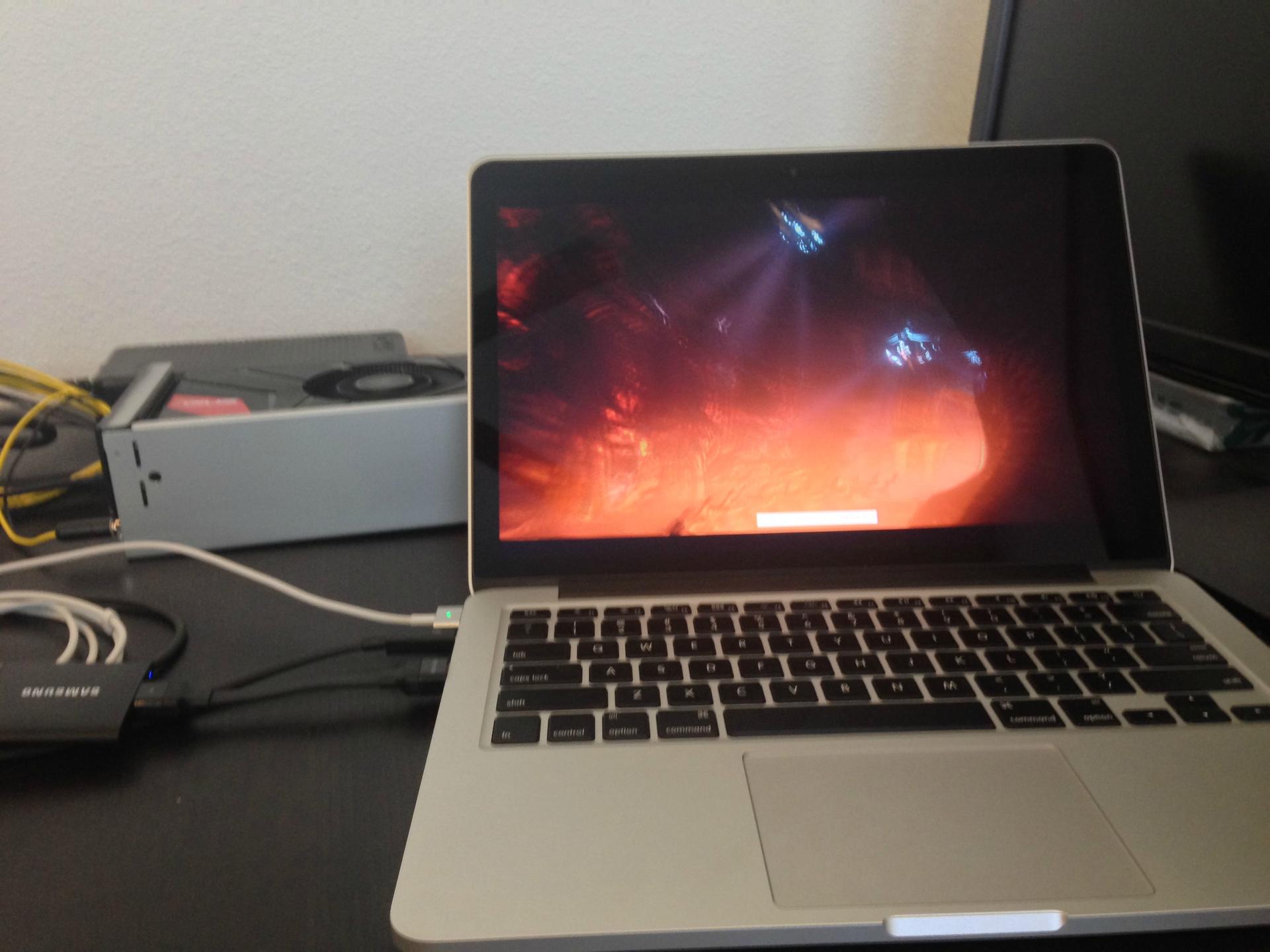

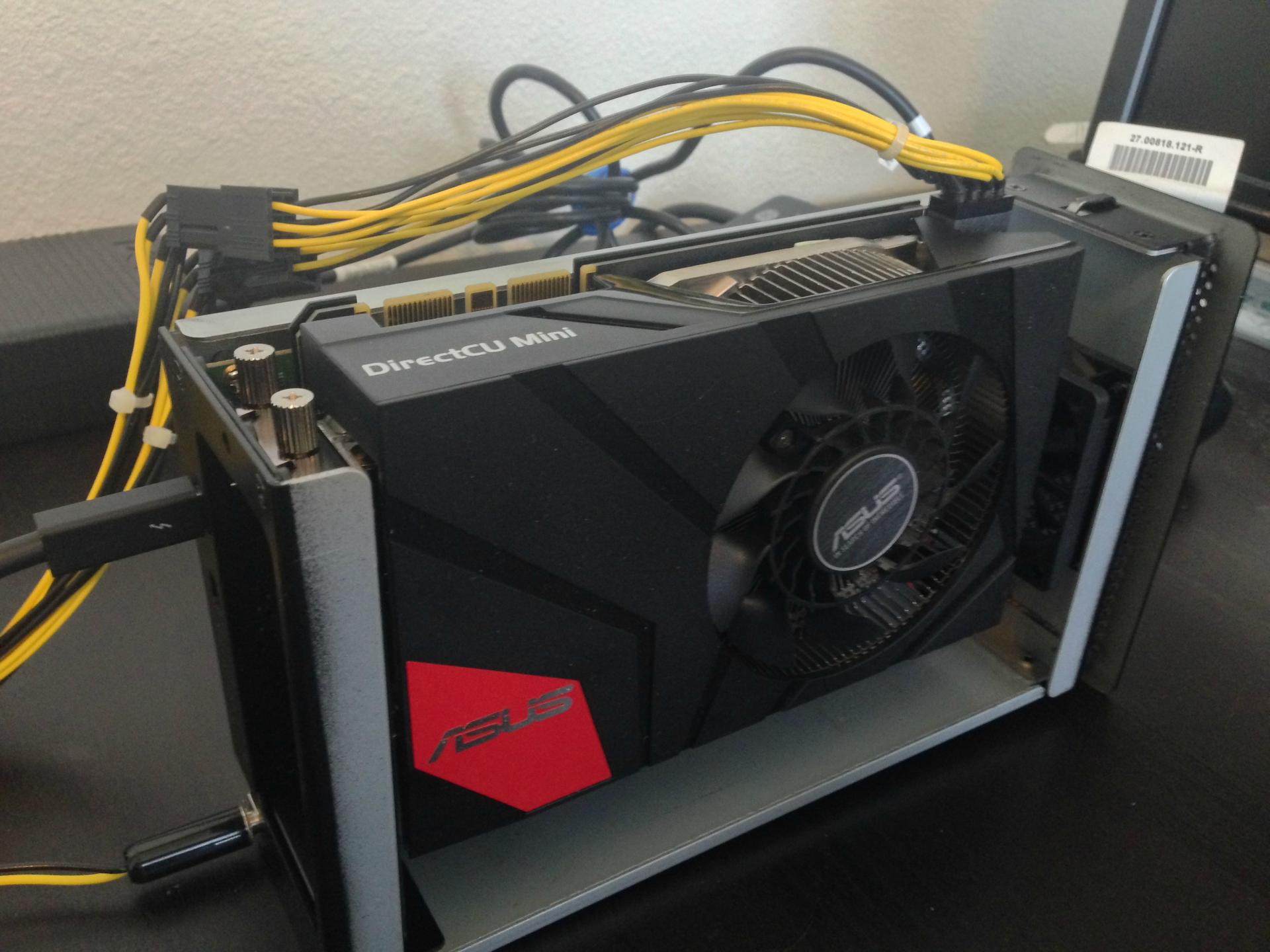

Tech Inferno Fan 20 Posted July 26, 2015 @tranj10 , thank you for posting your guide.Would you mind taking some photos of your card as it sits in the AKiTiO Thunder2 and all the cabling. You are one of the first to do what is a full neat plug'n'play implementation without needing any soldering or chassis mods. It would then be a guide of significant interest for noobs wanting a very simple hardware purchase list to put together. Quote Share this post Link to post Share on other sites
tranj10 22 Posted July 31, 2015 Sure I can take a couple pictures today, but it doesn't look that great aesthetically. 1 Quote Share this post Link to post Share on other sites
