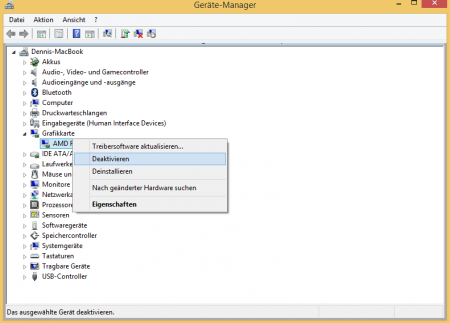

eGPUfan 10 Posted July 12, 2015 I have one stupid question why do iam not able to deactivate the m370x in the device manager manually and then install the drivers for the intel graphics? Quote Share this post Link to post Share on other sites

juniordiscart 33 Posted July 12, 2015 I have one stupid question why do iam not able to deactivate the m370x in the device manager manually and then install the drivers for the intel graphics?You can't disable the only display adapter active in your system, otherwise you only have a black screen to look at. You'll need to boot into Windows safe mode to get it fixed again. So that is not what you want to do. Besides, it wouldn't magically activate the Intel graphics all of a sudden. The reason you can't see your Intel graphics card is because the default MacBook behavior is to disable the Intel graphics on any operating system that isn't OS X. So if you want to see your Intel graphics in Windows, you need to trick the MacBook into thinking that it is loading OS X while it is actually loading Windows instead. You can do this by installing rEFInd, setting a custom EFI bootfile and loading a script in Windows.Summary of steps:- Install rEFInd: The rEFInd Boot Manager: Installing rEFInd- Set custom EFI bootfile: https://github.com/0xbb/apple_set_os.efi- Run Windows script: https://github.com/0xbb/gpu-switchFor installing the custom EFI bootfile, see the steps in the first post of this thread, where Gatsby quoted my steps to follow. Quote Share this post Link to post Share on other sites
