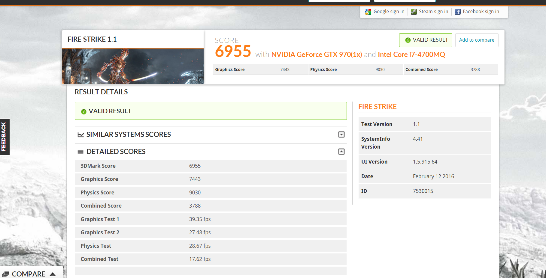

Are your fps limited to 48? because all games I've tried won't go beyond that.
Please can someone confirm that your fps aren't limited on internal screen? So I know if I'm not the only one with this problem.
PD. Specs: y510p i7 and gtx 970.
Your 3dmark06 result is showing 48fps (average). This does not mean your lcd is limited to that.
The more informative request would be for a y410 owner to provide 3dmark06 results. Then can deduce if they too are below what's expected due to x1 pcie compression not engaging for some (as yet) unknown reason.
