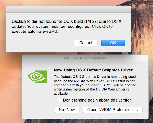

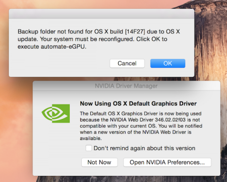

eleven Posted August 13, 2015 Share Posted August 13, 2015 Hey, I dunno if anyone can comment on this, but the other day I was prompted for was an update for the Nvidia graphics drivers (on OS X) and after updating my external monitor or GPU is no longer detected. Could I simply run the script again or would there be some dire repercussions from that? Otherwise would the -uninstall then re-run the script be better?Now that there is 0.9.5 out reinstalling OSX 10.10 is necessary; but does that mean like a complete wipe then backup restore?Thanks! Quote Link to comment Share on other sites More sharing options...
euqlaog Posted August 13, 2015 Author Share Posted August 13, 2015 Hey, I dunno if anyone can comment on this, but the other day I was prompted for was an update for the Nvidia graphics drivers (on OS X) and after updating my external monitor or GPU is no longer detected. Could I simply run the script again or would there be some dire repercussions from that? Otherwise would the -uninstall then re-run the script be better?Now that there is 0.9.5 out reinstalling OSX 10.10 is necessary; but does that mean like a complete wipe then backup restore?Thanks!Actually I have never used Nvidia's update prompt for installation. In this situation you have two options; (1) run with [-skipdriver] + restart or (2) [-uninstall] + uninstall Nvidia web driver + restart + run without parameter + restart.If you had version <= 0.9.4 earlier, reinstalling OS X without erase is ok. The future versions won't require reinstalling OS X. Parameter [-uninstall] is enough. 1 Quote Link to comment Share on other sites More sharing options...
eleven Posted August 13, 2015 Share Posted August 13, 2015 Actually I have never used Nvidia's update prompt for installation. In this situation you have two options; (1) run with [-skipdriver] + restart or (2) [-uninstall] + uninstall Nvidia web driver + restart + run without parameter + restart.If you had version <= 0.9.4 earlier, reinstalling OS X without erase is ok. The future versions won't require reinstalling OS X. Parameter [-uninstall] is enough.Alright thanks! I'll give it a try when I get home tonight and let you know how it goes. I'm assuming that it is due to the Nvidia update because I haven't updated anything else that comes to mind that should affect it. I guess I'll avoid the prompt in the future. 1 Quote Link to comment Share on other sites More sharing options...

eleven Posted August 14, 2015 Share Posted August 14, 2015 @goalque Just ran the script (version 0.9.3) using [-skipdrivers] then restart and it works again . Thanks again! 1 Quote Link to comment Share on other sites More sharing options...

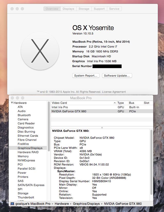

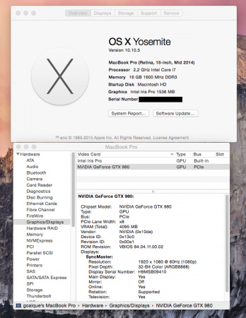

euqlaog Posted August 14, 2015 Author Share Posted August 14, 2015 Nvidia was quick with the new driver: [FONT=Menlo]goalques-Mini:Desktop goalque$ sudo ./automate-eGPU.sh[/FONT] [FONT=Menlo]Password:[/FONT] [FONT=Menlo]*** automate-eGPU.sh v0.9.5 - (c) 2015 by Goalque ***[/FONT] [FONT=Menlo]-------------------------------------------------------[/FONT] [FONT=Menlo]Detected eGPU[/FONT] [FONT=Menlo] GM204 [GeForce GTX 980][/FONT] [FONT=Menlo]Current OS X[/FONT] [FONT=Menlo] 10.10.5 14F27[/FONT] [FONT=Menlo]Previous OS X[/FONT] [FONT=Menlo] 10.10.4 14E46[/FONT] [FONT=Menlo]Latest installed Nvidia web driver[/FONT] [FONT=Menlo] Version: 346.02.02f03[/FONT] [FONT=Menlo] Source: 3rd Party[/FONT] [FONT=Menlo] Install Date: 8/14/15, 9:48 PM[/FONT] [FONT=Menlo] [/FONT] [FONT=Menlo]Checking IOPCITunnelCompatible keys...[/FONT] [FONT=Menlo] [/FONT] [FONT=Menlo]Missing IOPCITunnelCompatible keys.[/FONT] [FONT=Menlo]Mac board-id not found.[/FONT] [FONT=Menlo]Searching for matching driver...[/FONT] [FONT=Menlo] [/FONT] [FONT=Menlo]Driver [346.02.03f01] found from:[/FONT] [FONT=Menlo]http://us.download.nvidia.com/Mac/Quadro_Certified/346.02.03f01/WebDriver-346.02.03f01.pkg[/FONT] [FONT=Menlo]Do you want to download this driver (y/n)?[/FONT] [FONT=Menlo]y[/FONT] [FONT=Menlo] % Total % Received % Xferd Average Speed Time Time Time Current[/FONT] [FONT=Menlo] Dload Upload Total Spent Left Speed[/FONT] [FONT=Menlo]100 47.6M 100 47.6M 0 0 5301k 0 0:00:09 0:00:09 --:--:-- 5705k[/FONT] [FONT=Menlo]Driver downloaded.[/FONT] [FONT=Menlo]Removing validation checks...[/FONT] [FONT=Menlo]Modified package ready. Do you want to install (y/n)?[/FONT] [FONT=Menlo]y[/FONT] [FONT=Menlo]installer: Package name is NVIDIA Web Driver 346.02.03f01[/FONT] [FONT=Menlo]installer: Upgrading at base path /[/FONT] [FONT=Menlo]installer: The upgrade was successful.[/FONT] [FONT=Menlo]installer: The install requires restarting now.[/FONT] [FONT=Menlo]Checking IOPCITunnelCompatible keys...[/FONT] [FONT=Menlo] [/FONT] [FONT=Menlo]Missing IOPCITunnelCompatible keys.[/FONT] [FONT=Menlo]IOPCITunnelCompatible mods done.[/FONT] [FONT=Menlo]Board-id added.[/FONT] [FONT=Menlo]All ready. Please restart the Mac.[/FONT] [FONT=Menlo]goalques-Mini:Desktop goalque$[/FONT] Quote Link to comment Share on other sites More sharing options...

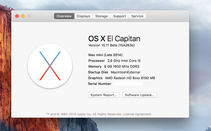

danielbrown941 Posted August 25, 2015 Share Posted August 25, 2015 QuoteThanks for the link. The script already works with OS X 10.11 Developer builds. For installing the web driver for OS X 10.11, just disable SIP and use -url option.NVIDIA Releases Alternate Graphics Drivers for OS X 10.11 Beta (346.03.01)AMDs won’t need any option. Drivers are built-in.Hey goalque, just had a quick play with this and found that the script doesn't seem to run on my version of El Capitan (15A262e). I had some problems disabling SIP, but eventually managed it by booting into the recovery OS, launching terminal and running "csrutil disable".Your script was still telling me SIP was enabled, but I knew it wasn't so had a quick look into the shell script. It seems the command you used to determine if SIP was enabled has changed output. Mine is:Daniels-MacBook-Pro: Desktop Dan$ nvram csr-active-config csr-active-config w%00%00%00The scrip checks for g%00%00%00, whereas my build requires w%00%00%00. I'll look to submit a pull request to github sometime tomorrow unless you get to it before me.All working great now :) 2 Quote Link to comment Share on other sites More sharing options...
euqlaog Posted August 25, 2015 Author Share Posted August 25, 2015 @danielbrown941:The way how the SIP works is continuously changing between builds. Keep an eye on Pike’s blog:https://pikeralpha.wordpress.com/2015/08/19/csrutil-updated/Mine is with “g”. I haven’t had time to play with OS X 10.11 for a while. It’s on my external SSD. Version 0.9.6 will be out as soon as I get feedback from beta testers. No big changes, bug fixes for the most part. I will check if I have the same “w” prefix with the build 15A262e/15A263e. Thanks for your observation!EDIT: Version 0.9.6 is now sent to beta testers. Confirmed that worked with AMD & Nvidia on OS X 10.11 Developer Beta (15A263e). I used a command "csrutil enable --without fs" (gives "w" prefix). Quote Link to comment Share on other sites More sharing options...
