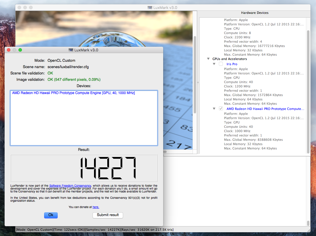

Odysseus Posted July 24, 2015 Share Posted July 24, 2015 There is no kext modification undo parameter, unfortunately. The script should back up the kexts, but that's in todo list as well as AMD support Keep in mind that AKiTiO is not stable with the R9 200 series cards. I don't know yet how to implement this. Should it be a new parameter, Nvidia/AMD detection, or a completely new script. Too early to say about R9 300 series stability, but looks much more promising. The OpenCL performance amazed me in OS X, and 3DMark11 on Windows side, R9 390 was faster than a reference GTX 980: http://forum.techinferno.com/diy-e-gpu-projects/7910-diy-egpu-macbook-experiences-127.html#post140552 Thanks goalque. I'll try to walk the script backwards and undo the changes manually. I'm actually not using the Akitio. I bought an OSS Cube2 (Desktop PCIe Enclosures | One Stop Systems). It could be that the issue is with the Cube2, but I hope not. The Cube2 has it's own power supply, and it's supposed to have enough power to power any GPU (it came with the GPU power cables also). Once I get the nvidia drivers removed, I'll try to find Radeon installation instructions. Hopefully it all works! Quote Link to comment Share on other sites More sharing options...
