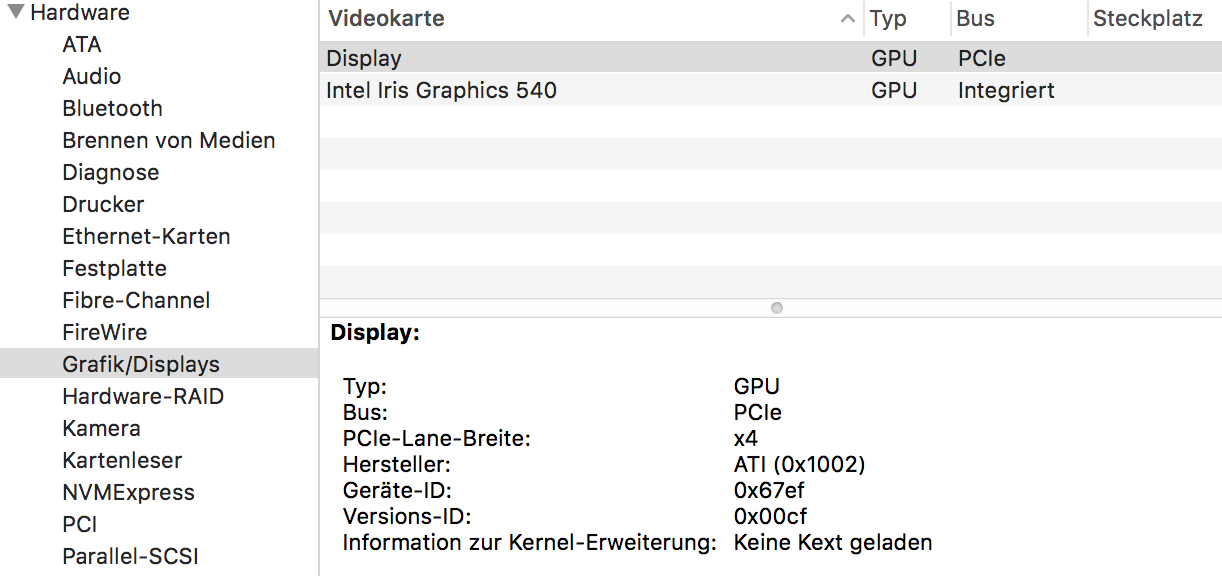

Hi, I am noob regarding all this EGPU stuff and I encountered a problem running macOS 10.12.4 Beta (16E163f), where I tried to get my Akitio Thunder3 (with beefed up DC supply) and MSI V809-2210R RX 460 4 GB running.
The Thunder3 is working and reported in the system report.
When running the script, I get the following output:
***      automate-eGPU.sh v1.0.0      ***
* (c) 2016, 2017 by Goalque & FricoRico *
Detected eGPU
 Baffin [Radeon RX 460]
Current OS X
 10.12.4 16E163f
Previous OS X
 10.12.2 16C67
Latest installed Nvidia web driver
 [not found]
Checking IOPCITunnelCompatible keys...
File Doesn't Exist, Will Create: /System/Library/Extensions/AMD9500Controller.kext/Contents/Info.plist
Print: Entry, ":IOKitPersonalities:Controller:IOPCIMatch", Does Not Exist
Parse Error: Unclosed Quotes
Value Required for Set Command
SetIOPCIMatch() appended device ID 0x67ef1002 in /System/Library/Extensions/AMD9500Controller.kext/Contents/Info.plist
IOPCITunnelCompatible mods done.
Rebuilding caches...
All ready. Please restart the Mac.
The card is visible in the system report, with the note "no kext loaded" ("Keine Kext geladen"). In the Extensions folder no AMD9500Controller.kext can be found. But there is a AMD9510Controller.kext, which does include the 0x67ed1002 id.
Can you help me?
