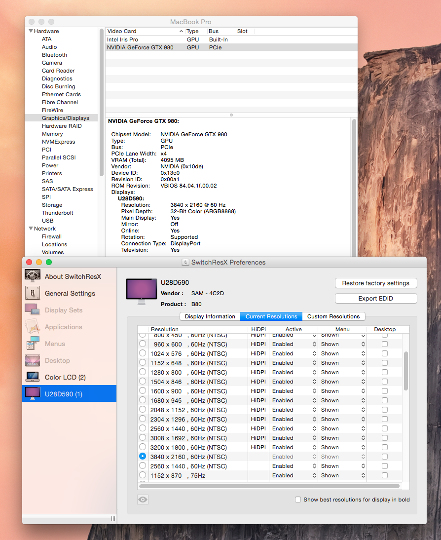

Mark Posted June 20, 2015 Share Posted June 20, 2015 Update on my situation: I placed my Titan back inside my Akitio (the previously working 4k60 setup) and I still have 4k30 instead of 4k60. I tried plugging it in at the Apple logo as well as my old way of doing it (i.e. plugging it in before switching on my laptop). No luck, MST is still not working despite being enabled in the monitor. Quote Link to comment Share on other sites More sharing options...
euqlaog Posted June 20, 2015 Author Share Posted June 20, 2015 Update on my situation: I placed my Titan back inside my Akitio (the previously working 4k60 setup) and I still have 4k30 instead of 4k60. I tried plugging it in at the Apple logo as well as my old way of doing it (i.e. plugging it in before switching on my laptop). No luck, MST is still not working despite being enabled in the monitor. I am typing this on my U28D590 monitor (DP 1.2), 3840x2160@60Hz AKiTiO + GTX 980 + 2014 15” rMBP Iris Pro on OS X 10.10.3 This site gives some useful information: https://support.apple.com/en-us/HT202856 If you will find out a way by googling 4K & MST, let me know! Quote Link to comment Share on other sites More sharing options...
Mark Posted June 20, 2015 Share Posted June 20, 2015 Nope, still no luck.However, I have noticed that the difference between your script and how I used to set up my eGPU was that I did not do anything about the AppleGraphicDevicePolicy kext. I modified your script so it doesn't do anything with that under 10.10.3 and it went back to kernel panics on both the Akitio and III-D. However, in the one occasion it did successfully boot, I had 4k60 back!So what I did was try to do the same for 10.10.1, however, the it won't enable the external display at all when I plug in the eGPU at the Apple logo, and when I try to detect displays with the Display Menu app, it causes a kernel panic.So, for now, I'm stuck with 10.10.3, using a 4k monitor in 1080p. Quote Link to comment Share on other sites More sharing options...
euqlaog Posted June 21, 2015 Author Share Posted June 21, 2015 Nope, still no luck.However, I have noticed that the difference between your script and how I used to set up my eGPU was that I did not do anything about the AppleGraphicDevicePolicy kext. I modified your script so it doesn't do anything with that under 10.10.3 and it went back to kernel panics on both the Akitio and III-D. However, in the one occasion it did successfully boot, I had 4k60 back!So what I did was try to do the same for 10.10.1, however, the it won't enable the external display at all when I plug in the eGPU at the Apple logo, and when I try to detect displays with the Display Menu app, it causes a kernel panic.So, for now, I'm stuck with 10.10.3, using a 4k monitor in 1080p.Your board-id Mac-2BD1B31983FE1663 doesn't exist in ConfigMap as default, but the script adds it there with “none” value enabling the screen output. AppleMuxController takes care of GPU switching, but the 60Hz issue may be more related to the monitor itself as Sgt. Pepper had the same problem with a iGPU only Mac (late 2013 13” rMBP), and the same monitor:http://forum.techinferno.com/diy-e-gpu-projects/7910-diy-egpu-macbook-experiences-30.html#post120921It’s one of the Mac models which doesn’t require AppleGraphicsDevicePolicy.kext change as the board-id is there ready.The strange thing is, i was able to test this setup today with a 2011 MacbookAir and it worked exactly as it should, eGPU is detected, and works properly, giving me 4k@60hz AND resolutions up to 3200x1800 HiDPI.If we could track down the 2011 MacbookAir’s ioreg tree and compare it with the late 2013 13” rMBP + the same monitor, that likely gives us the correct direction. Quote Link to comment Share on other sites More sharing options...

euqlaog Posted June 24, 2015 Author Share Posted June 24, 2015 I got confirmation that additional command here enable nMP's eGPU screen output. The bug fix will be included in the next version.1) Booting with nothing plugged in nMP's HDMI interface and wait for a while even if monitor stays black, the external GPU has screen output via DVI interface. The result is the same for all the six Thunderbolt ports on nMP.2) When the monitor is connected to the nMP's HDMI interface and eGPU connected to one of the TB ports, after booting, both monitors will be detected.SimonSays told me to test this soon as well.Furthermore, I had progress in detecting multiple eGPUs with the 2014 Mac mini. It won't freeze at booting stage anymore. I am also examining the ACPI specification and ways to programmatically emulate physical delay that is required with a 750M equipped 15" rMBP + multi-slot enclosure + Maxwell card. 4 Quote Link to comment Share on other sites More sharing options...

euqlaog Posted June 28, 2015 Author Share Posted June 28, 2015 I should change the title of this thread, since the just released version 0.9.2 is targeting at fully plug-and-play eGPU system on OS X.Now there is a parameter [-a] which launches two background processes, the other “automate-egpu-daemon” takes care of the following:1) If you have a multi-slot enclosure (such as NA211TB, III-D, SE II) and you are using a Maxwell card with a dGPU equipped MBP (750M), the freezing issue at booting stage is completely eliminated. You can press option key to have boot screen without freezing or boot straight into the OS X. I discovered this by comparing 2014/2011 Mac mini’s differences. Big thanks to @Simurgh5 for testing my theory. 2) It’s likely that you can now run more than one Nvidia Kepler eGPUs externally out of the box with any TB2 Mac, without manual delay.3) If you accidentally disabled the web driver, “automate-egpu-daemon” forces developer mode and web driver on each boot.The other process, “automate-egpu-agent” detects in real-time if NVDAStartup.kext is changed. If you edit it or reinstall the web driver via Nvidia’s own UI, you will get a pop-up window that says:“Nvidia driver change detected. In order to use eGPU, your system must be reconfigured. Click OK to execute automate-eGPU”.- fixed nMP screen output bug- quick regexp change to support pre-release seeds (not tested)- [-skipdriver] parameter, which does what is says - executes only kext mods- [-m] parameter, switches back to manual modeThe old manual mode, running the script without parameters is possible. And that must be the first terminal command, required before running with [-a].Please note that these new features may include bugs and [-a] mode is currently experimental. A Time Machine backup is recommended. The script is under the MIT license, so you can do almost anything with it. 5 Quote Link to comment Share on other sites More sharing options...

euqlaog Posted June 29, 2015 Author Share Posted June 29, 2015 @goalque:Great work! I gratefully confirm that the automatic mode is running smoothly for several hours now and that it does what it should: The Webdriver is enabled when disabled and the rMBP can be booted with the eGPU connected. This is more than I'd ever have expected when I started my eGPU project. I have one (hopefully) small request for the next version: Could you make the Webdriver re-enabling optional? [For whatever reason, I am experiencing much lower battery life with the Webdriver enabled. I've always had this before so this is not due to the script.] Or if you think this feature might be confusing for other users: could you tell me what I'd have to change in the script? I am familiar with programming in general but not very much in the shell – so I'm afraid to change anything in your beautiful script without knowing all dependencies within it. Thanks! The script forces to use the web driver, since the OS X default driver doesn’t work with Maxwell architecture cards. Comment the line number 408. Background service unloading with [-m] parameter doesn’t work well yet, since they are started with different privileges. If you want to get rid of them, delete plist files: sudo rm /Library/LaunchDaemons/automate-eGPU-daemon.plistsudo rm /Library/LaunchAgents/automate-eGPU-agent.plist 1 Quote Link to comment Share on other sites More sharing options...
Mark Posted June 29, 2015 Share Posted June 29, 2015 Thank you @goalque for the driver update! I can now boot straight into OS X (10.10.3) on my Titan X + III-D + 2013 750m when plugged in to the eGPU! However, I am still having problems with 4k30 instead of 4k60.I also tried booting into Windows 8.1 using this method. The eGPU isn't detected at all. I've installed the latest NVIDIA drivers both when unplugged and then when plugged. Also, after booting out of Windows, I cannot get back in to OS X when I switch on the computer (i.e. black screen freeze again), I solved this problem by booting into OS X without the eGPU plugged and running the script with the [-a] parameter.Thank you and keep up the good work! I am willing to help you sort out this 4k issue as well! Quote Link to comment Share on other sites More sharing options...
